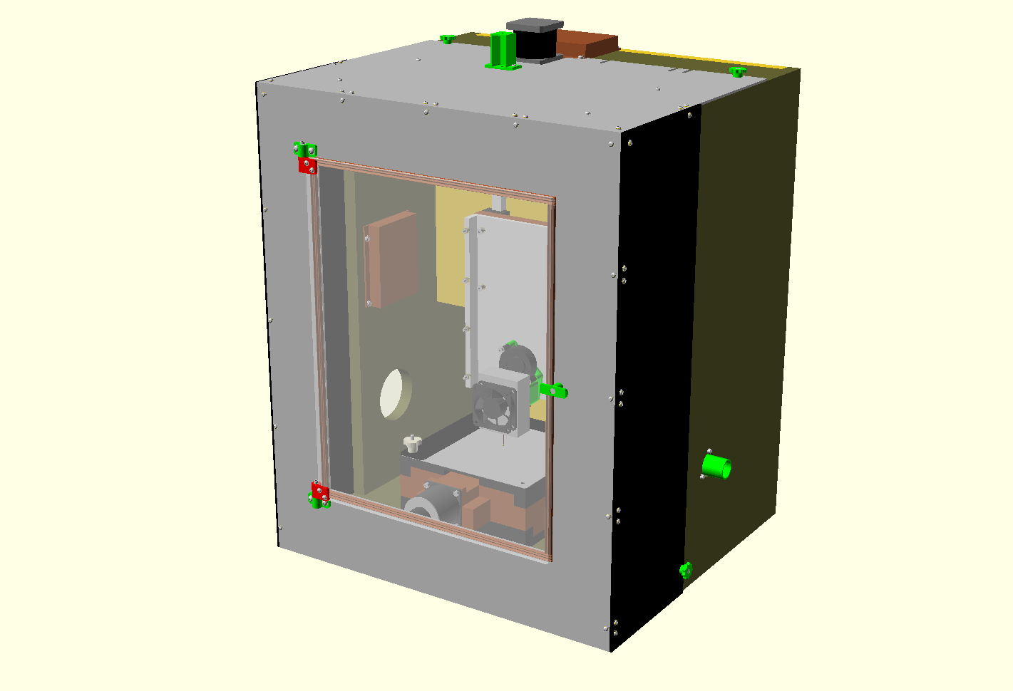

Wed, Nov 8, 2017 6:17 PM
This seems to be a common request but it isn't needed the way I use
OpenSCAD.
That way, when you use the hinge (which might reside in an included file),
you don't need to know exaclty where the screw holes are, you just need the
name of the attachment nodes.
I do exactly what you want using modules. Here is a hanged door where the
hinge code lives in another file.
module door() {
render_sheet(PMMA6) difference() {
sheet(PMMA6, door_width, door_height, 3);
    for(z =[-1, 1])
        translate([-door_width / 2, z * door_height / 2])
            door_hinge_hole_positions(z)
                drill(screw_pilot_hole(door_hinge_screw()));
module door_assembly() {
for(z =[-1, 1])
translate([-door_width / 2, -depth / 2 - sheet_thickness(DiBond),
door_z + z * door_height / 2])
door_hinge_assembly(z > 0, sheet_thickness(DiBond));
translate([0, -depth / 2 - sheet_thickness(DiBond) +
door_hinge_pin_y(), door_z])
rotate([90, 0, 0])
door();
door_hinge_hole_positions(z) is a module that positions its children at the
hinge hole positions. It looks like this
module door_hinge_hole_positions(dir = 0) {
hole_pitch = width - 10;
for(side = [-1, 1])
    translate([width / 2 + side * hole_pitch / 2, -dir * width / 2
-side * hole_pitch / 2])
It is defined in the hinge file and used to drill the holes in the printed
plastic hinges and place the screws. It is used in the file that makes the
door to drill the holes in the Acrylic part. There is no need for named
connection points. I just use a module to represent them.
So it meets your objective by allowing the screw positions to be
represented with a name and referenced from another module.
All my connectivity between parts is handled like this.

Thu, Nov 9, 2017 9:33 AM
Yes I project the door to 2D and export it as a DXF and can use my CNC
router to drill the holes. If I ever receive the Glowforge I ordered two
years ago I will be able to laser cut them. That actual door was made many
years ago by hand for another machine. I modelled it retrospectively and
transplanted it onto HydraRaptor.
