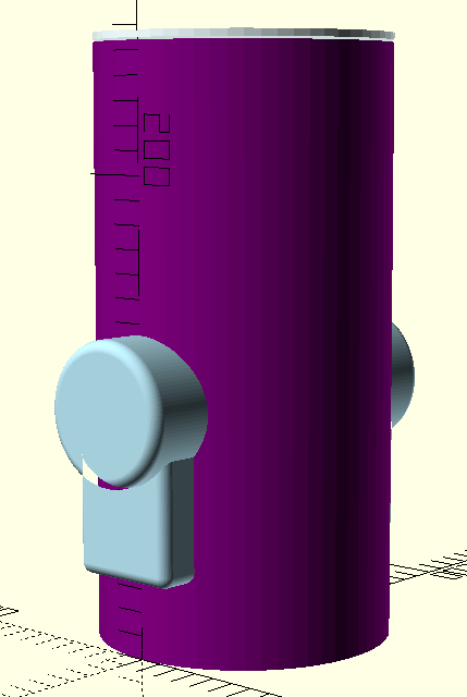

Hello André Lefranc,
I'm not an expert, but run your scad file on OpenSCAD version
2021.10.13, linux Manjaro.
  1. I corrected the line breaks inserted by email. Not nice but known.
    And I replaced all TABs which were replaced by wrong characters.
  2. two modules are missing:
WARNING: Ignoring unknown module 'ContreAlesage' in file , lines <some>
WARNING: Ignoring unknown module 'alesage' in file , line <some>
They can't be simply commented out because then two difference() statements becomes empty.
  1. I got the attached preview (F5). [If attachments are allowed :) ]
    There are some transparent areas shown, dependent on the view. So here
    are more investigations to do.
  2. even with the missing modules the design could be rendered:
Saved backup file: /home/peter/snap/openscad-nightly/2875/.local/share/OpenSCAD/backups/unsaved-backup-MGiltEaq.scad
WARNING: Ignoring unknown module 'ContreAlesage' in file , line 73
WARNING: Ignoring unknown module 'alesage' in file , line 74
WARNING: Ignoring unknown module 'alesage' in file , line 94
Geometries in cache: 20
Geometry cache size in bytes: 7614728
CGAL Polyhedrons in cache: 4
CGAL cache size in bytes: 104423488
Total rendering time: 0:00:00.095
Simple:        no
Vertices:    23670
Halfedges:  120604
Edges:      60302
Halffacets:  73276
Facets:      36638
Volumes:        5
WARNING: Object may not be a valid 2-manifold and may need repair! <<<<<
Rendering finished.
The warning may be grounded on the small distance between tube and
circle plate on top (the front glass of the telescope?) or because one
or more mesh faces are designed in the wrong direction (out-side-in).
More investigations on this item makes only sense with all modules at
hand.
The union() are mostly not necessary because an implicit union is
implemented in openSCAD.
I hope this message will push you in the right direction.
Peter
