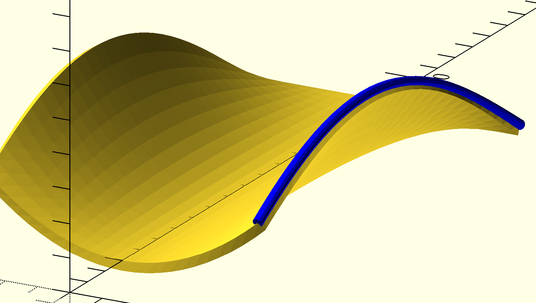

Your shape has a constant thickness of 3, but when you do the intersection,
you make vertical edges of varying thickness depending on the angle to the
XY plane, so much more difficult.  Working directly with the vnf_polyhedron
output, you can get there with a bit of work:
This code follows exactly the top right edge of your non-intersected
vnf_polyhedron.
pathr=[for(x=[30:5:180]) [42, x, sin(x)*36]];
color("blue") path_sweep(circle(d=3, $fn=12), pathr);
You need to use sweep() instead of path_sweep() because mask2d_roundover()
has to twist as you go along.  See the documentation for sweep() and
another example here:https://github.com/BelfrySCAD/BOSL2/issues/2025.  The
bottom edges are more difficult but do-able.  Something like:
pathr2 = [for(x=[30:5:180]) [42 + 3cos(90-x), x, 36sin(x) - 3*sin(90-x)]]
<-- almost certainly wrong, but the general idea.
Dan

I expect you could use the function
region = projection(vnf, [cut], [z]);
to generate 2d profiles for each side where your sheet intersects your
cube.  Somewhat awkward as you will have to rotate the vertices of the
sheet to align a side with the XY plane to make the projection cut.  Then
you can intersect the 2d region to a rectangle matching your cube at the
same rotation projected to the XY plane.  And then perhaps use path_sweep
on the clipped region to make a chamfered or rounded cap for the side of
the cropped sheet.
