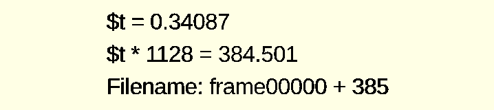

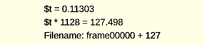

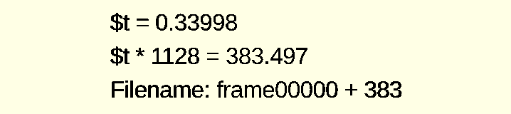

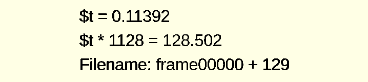

I have been having trouble using the animate feature in OpenSCAD to dump
picture files. It largely numbers the output files consecutively, however
there is the occasional gap, e.g. it will jump from "frame00127.png" to
"frame00129.png" missing out "frame00128.png".  The behaviour appears in
part to depend on what step value is used but is not consistent...!?If you
animate the following, on my system it generally leaves out frame00128, 384,
640 & 896.Complete steps in this order:1) Select Animate2) Set Steps to
11283) Set FPS to 204) Select Dump Pictures5) Wait for a complete cycle and
check outputcolor("black") text(str("$t = ",$t));translate([0,-20,0])
color("black") text(str("$t * 1128 = ",$t1128));translate([0,-40,0])
color("black")    text(str("Filename: frame00000 + ",round($t
1128)));Can
anyone confirm this behaviour or am I doing something wrong?Thanks.

My theory is that "frame00128.png" is missing because either "frame00127.png"
or "frame00129.png" are used twice.
After looking at the source code, I guess this a fixable bug in OpenSCAD,
which is caused by the imprecise way that $t is computed and referenced at
each iteration. $t is represented internally as a 6 digit decimal character
string; it is incremented like this:
                    double s = this->e_fsteps->text().toDouble();
                    double t = this->e_tval->text().toDouble() + 1/s;
                    QString txt;
                    txt.sprintf("%.5f", t >= 1.0 ? 0.0 : t);
                    this->e_tval->setText(txt);
and referenced like this:
    this->top_ctx.set_variable("$t",
ValuePtr(this->e_tval->text().toDouble()));
and
            QString filename;
            double t = this->e_tval->text().toDouble();
            filename.sprintf("frame%05d.png", int(round(s*t)));
            img.save(filename, "PNG");
There is a lot of roundoff error occurring at each step, due to this code.
I think the problem would go away if the iteration count were stored
internally as an integer, and if $t were computed at each step as
iteration_count/fsteps.
Doug.

The following program provides a detailed analysis of what actually happens
during animate at different Steps values, certainly not exciting but perhaps
useful:
echo("Cumulative shift:");
echo("+ve>0.5 gaps in frame numbering, -ve<-0.5 frames overwritten");
for(steps=[994:1007]){
dt=1/steps;
dt_5dp=round(dt100000)/100000;//round to 5 decimal places
frames_saved=ceil(1/dt_5dp);
dt_error=dt_5dp-dt;
cuml_error_time=dt_error
(frames_saved-1);
cuml_error_frames=cuml_error_time/dt;
echo(str("Steps:",steps,", Cumulative shift:",cuml_error_frames,
" [frames], frames saved:",frames_saved));
Output:
ECHO: "Cumulative shift:"
ECHO: "+ve>0.5 gaps in frame numbering, -ve<-0.5 frames overwritten"
ECHO: "Steps:994, Cumulative shift:3.9006 [frames], frames saved:991"
ECHO: "Steps:995, Cumulative shift:4.9005 [frames], frames saved:991"
ECHO: "Steps:996, Cumulative shift:-3.996 [frames], frames saved:1000"
ECHO: "Steps:997, Cumulative shift:-2.997 [frames], frames saved:1000"
ECHO: "Steps:998, Cumulative shift:-1.998 [frames], frames saved:1000"
ECHO: "Steps:999, Cumulative shift:-0.999 [frames], frames saved:1000"
ECHO: "Steps:1000, Cumulative shift:0 [frames], frames saved:1000"
ECHO: "Steps:1001, Cumulative shift:0.999 [frames], frames saved:1000"
ECHO: "Steps:1002, Cumulative shift:1.998 [frames], frames saved:1000"
ECHO: "Steps:1003, Cumulative shift:2.997 [frames], frames saved:1000"
ECHO: "Steps:1004, Cumulative shift:3.996 [frames], frames saved:1000"
ECHO: "Steps:1005, Cumulative shift:4.995 [frames], frames saved:1000"
ECHO: "Steps:1006, Cumulative shift:-4.1006 [frames], frames saved:1011"
ECHO: "Steps:1007, Cumulative shift:-3.1007 [frames], frames saved:1011"
Taking two Steps values as examples:
  1. Steps=996, expected output 996 frames.
1000 frames are saved, but because of the cumulative time shift of -4
frames, 4 of these frames are overwritten by subsequent frames with the same
name. There are no obvious gaps in the output, but 4 frame files are in fact
missing.
The required time increment per step is 1/996=0.001004... but this is
effectively rounded to 5dp so it becomes 0.00100, which is smaller than the
required time increment. When step 126 is reached,
$t=0+(126-1)0.00100=0.125 so the file name is 0.125996=124.5 which becomes
"frame00125". However at the next step, 127, $t=0+(127-1)0.00100=0.126 so
the file name is 0.126
996=125.496 which becomes "frame00125" again,
overwritting the previous frame.
2)Steps=1005, expected output 1005 frames.
1000 frames are saved, but because of the cumulative time shift of +5
frames, there are 5 gaps in the sequence of file names generated.  These are
obvious on inspection of the output.
The required time increment per step is 1/1005=0.000995... but this is
effectively rounded to 5dp so it becomes 0.00100, which is largerer than the
required time increment. When step 100 is reached,
$t=0+(100-1)0.00100=0.099 so the file name is 0.0991005=99.495 which
becomes "frame00099". However at the next step, 101,
$t=0+(101-1)0.00100=0.1 so the file name is 0.11005=100.5 which becomes
"frame00101", so file name "frame00100" is skipped.
Wake up! ;-)
I believe, as Doug suggested, that the current step should be held as an
integer and $t calculated from this as step/steps, incrementing from 0/steps
to (steps-1)/steps.
Cheers, Trygon
