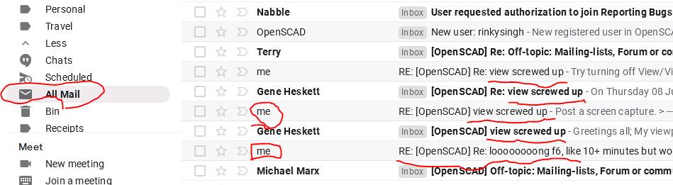

Gmail does it's own thing, it is not a plain-old-email-forwarder. Try Gmail's All-mail***.
One more time, Gmail DOES NOT SEND YOU YOUR OWN POSTS to Mailing-lists.
They will never be in your inbox.
Those 'me' are my sent emails. Or
I've just had a look at gmail settings, maybe you want:
I've not used it before, it may have other effects.
Michael

If I start a new thread it will just be in my sent folder but when there are replies it
becomes a single thread in my inbox. I don't think it comes from the mailing list.
Gmail does https://support.google.com/mail/answer/6588?hl=en  it's own thing, it is not a
plain-old-email-forwarder. Try Gmail's All-mail.

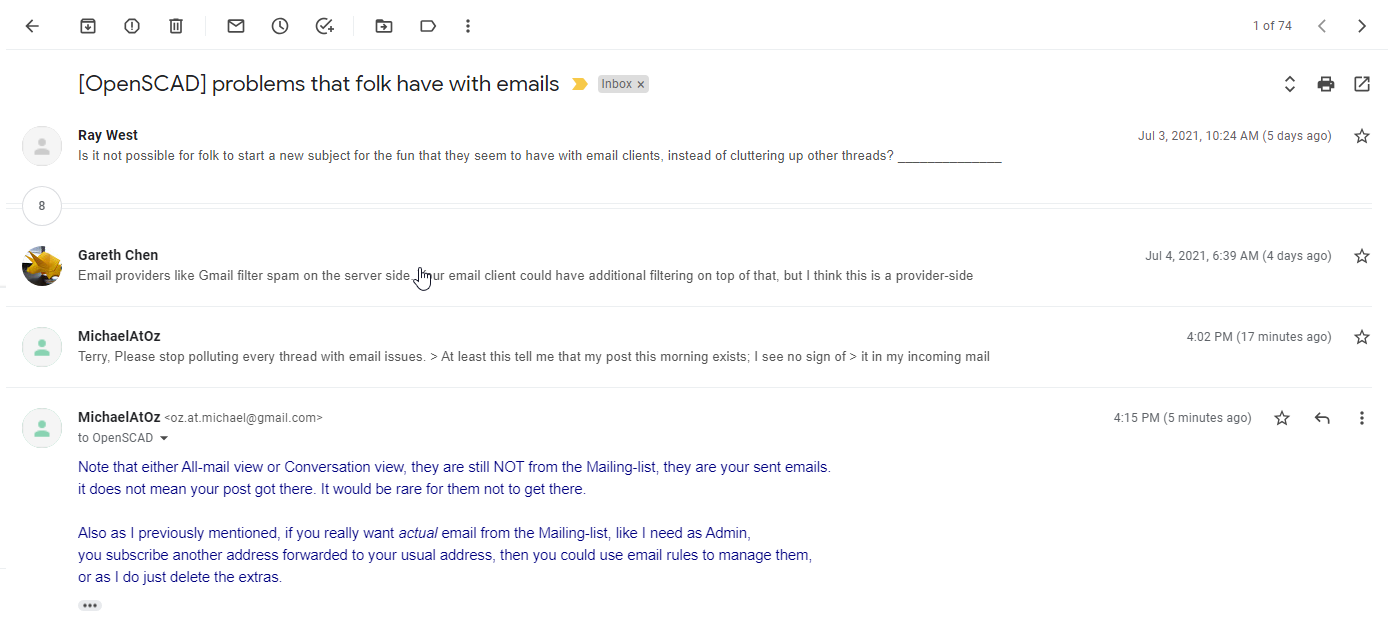

Note that either All-mail view or Conversation view, they are still NOT from the Mailing-list, they
are your sent emails.
it does not mean your post got there. It would be rare for them not to get there.
Also as I previously mentioned, if you really want actual email from the Mailing-list, like I need
as Admin,
you subscribe another address forwarded to your usual address, then you could use email rules to
manage them,
or as I do just delete the extras.
