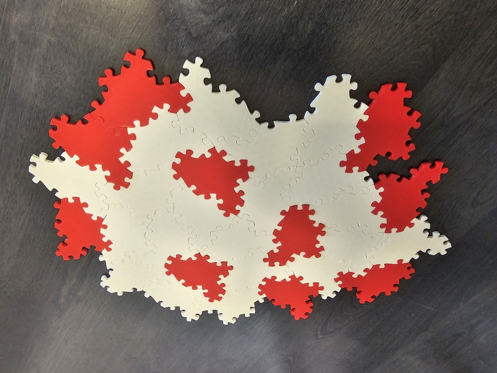

I recently added my take to Thingiverse and thought it looks pretty
elegant in OpenSCAD:
https://www.thingiverse.com/thing:6185730
Here's a silly obfuscated version just for fun:
// Spectre Aperiodic Monotile Jigsaw - by Curt McDowell
maker@fishlet.com 2023-07-05
b=function(q,t)len(q)<2?q[0]:b([for(i=[0:len(q)-2])q[i]],t)*(1-t)+b([for(i=[1:len(q)-1])q[i]],t)t;S=function(V=0,d=90,D=[[0,0]])let(c=[[0,0],[1.2,-.3],[-.7,.6],[.5,.2],[1.7,.6],[-.2,-.3],[1,0]],C=D[len(D)-1],Q=C+15[cos(d),sin(d)],n=concat(D,[for(p=V%2?[for(t=[1:120])let(p=b(c,1-t/120))[1-p.x,-p.y]]:[for(t=[1:120])b(c,t/120)])[(Q.x-C.x)*p.x+(C.y-Q.y)*p.y+C.x,(Q.y-C.y)*p.x+(Q.x-C.x)p.y+C.y]]))V==13?n:S(V+1,d+30[2,-3,-2,3,-2,-3,-2,3,-2,0,-2,-3,2,-3][V],n);linear_extrude(4)offset(-.2)polygon(S());
Regards,
Curt

Your printed version looks very impressive.  I'm surprised, given how
printing tends to create a bit of a rough edge, at how well those pieces
fit together.
