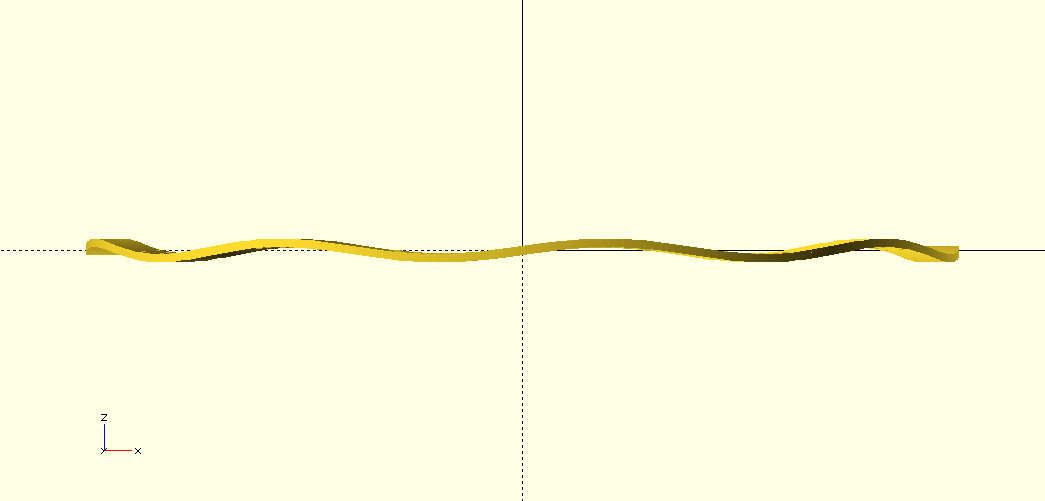

That’s cool, but the code is a little hard to follow in the video.
I did this for a drawing. It’s the half of the washer that is visible. When it’s almost fully compressed, as it would be when installed, the steps don’t show!
h=1; // half height (c to c)
w=4; // width
for (i=[0:180])
rotate([0, h*sin(8*i), i])
translate([-50, 0])
ccube(w, 1, 1);
That’s cool, but the code is a little hard to follow in the video. I did this for a drawing. It’s the half of the washer that is visible. When it’s almost fully compressed, as it would be when installed, the steps don’t show! `h=1; // half height (c to c)` `w=4; // width` `for (i=[0:180])` `rotate([0, h*sin(8*i), i])` `translate([-50, 0])` `ccube(w, 1, 1);`

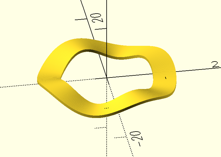

Wed, Feb 19, 2025 1:47 AM
Basic idea here is to draw a sinewave in x-z plane and draw a circular path
to wrap the sinewave in x-y plane.
The function which i wrote in python for such wrapping is
"extrude_wave2path".
Number of points in sinewave should match number of points of circular path.
This weapped sinewave will make a path and then extrude a rectangular
section through this path to create a wave washer.
