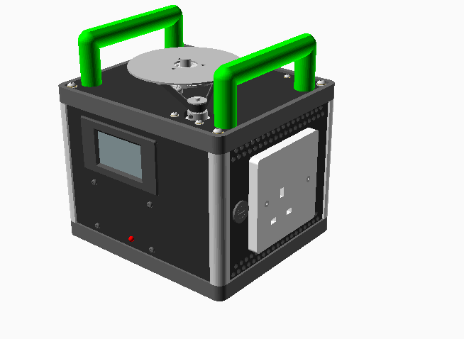

I remember it being about 12 seconds, which wasn't too bad but now it is a
minute.
It is by far the biggest project I have done in OpenSCAD, and is broken up
into 21 files, not including the library. In contrast most of other
projects are just a single file or two or three and will do that part of
the compilation in less than a second. For example something like this uses
the same library and will do F5 with no changes in 1 second.
It only takes 53 seconds to draw the whole thing when first loaded. My
large project only takes 4 minutes to render from scratch, so whereas the
small project has a 53:1 difference between the first F5 and a second one.
The large project only has a 4:1 difference.
It is hard to see where the time is taken, it seems to be fairly slow all
over just due to splitting it into multiple files. I think the main problem
is a small file of global constants that gets included everywhere. Putting
an echo function in that file shows the constants are instantiated about
1/4 million times! In the smaller project it is instantiated 4700 times.
Still huge but it seems to explode when you have more files.
This is because whenever you call a module or function in a different file
it instantiates all the constants. Is this really necessary or can it be
fixed? I think it would make a huge difference to a project like this.

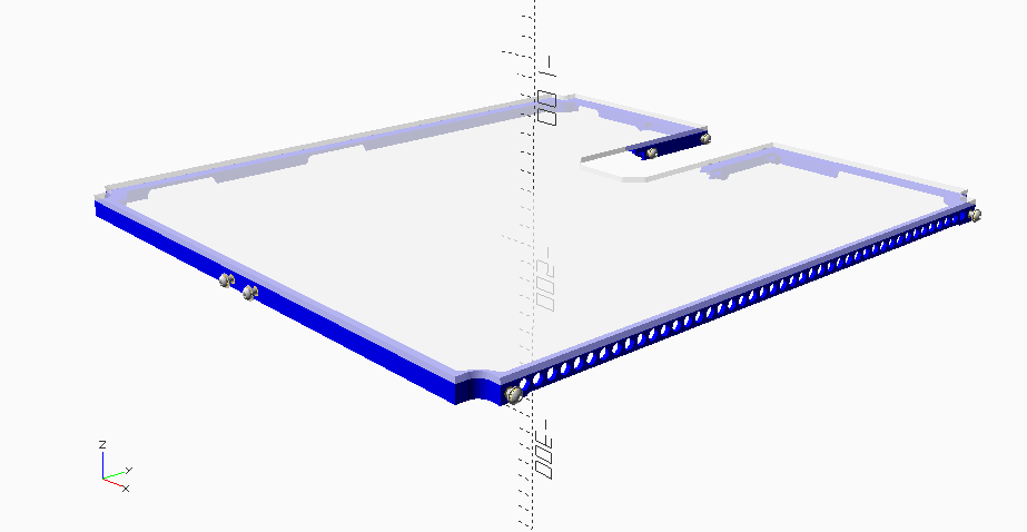

Sun, Jun 14, 2020 11:11 PM
Yes this has really become a problem for me. I have a list of
transformations that position screws in a shelf bracket that is reasonably
complex to calculate and since it generates the bracket and also positions
inserts and screws into it plus it needs to drill holes in 6 panels that it
mates with I need to reference it many times.
function shelf_screw_positions() = [
translate([z_axis_x + spine_width() / 2, box_depth / 2 - spine_depth()
  • spine_clearance + shelf_boss_r + eps])              * rotate([-90, 0,
    90]),
    translate([z_axis_x + spine_width() / 2, box_depth / 2 - shelf_boss_r -
    90]),
    translate([-box_width / 4,              box_depth / 2])
    * rotate([-90, 0,
    0]),
    translate([box_width / 2,                box_depth / 2 -
    box_intrusion(box_type) - shelf_boss_r - box_bezel_clearance(box_type) -
    eps]) * rotate([-90, 0, -90]),
    translate([box_width / 2,              -box_depth / 2 +
    box_intrusion(box_type) + shelf_boss_r + box_bezel_clearance(box_type) +
    translate([ 10, -box_depth / 2]) * rotate([-90, 0, 180]),
    translate([-10, -box_depth / 2]) * rotate([-90, 0, 180]),
    translate([-box_width / 2,              box_depth / 2 -
    eps]) * rotate([-90, 0, 90]),
    translate([-box_width / 2,              -box_depth / 2 +
    translate([z_axis_x - spine_width() / 2, box_depth / 2 - spine_depth()
    -90]),
    translate([z_axis_x - spine_width() / 2, box_depth / 2 - shelf_boss_r -
    -90]),
If I store it in a variable it gets calculated every time I call a function
or module in a file that includes its definition. If I wrap it in a
function it gets computed every time I use it. It is bonkers because it is
a constant, so only needs to be calculated once.
Adding this shelf to my project doubles the time it takes to do "Compiling
design (CSG Tree generation)...", from about 30 seconds to 1 minute simply
because this self touches six panels, which are all separate files in the
machine. Compared to the rest of the complexity of the machine it is
trivial but because it interacts with most of it it has a huge impact on
the speed and the time needed to see every change.
Is it true that the only way to have a constant calculated once is to make
my project into one massive file?
