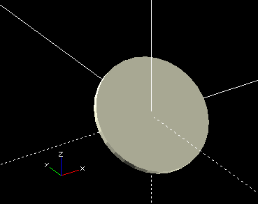

I think the section on 2D, and especially rotate_extrude, needs some
clarification.
I've only been using OpenSCAD for a few days, but it seems to me that the
best way to think of 2D objects is as follows.
A 2D object has no thickness, so must be extruded to create a 3D object. 2D
objects are created in the XY plane at Z=0. They can be translated and/or
rotated into any other plane. This is particularly useful for text used to
annotate a model.
In order to make it visible, a 2D object is drawn in Preview mode with a
thickness of 1 unit, but there is no actual 3D object at this time.
In Render mode, if the first object to be drawn is 2D, any 3D objects will
be ignored and vice versa. The projection of the 2D objects onto the XY
plane is drawn with zero thickness. To render the 3D objects, make sure the
first object is a solid.
There are two ways to extrude a 2D object into a solid. In both, if the 2D
shape has been translated or rotated out of the Z=0 plane, the extrusion is
of its projection onto that plane:
  • linear_extrude: The 2D object, or its projection, is extruded in the +Z
    direction. Any twist is applied about the Z axis. Positive twist angles
    create a left-hand twist, negative, right-hand. Center=true centres the
    solid above and below the Z=0 plane. It does not centre in X or Y.
    Centre=false extrudes from Z=0 into positive Z. You cannot set negative
    height, but can use translate to move the object into negative Z if needed.
  • rotate_extrude: The 2D shape, or its projection in the XY plane, is first
    rotated 90 degrees about the X axis to put it into the XZ plane, then
    extruded by rotation about the Z axis. You may prefer to think that the 2D
    object was first extruded about the Y axis, then the extrusion rotated to
    put its axis along the Z axis.
The current documentation says you can't use rotate_extrude to create a
model of a screw thread. True - you should use linear_extrude with twist.
Also, it says that if linear_extrude scale is a vector the resulting side
walls may be non-planar. This is relevant for polygons but not circles. It
reveals a bug in the rendering in 2015.03 which can be overcome by setting
the slices and twist parameters.
Also, it incorrectly says center=true centers a rotate_extrusion on the Z
axis. No, it doesn't. It puts the vertical centre at Z=0.
I'd be happy to edit the documentation, but don't know how to go about it.
Chris

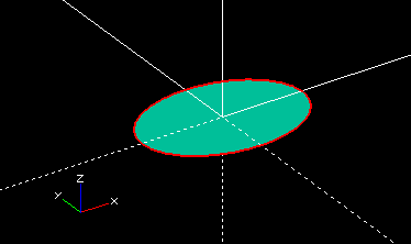

On second attempt, one might try to place the polygon in the XZ plane:
rotate_extrude()
rotate([90,0,0])
polygon(points=[ [0,0], [100,0], [100,100] ]);
The result is an infinitely thin circular face in the 3D XY plane. It
really does not make a lot of sense.

It seems to me that the primary confusion here is the difference between
how the *_extrude methods handle 3d-transformed 2d surfaces and how they
are displayed in preview.
Consider a simple example:
 rotate([45,0,0]) circle(r=10);
In preview, it appears as if the 2d shape is actually treated as being
in 3d space:
However, if you render the the same, it is projected onto the XY plane:
If you notice that this is the actual representation of the transformed
2d shape in OpenSCAD, then the extrusion makes much more sense, I think.
Perhaps it would be worth fixing how preview displays transformed 2d
objects?
Perhaps also worth noting this is in the docs? "If you're having trouble
with extrusion, try putting a bang (!) after the extrusion call and then
rendering, to see the 2d representation of what's going to be extruded."
~ Yona
In preview, it appears as if the 2d shape is actually treated as being in
3d space:
If you notice that this is the actual representation of the transformed 2d
