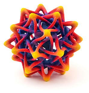

When you 3D print a mesh file that specifies surface colouring only (not volume colouring), then the slicing software arbitrarily figures out a way to apply colour so that the surface of the object looks the way you specified. You have no control over how colour is applied to material in the interior of the printed object, you are only controlling surface colour. As a corollary, this only works well for opaque materials.
When I do this, I typically create models with up to a million faces, so that I can create smooth colour gradients and other kinds of imagery on the surface of the model.
The following image gives an idea of what I'm talking about:
On Tue, Apr 7, 2020, at 12:42 AM, Jordan Brown wrote: > >> What this existing OpenSCAD code is doing is colouring faces (without any regard to volumes). As I pointed out, there are already mesh file formats that let you directly specify face colours. And there is already support for printing these files in full colour on existing 3D printers. So it would be possible to export colour to an X3D or VRML file using OpenSCAD's existing face colouring model. And then you could take existing colour OpenSCAD models found on the internet, and print them in colour, without rewriting the code to use a brand new volume colouring system. > > So if you have a cube with different colors on each of its faces, what does this existing tool chain do? > > (That's a serious question: I want to document color behavior, but I don't want to document it in a way that causes problems for full-color printing in the future.) > When you 3D print a mesh file that specifies surface colouring only (not volume colouring), then the slicing software arbitrarily figures out a way to apply colour so that the surface of the object looks the way you specified. You have no control over how colour is applied to material in the interior of the printed object, you are only controlling surface colour. As a corollary, this only works well for opaque materials. When I do this, I typically create models with up to a million faces, so that I can create smooth colour gradients and other kinds of imagery on the surface of the model. The following image gives an idea of what I'm talking about:
