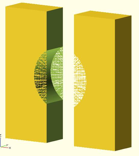

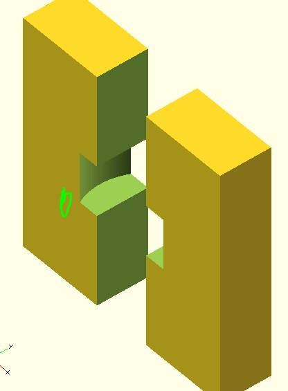

Greetings;

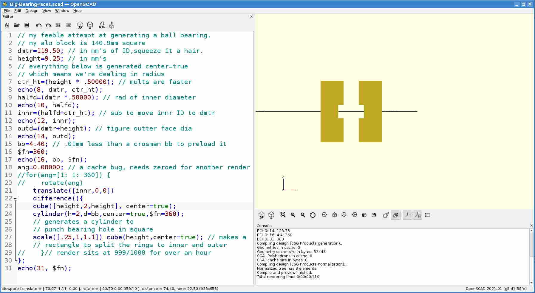

I have downloaded the January AppImage 3 times now, but all three copies
have had the same buglet, and I cannot proceed.
I've attached a screenshot. That is the whole program.  Takes about 14
minutes to render if the for loop is uncommented.  The hour+ comment was
a previous incarnation and is now wrong.
line 24 is supposed to be generating a cylinder, not the smaller
rectangle in the center of the right hand image.  How can I restore it
to draw an end on cylinder so it looks like [( )] in the right view.
Cheers, Gene Heskett

You are looking at all of it in the screenshot. I'll insert the .scad
file
// my feeble attempt at generating a ball bearing.
// my alu block is 140.9mm square
dmtr=119.50; // in mm's of ID,squeeze it a hair.
height=9.25; // in mm's
// everything below is generated center=true
// which means we're dealing in radius
ctr_ht=(height * .50000); // mults are faster
echo(8, dmtr, ctr_ht);
halfd=(dmtr *.50000); // rad of inner diameter
echo(10, halfd);
innr=(halfd+ctr_ht); // sub to move innr ID to dmtr
echo(12, innr);
outd=(dmtr+height); // figure outter face dia
echo(14, outd);
bb=4.40; // .01mm less than a crosman bb to preload it
$fn=360;
echo(16, bb, $fn);
ang=0.00000; // a cache bug, needs zeroed for another render
//for(ang=[1: 1: 360]) {
//    rotate(ang)
translate([innr,0,0])
cube([height,2,height], center=true);
cylinder(h=2,d=bb,center=true, $fn=360);
// generates a cylinder to
// punch bearing hole in square
scale([.25,1,1.1]) cube(height,center=true); // makes a
// rectangle to split the rings to inner and outer
//    }// render sits at 999/1000 for over an hour
echo(31, $fn);// checking to see if $fn survived, it does.

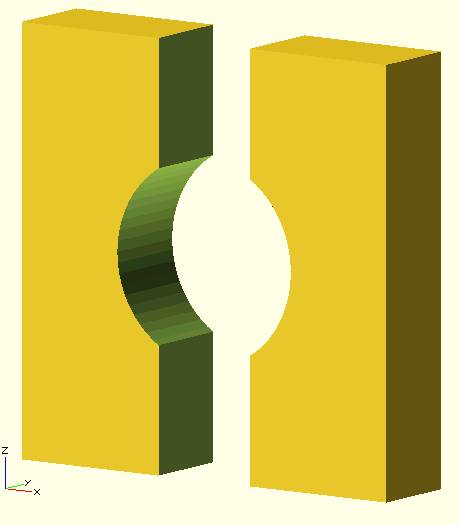

Difficult to file/open the screenshot ;)
You want to rotate the cylinder:
rotate([90,0,0])
To get rid of that z-fighting make the cylinder stick out of the cubes a bit
rotate([90,0,0])
  cylinder(h=2.1,d=bb,center=true, $fn=60);
Note $fn=60, renders fast.

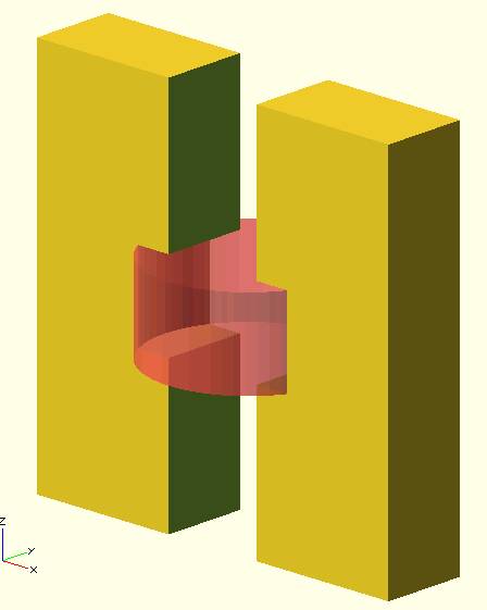

BTW, if you have trouble with a difference()'d item use #
e.g. your cylinder() without the rotate()
#cylinder(h=2.1,d=bb,center=true, $fn=60);
