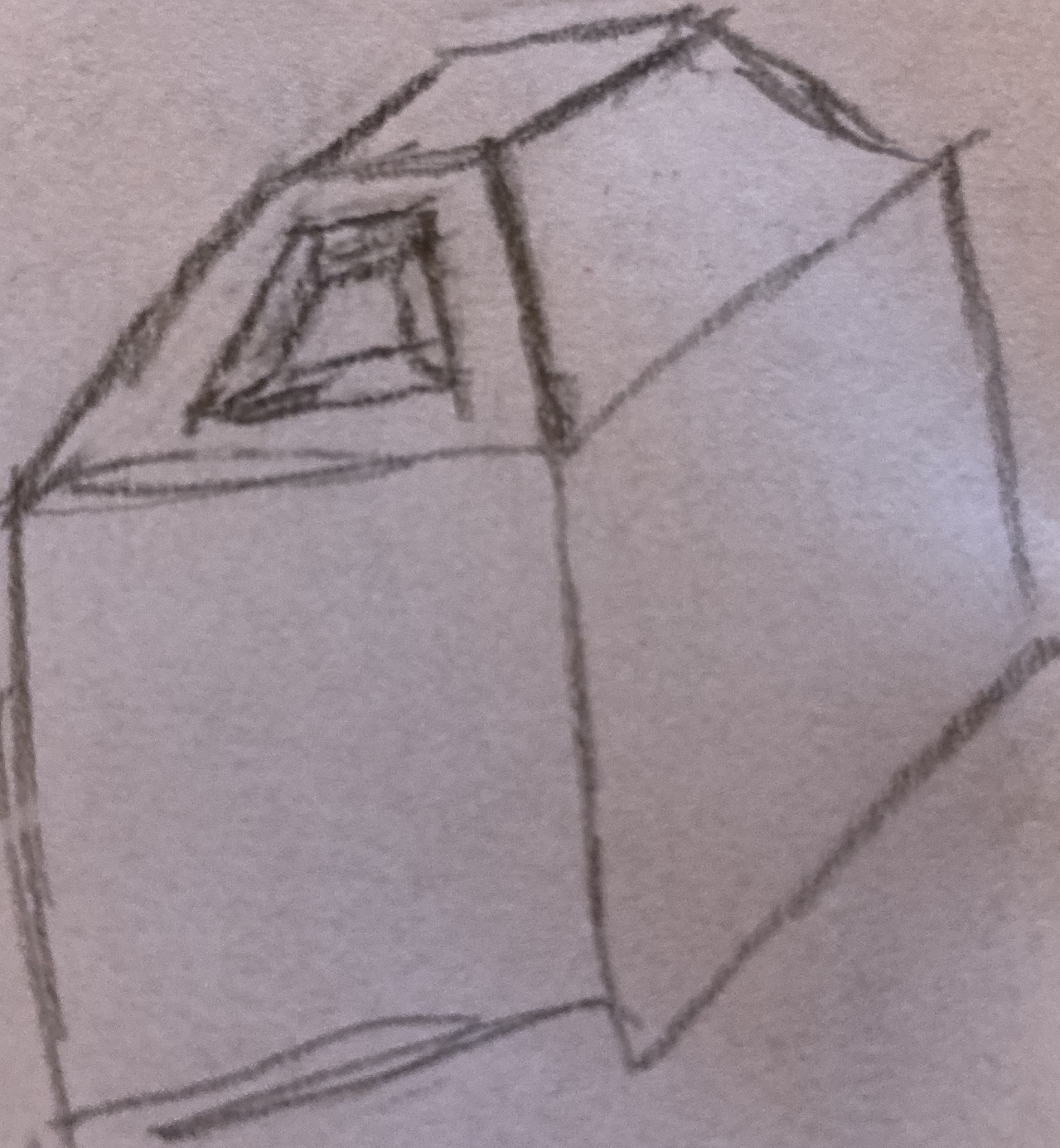

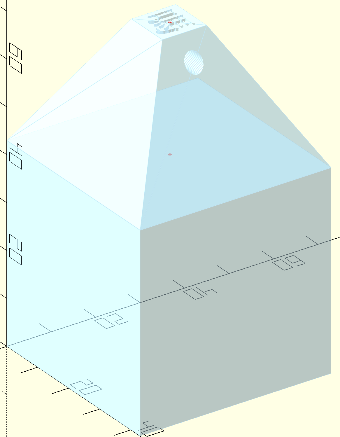

I have the following design for a piece of jewelry, which is a cube plus
a frustum (with some other stuff taken out of the middle), into which I
want to inset "face plates" on all sides  that would be suitable for wire
EDM manufacture.  The plates will have Chinese characters on them, so die
sink EDM might not be fine enough to carve them (?)  The main body looks
like this:
[image: Frustum Cube.png]
The plates for the cube sides are easy - just make more cubes, and subtract
the bulk from the main cube.  but how do I do the plates for the frustum?
I want something like this sketch:
[image: IMG_0460.jpg]
With the vaguely-tesseract-looking thing being the inset plate.  I'd prefer
not to have to calculate the angles and offsets and everything with trig to
construct it directly - it's complicated and introduces errors.
(Yeah, if I knew how to use Fusion, this could probably be put together in
about 15 minutes.)

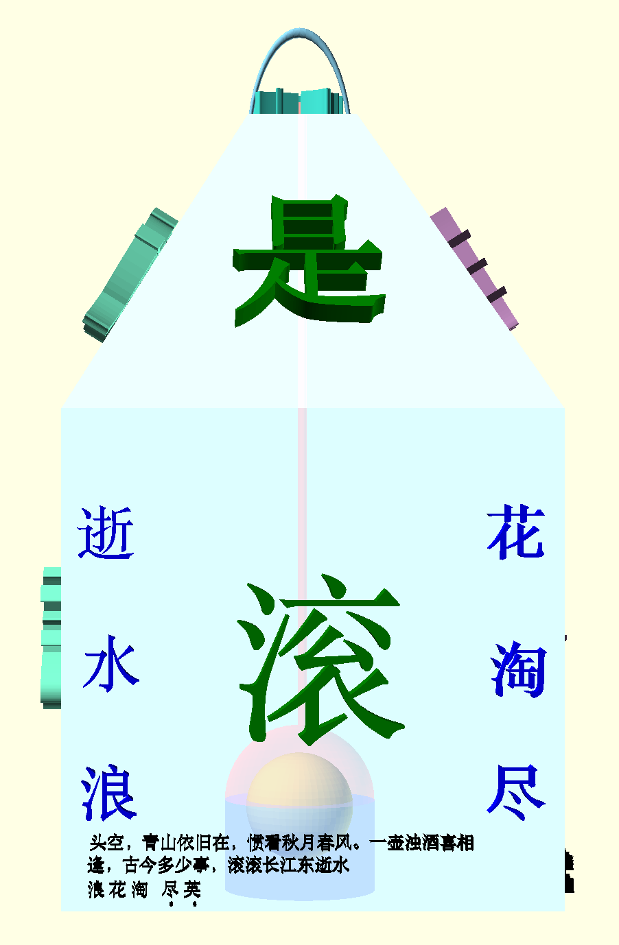

(*) I have another version with "out-set" characters ("bossed" rather than
"em-bossed"?) on top of the faces of the cube and frustum, for which I have
to calculate the frustum angle to rotate the extruded character:
xAxisRotation = atan(frustumHeight / ((cubeSideLength-frustumTopWidth)/2));
(The translucent stuff  is a cavity on the inside.)
[image: Pendant Cube-Frustum Mockup.png]
This for some reason introduces strange little bitty errors where one piece
of an extruded letter (the bottom stroke of a "二" ("èr") character) doesn't
quite reach the face of the frustum, so the resulting STP->BREP
conversion in Fusion (to end up with an STP file) ends up with two
components.  So I have a small fudge factor to make sure the character
intersectss the face.

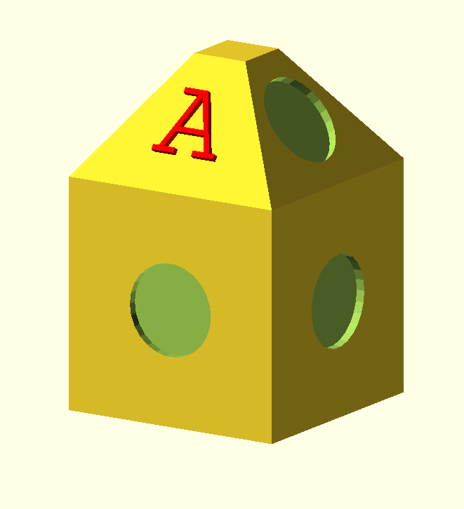

If I understand your intent, you want to cut out a shape from the various
faces of the shape.  I would do it using the BOSL2 attachment features.  No
math required, and the code is pretty straight forward, I'd say.
https://github.com/revarbat/BOSL2/wiki/Tutorial-Attachments
include<BOSL2/std.scad>
cubesize = 40;
topsize = 10;
topheight = 20;
diff("cut")
cuboid(cubesize){
tags("cut")
attach([RIGHT,FRONT,LEFT,BACK]) cyl(r=8,h=3);
attach(TOP) prismoid([cubesize,cubesize],[topsize,topsize], topheight){
tags("cut")
attach([RIGHT,LEFT,BACK]) cyl(r=8,h=3);
color("red")attach(FRONT) atext("A",anchor=CENTER,h=2,size=15);
