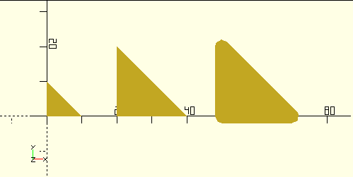

On 7/2/2024 6:06 AM, jon jonbondy.com via Discuss wrote:
Clearly, I do not understand the difference between a list of numbers,
a function() that returns a list of numbers, a module() that returns a
list of numbers, and the result of applying polygon() or offset() to
any of the above.
There are only two data types there:  a list of numbers, and a shape.
Unlike other programming languages[*], OpenSCAD has two very different
kinds of data that get passed around.  I don't think there's official
terminology, but for this message I'll call them ordinary values and shapes.
Ordinary values (whether numbers, strings, booleans, or arrays of
values) behave like ordinary values in other languages.  You can write
constant values in the program, store them in variables, pass them to
functions, return them from functions, et cetera.
num = 57;
array = [ 1,2,3 ];
str = "hello";
function add1(x) = x + 1;
y = add1(num);   // 58
Shapes are geometric shapes, either 2D or 3D.  They cannot (yet!) be put
into variables or passed around using ordinary-value mechanisms.  They
are created using primitive modules like cube(), sphere(), square(), and
polygon(), and you can manipulate them using transformation modules like
translate(), rotate(), and with boolean modules like union() and
difference().  You can combine them into modules, which then yield a
shape that is the union of the contents.
cube(10);
rotate(45) square(10);
translate([10,10,10]) rotate(45) cube(10);
module spherecube() {
    cube(10, center=true);
    sphere(d=13);
Going back to your comment:
any of the above.
[ Unless otherwise mentioned, the text below refers to core OpenSCAD.
BOSL2 adds some complexity to the picture. ]
A list of numbers, or a function that returns a list of numbers, is just
an expression with a value of a list of numbers.  The difference between
a list of numbers and a function that returns a list of numbers is that
the function presumably did some operations on its inputs to create the
list.
Modules do not return ordinary values.  Modules generate shapes.  It's a
non sequitur to talk about a module returning a list of numbers.
polygon() is a module that accepts a list of numbers (actually, a list
of lists of numbers), and generates a 2D shape.
offset() is a transformation module that accepts a 2D shape as a child,
and generates a modified version of that shape, moving its outside edge
in or out.
Let's put some of those together...
poly = [
    [0, 0],
    [10, 0],
    [0, 10]
A list of lists of numbers.  OpenSCAD doesn't know it, but it's a list
of three X-Y coordinates forming a triangle.
polygon(poly);
Turns that list of numbers into a shape - a triangle,
function double(v) = v * 2;
Takes its argument, multiplies it by two, and returns it.
poly2 = double(poly);
Note that multiplying a list by a number yields a list where each
element has been multiplied by the number.
translate([20,0]) polygon(poly2);
Turn that second list of numbers into a shape (a triangle that's twice
as big), and move it to the right.
translate([50,0]) offset(2) polygon(poly2);
Creates another polygon, extends its edges out two units (rounding the
corners), and moves it to the right.
All together:
poly = [
    [0, 0],
    [10, 0],
    [0, 10]
polygon(poly);
yields:
