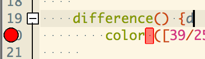

Tue, Feb 24, 2015 3:50 PM
In a simple single file project I have no syntax error highlighting with
either editor. Has this been removed?

MK
Marius Kintel
Wed, Feb 25, 2015 4:33 PM
On Feb 24, 2015, at 10:50 AM, nop head nop.head@gmail.com wrote:
In a simple single file project I have no syntax error highlighting with either editor. Has this been removed?
How does it look for you?
I would get this type of highlighting:

Wed, Feb 25, 2015 4:58 PM
If I press F5 I get error highlighting as you show. It doesn't work with
auto reload from an external editor.

MK
Marius Kintel
Wed, Feb 25, 2015 5:27 PM
On Feb 25, 2015, at 11:58 AM, nop head nop.head@gmail.com wrote:
If I press F5 I get error highlighting as you show. It doesn't work with auto reload from an external editor.
Thx.
This behavior is due to the fix for https://github.com/openscad/openscad/issues/406
It’s still unknown why that didn’t work. Could be an issue with Qt.
I don’t dare to touch this unless I can make sure #406 doesn’t resurface.
-Marius
