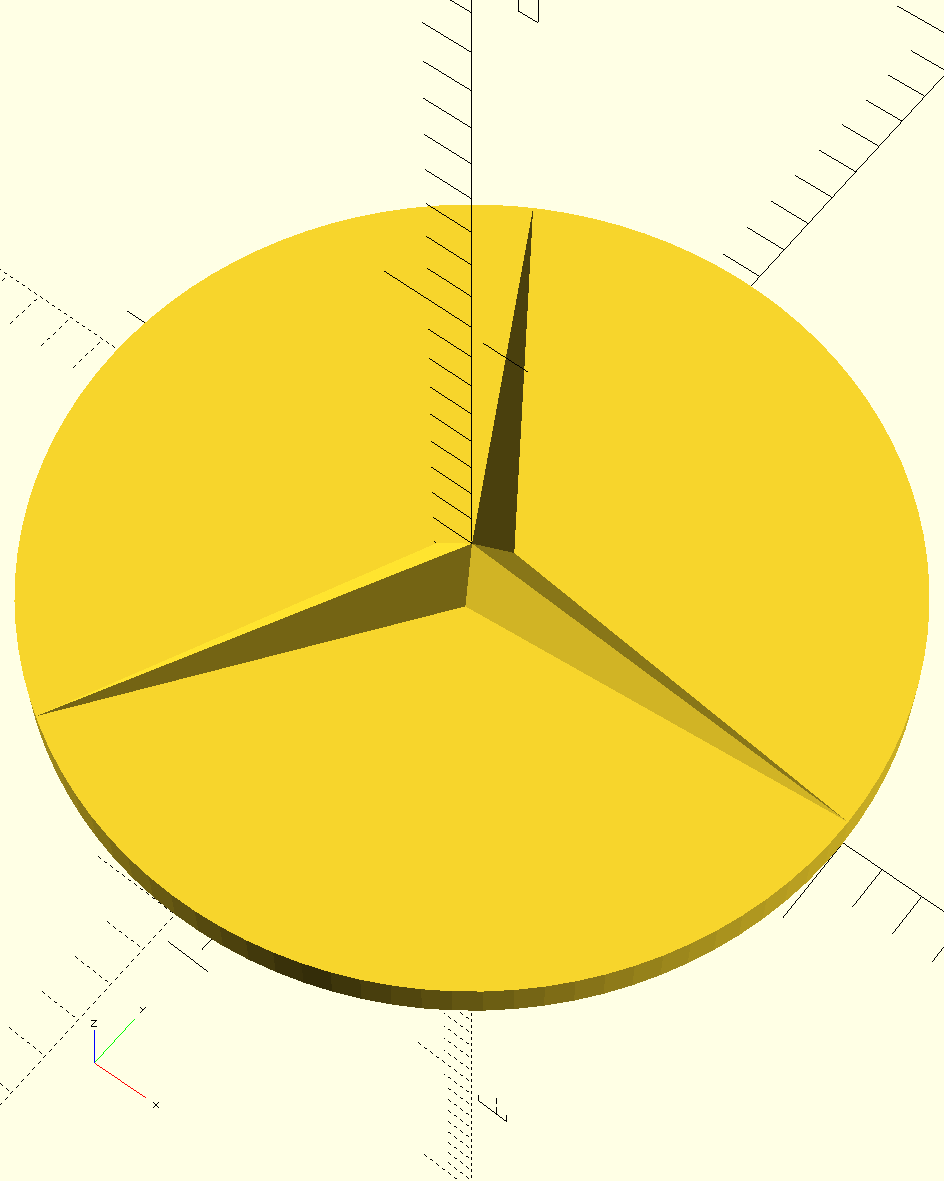

This is my first contribution to the list. I started just with openscad
and I am completely new to 3d design. Here is the first problem I run
into that I could not fix:
This is my code:
union(){translate([0,0,0.1])polyhedron(points=[[1, 0,0], [0.05,
-0.0866025,0], [-0.5, -0.866025,0], [-0.1, 0,0],
[-0.5,0.866025,0],[0.05,
0.0866025,0],[0,0,0.1]],faces=[[5,4,3,2,1,0],[0,1,6],[0,5,6],[1,2,6],[2,3,6],[4,6,1],[4,5,6]]);
cylinder($fn=100,h=.1,r=1);         }
It is the Mercedes Benz logo:
compiling and creating a .stl file only give half of the design, only
the disk.
console:
Geometries in cache: 3
Geometry cache size in bytes: 16008
CGAL Polyhedrons in cache: 2
CGAL cache size in bytes: 538784
Total rendering time: 0 hours, 0 minutes, 0 seconds
Simple: yes
Vertices: 200
Halfedges: 600
Edges: 300
Halffacets: 204
Facets: 102
Volumes: 2
Rendering finished.
What to do?

I took a look at your program and one of the faces is incorrect (wrong
vertex) and one is counterclockwise.  Fixing these defects:
polyhedron(points=[[1, 0,0],              //0
[0.05, -0.0866025,0],  //1
[-0.5, -0.866025,0],  //2
[-0.1, 0,0],          //3
[-0.5,0.866025,0],    //4
[0.05,0.0866025,0],    //5
[0,0,0.1]],            //6
[0,1,6],
[6,5,0],
[1,2,6],
[2,3,6],
[4,6,3],
[4,5,6]]);
This works.  Now you might also consider trying to avoid polyhedron as much
as possible because it is laborious to get it right, at least by hand.
Here's another approach using the BOSL library, with a simpler polyhedron.
The library is here:  https://github.com/revarbat/BOSL/
use<lib/BOSL/transforms.scad>
up(0.1)
zrot_copies(count=3)
polyhedron(points = [[0,.0911,0],[1,0,0],[0,-.0911,0],[0,0,.1]],
faces = [[0,1,2], [1,2,3], [0,1,3], [0,3,2]]);

This can be done fairly easily without polyhedron.  Something like:
cylinder(h=0.1, r=1, $fn=100);
translate([0,0,0.1]) {
for (a=[0:120:240]) {
rotate(a) {
hull() {
cylinder(h=0.1, r1=0.1, r2=0, center=false, $fn=24);
translate([1,0,0]) cube(0.0001, center=true);
  • Revar

Strictly speaking this doesn't make the right shape because the cube creates
extra facets (I assume they are from the cube.)  I looked at the STL file
resulting from just the three tetrahedra (no cylinder base) and this
solution makes an 823 line STL file.  I did come up with a different way to
make it exactly without polyhedron and the STL file is only 73 lines long,
so at least fewer extra facets.  It looks like there are 10 facets, which
seems minimal if facets have to be triangles.
translate([0,0,.1])
for (a=[0:120:240])
rotate(a)
linear_extrude(height=.1, scale=0) polygon([[0,-.0911], [1,0],
[0,.0911]]);

Well, OpenSCAD shouldn't crash, but it turns out I have the bottom face
reversed.  So it needs to be:
for (a=[0:120:240])
rotate(a)
faces = [[2,1,0], [1,2,3], [0,1,3], [0,3,2]]);
which just seems to be a further example of why you should avoid direct use
of polyhedron() whenever you can.  Or you can use this handy hull() function
(not the same as the hull module that is built in) to construct the face
list for you from the vertex list.
https://github.com/openscad/scad-utils/blob/master/hull.scad
use<hull.scad>
points = [[0,.0911,0],[1,0,0],[0,-.0911,0],[0,0,.1]];
faces = hull(points);
for (a=[0,120,240])
rotate(a)
polyhedron(points = points, faces=faces);

I would have done it like this:
p= [[1, 0], [0.05, -0.0866025], [-0.5, -0.866025], [-0.1, 0],
[-0.5,0.866025],[0.05, 0.0866025]];
linear_extrude(0.1, scale=0) polygon (p);

Very elegant! Let's make all the typo-prone numbers go away as well, while shortening it up..
p = [for (a=[0:120:240]) each [[cos(a),sin(a)], [cos(a+60),sin(a+60)]/10]];
linear_extrude(0.1, scale=0) polygon(p);
