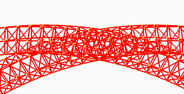

As a test case, I took a torus knot generated by sweeping a circle. To
simplify I have chosen a knot (3,2) which has only 4 areas of projection
overlapping (see attached image).
My test main code was simply:
// geometric data
n = 20;  // section discretization
m = 40 ;  // path discretization
d = 20;  // section radius
R = 400;  // knot major radius
r = 150;  // knot minor radius
p  = 3;
q  = 2;
to = true;
echo(p=p, q=q);
echo(n=n, m=m);
if(to) {
echo("only knot");
sweep(sections(p,q,n,m,d));
else{
echo("knot projection");
projection()
where sections() generates m circular sections with n points each along a
(3,2) knot path. The full code I have used in my tests is attached. Note
that the circular sections have a radius d very small compared to the torus
major radius. I have ran three cases with 20000 vertices and I got these
time results:
                    just the knot           knot projection
n =  50, m = 400          6 sec                    12 sec
n = 100, m = 200          6 sec                    16 sec
n = 500, m =  40          6 sec                  2 min 45 sec
What makes the last projection so slow? The last one is the case whose
projected polygon has the least number of vertices, estimated as something
near 2*m = 80 point. The reason might be the number of triangles that have
intersection after the projection. My second image shows the detail of one
of those intersections in wireframe view for n=6 and m=40. With n=500, more
than 2000 triangles overlap at each of the 4 intersections. The third image
shows the detail of the same knot intersections in wireframe view for n=6
and m=200 and it seems that much more triangles overlap when m is
increased. So, the number of overlapping triangles doesn't seem to be the
reason for a long run time of the projection. Two additional tests have
shown the puzzle complexity: with 25000 points (n=500, m=50) the projection
required 2 min and 2 sec and with n=500 and m=80 (40000 vertices) the
projection time was nearly the same: 2 min and 43 sec..
The torus knot seems to be easy to project by silhouette computation
followed by the sweep line algorithm: it may have a lot of silhouette
segments but a few intersections between them. A much harder case for that
algorithm would be a linear_extrusion of a circle with a cleverly chosen
twist and a scale a slightly less than 1.
OpenSCAD projection() performance is still a mystery.
