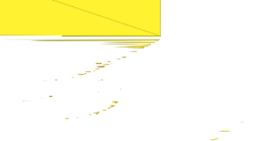

I just tried it again in Firefox and it's now working. I did not see the
error I saw before The viewer is leaving tracks, though:
I changed the size of the cubes in the editor and that worked.

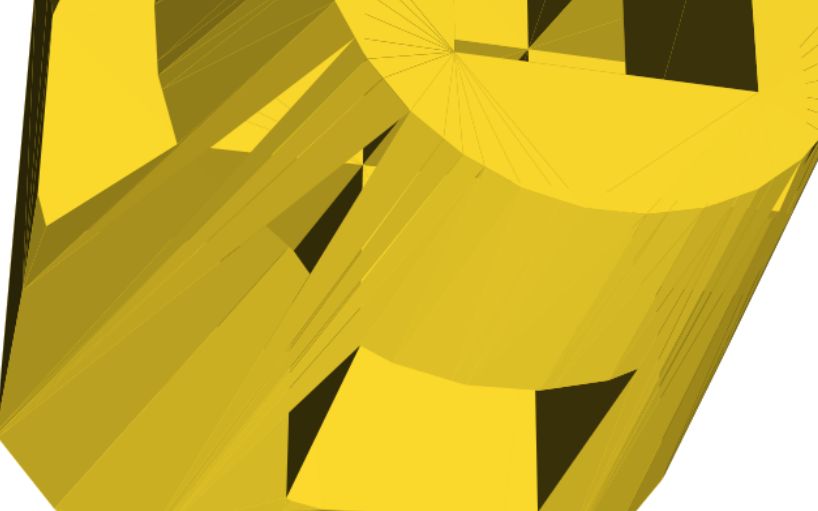

This is the more complex model surface instability:
Looks like there are chunks missing from the surface. By unstable I mean
that the holes come and go as the camera angle changes.
