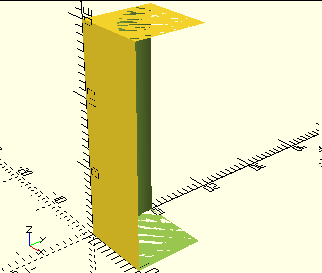

Here's meniscus(30,10):
First, let's consider the X-Y position.  You're going to want to
position this at corners of the thing you're cutting, right?  So design
it so that when you position it to that corner, it's in the right place
to cut - which means that the origin should be along the corner.  The
X-Y origin should be at what is [10,10] in my picture above.  To make it
a little more obvious, let's have it cut into +X and +Y.

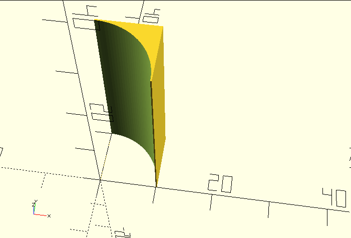

That shape would then be fundamentally a cube with a translated cylinder
subtracted from it.  It will look something like so:
module meniscus(h, r, fn=128){
	$fn=fn;
		cube([r, r, h]);
		translate([r,r,0]) cylinder(h=h, r=r);
(We'll come back to the Z-fighting adjustment, the 0.2 in your program,
in a moment.)

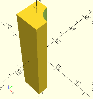

Next, let's talk about Z.  Where is the object you're cutting going to
be in Z?  Is it going to be in +Z, -Z, or centered?
There's an easy trick:  make this "negative" object be three times as
long as the biggest edge you're going to cut, and center it in Z.  That
way it's long enough, whether you position it at one end, the other, or
in the middle.  (Three is overkill.  All you really need is two plus a
little.  But 3 is easier to type than 2.1.)
Now, back to the X-Y adjustment for Z-fighting.  A similar trick works:
if we make the cube 2r in X and Y, and 3h in Z, and center it, it's
all lined up for that cylinder to be subtracted, without having to add
and subtract Z-fighting adjustments anywhere.
Once you've done those things, the module will look like
	$fn=fn;
		cube([r*2, r*2, h*3], center=true);
		translate([r,r,0]) cylinder(h=h*9, r=r, center=true);
(Note that I applied the times-three-and-center trick to the cylinder so
that I don't have to worry about how it aligns with the cube.)
It will produce:

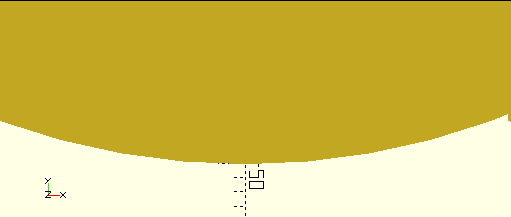

Even for a large circle, sides that are 5° across are hard to see.  Set
$fa to 5.  For a 100mm-diameter circle, that gets you 72 sides.
Here's a zoomed in picture of that circle.  The sides are barely visible.

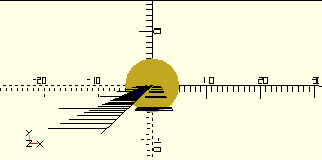

Sides much smaller than a millimeter are overkill.  (Even if your circle
is only a millimeter across, it's going to be built out of 0.4mm
filament traces so there's only so much you can do.)  Set $fs to, say,
2.  For a 10mm-diameter circle, that gets you ~16 sides.  That doesn't
seem like very many, but we're talking about a small circle.  This
screen shot is about 2x size on my monitor, maybe a bit smaller on
yours.  It's still a pretty good-looking circle:
