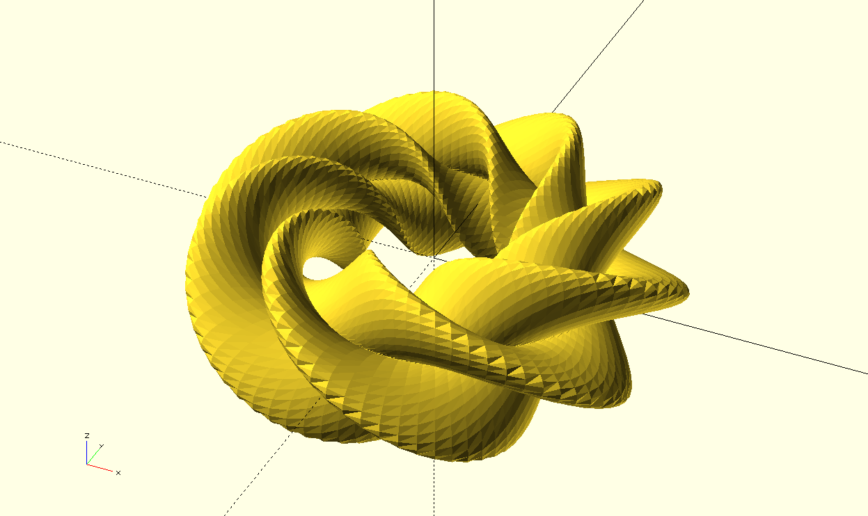

Do you mean something like this?
https://gist.github.com/atnbueno/ef8b30d84c3594f97c75d3a793fcc066

Aleandro
Thu, Mar 29, 2018 4:47 PM
This is exactly what I was looking for, thank you. However, the file gives me
a compilation error, see the screenshot attached. Do you know why I get this
error?
Thanks

Antonio Bueno
Thu, Mar 29, 2018 5:18 PM
It looks like the problem is the "else" in the list.
I'm using the last snapshot version for Windows (2018.03.10) with all the
experimental features enabled, in particular "lc-else", which allows the
use of "else" in list comprehensions.
If you can't/don't want to use this version or feature, try commenting out
lines 45, 47, 48, 51, 53, and 54:

That "disables" the "attempt" mentioned at the beginning of the script and
triangulates everything the same.

Aleandro
Thu, Mar 29, 2018 6:00 PM
This works fine and compiles with no errors, than you.
