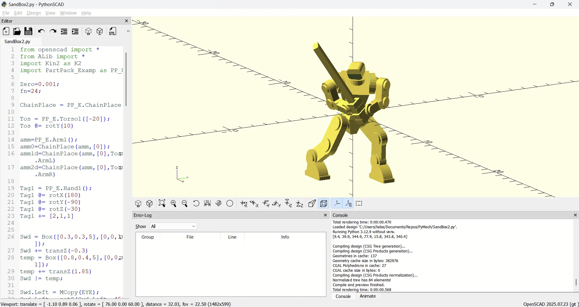

For OpenSCAD, this difficulty is even more mired in a fundamental set of divisions:
 - OpenSCAD makes modeling designs using rectangles, cylinders and spheres using mathematically calculated placements and distortions and arrangements simple
 - the usage of OpenSCAD is strongly bounded by the user's knowledge of mathematics, their fluency with the programming constructs which which OpenSCAD affords, and their ability to find modules/libraries/existing projects w/ Customization options which meet their needs
 - the functional programming methodology places some hard limits on modifying state for projects where such a division would be helpful
That last is neatly addressed by either programming in a second language and generating OpenSCAD code, or using a second language w/in OpenSCAD as is done by (Open)PythonSCAD: https://pythonscad.org/ with a simply amazing example of this being:
https://old.reddit.com/r/OpenPythonSCAD/comments/1mn2nrd/cool_mech_kinematics_script_in_pythonscad/
which shows the potential of moving beyond OpenSCAD.
