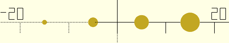

 Circle Object Module
By default this module draws a unit circle centered on the origin
[0,0] as a pentagon with its starting point on the X-axis at X=1. Its
lines have no thickness but the shape is drawn as a 1 unit high,
filled plane.
The part of the first sentence starting "as a pentagon ..." should go
away.  It's true, but it really belongs as part of the description of
$fa/$fs.
Again, the second sentence should just go away.
Somewhere it should say "Circles are approximated as regular polygons;
see <reference to $fa/$fs/$fn> for the details of the polygons generated."
The argument|radius|may be given without being named, but
the|r|and|d|arguments must be named.
There is no "radius" argument.  There are r and d.
Again, we should have a documentation convention so that we don't have
to repeat positional/named rules, but the behavior here is that r can be
supplied as the first argument, but d must be named.
(Technically, if you say "circle(undef, 10)" the 10 is the second  it
creates a 10-unit-diameter circle.  I would say that the fact that this
works is a minor bug.)
$fa
Special Variable
$fs
Special Variable
$fn
Special Variable
Theses should be described only to the extent of pointing at the general
description of $fa/$fs/$fn.
The default circle displays as a pentagram as that is the minimum
number of fragments used to approximate a curved shape calculated from
the default values for $fs and $fa. To have it draw as a smooth shape
increase the $fn value, the minimum number of fragments to draw, to 20
or more (best $fn < 128).
This is just bad.  First, everything here should be covered in the
description of $fa/$fs/$fn.  Second, using $fn to control the resolution
of a circle is generally the wrong answer; you are better off setting
$fa and $fs.  Finally, specific advice on $fn values is a bad idea,
because the "looks smooth" value varies dramatically with size.  A
20-gon is okay for a medium-small circle; a 72-gon is not good enough
for a 100-unit circle.
An alternative method to draw a very smooth circle scale is to scale
down a very large circle.
scale( 0.001 ) circle(200);
This should just go away; it confuses the issue.

For the record, several modules in BOSL2 that can create multiple copies of a shape, create $idx (or similar) special variables in their scope, that the child modules can use to change their behavior.  For example:
xcopies(10,n=4) circle(d=$idx+1);

For the record, several modules in BOSL2 that can create multiple copies of a shape, create $idx (or similar) special variables in their scope, that the child modules can use to change their behavior. For example: xcopies(10,n=4) circle(d=$idx+1); will create four circles of increasing diameter, spread every 10 units along the X axis.  - Revar > On Aug 8, 2025, at 1:06 AM, Jordan Brown via Discuss <discuss@lists.openscad.org> wrote: > > [ Sigh yet again... what e-mail address I use is largely automatically handled on my desktop, but not on this laptop. ] > > Mattheiu is right; this needs a subject change. > > On 8/6/2025 12:51 AM, vulcan_--- via Discuss wrote: >> One should not attempt to infer the API contract from the behavior. >> >> umm .. then how better to understand it? >> > Reread the documentation. Repeat repeat repeat. Then ask and/or inspect the sources. Behavior is good only for very targeted questions, and even then should be tempered by the others. > >> i am not at all clear what overfit means .. >> > He means that you may assume that the behavior that you see is the only possible behavior. (For instance, you may assume that some particular triangularization (or lack thereof) is the promised answer, and it isn't.) > > >> Yeah, specials are still a fuzzy thing for me .. even after Jordan’s diligent attempt to educate me on how they work i am not at all clear on what they bring to the language that is any different from having global variables at the top level of scope >> > > They *aren't* necessarily at the top level. Try running this... > > normal = "top"; > $special = "top"; > > module foo() { > echo(normal=normal, $special=$special); > } > > module bar() { > $special = "bar"; > normal = "bar"; > foo(); > } > > foo(); > foo($special="top per-call"); > bar(); > echo(normal=normal, $special=$special); > > Normal variables are scoped based on the program's static structure, so "normal" is visible from the top, from foo(), and from bar() until the definition of the new "normal" on bar's second line. Nothing ever refers to bar's definition of "normal". > > Special variables ($ variables) are scoped based on the call stack. The initial setting ("top") is visible at the top level, and in anything called from the top level - which means the top-level call to foo(), and the call to bar() until bar's first line, where a new $special is created ("bar"). That new $special is visible to bar() and to everything that bar() calls - notably, its call to foo(). The second call to foo() sets $special in the call, and that setting applies to that call to foo() and everything that it calls (which is nothing). > > Another way to put it: > > For a normal variable, to find the assignment, start at the reference to the variable, then look at that scope. If it's defined there, you're done. Move to the next higher scope (one fewer level of braces). If it's defined there, you're done. Continue until you reach the top scope. > > For a special variable, look at the current scope. If it's defined there, you're done. Move to the place that called this module; look at the scope there. If it's defined there, you're done. Continue until you reach the top scope. > > It's actually a little more complicated than that, in in both cases that a reference in an assignment needs to look at earlier assignments in that scope. > > > > _______________________________________________ > OpenSCAD mailing list > To unsubscribe send an email to discuss-leave@lists.openscad.org
example:
along the X axis.
Yes.  This capability - passing special variables from parent to child -
is implied by the "the scope it's defined in and all scopes called from
that scope" rule.
It does point out one subtle aspect of the semantics:  the top level
does not "call" circle() in this case.  Rather, xcopies() calls it (via
children() and the particular call supplied by the top level.  I don't
remember exactly what thread it was, but there's been a significant
discussion about the need for documentation to discuss this behavior,
while at the same time keeping the description of the  "rotate() cube()"
case simple.
