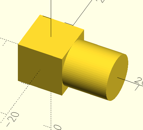

In the BOSL2 library, for example, the cuboid() module draws geometry and
can be invoked without children, but it also optionally accepts children
and runs them.  There are very few modules in BOSL2 that satisfy condition
2 on your list because almost everything that creates geometry also accepts
children, and furthermore, BOSL2 redefines most of the native modules to
match BOSL2's general behavior.
So in BOSL2:
include<BOSL2/std.scad>
cuboid(10) attach(RIGHT,BOT) cyl(r=5,h=10);
produces this:
