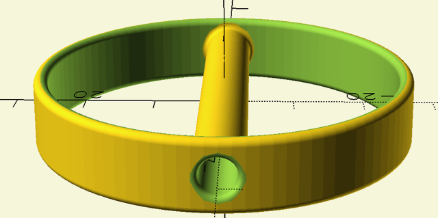

1. Did you try the manifold backend? 2. For NURBS-based boolean, I think one can just use opencascade, and things like build123d or cadquery should support it already. That said, one major benefit of NURBS-based modeling is constraint solving, so it feels like missing the point if we do not consider that. 3. It is unlikely that we can have things like stl import or minkowski. Theoretically it should be possible, but it will probably be too slow. On Thu, Aug 14, 2025, 04:30 Todd Allen via Discuss < discuss@lists.openscad.org> wrote: > Since all that I do with the 3D models that I create with OpenSCAD is > print them on a 3D printer, so long as the output looks smooth at the level > of 0.1 mm, I don't care about the other details. > > > I have 3D printed models that can not be generated with curves at even 1 > mm without being insanely slow and burdensome. For example printing a long > thin belt in TPU modeled with the belt width in Z and starting from a > diameter the width of the print bed spiraling inward. If the belt is 1 mm > thick and it spirals in at 1.5 mm per loop one can easily go 50+ loops on a > moderate sized printer. > > On Wed, Aug 13, 2025 at 12:37 PM Jon Bondy via Discuss < > discuss@lists.openscad.org> wrote: > >> Since all that I do with the 3D models that I create with OpenSCAD is >> print them on a 3D printer, so long as the output looks smooth at the level >> of 0.1 mm, I don't care about the other details. >> On 8/13/2025 11:41 AM, John David via Discuss wrote: >> >> I just got a half dozen private and small group replies (that do not >> overlap each other), so I am just going to post a reply to the group... >> >> I assure those of you who do not know the mathematics behind NURBS, that >> they can indeed represent an exact circle (see: >> https://en.wikipedia.org/wiki/Non-uniform_rational_B-spline#Example:_a_circle >> for at least some details, and Gerald Farin's book on NURBS >> https://www.farinhansford.com/books/nurbs/ for the math and >> practicalities behind it). Now, a couple of people have used the term >> "true circle". I am assuming that you mean "a perfectly round shape >> defined by a single, continuous mathematical curve, not a series of short >> lines". Depending on the degree of the NURBS, you get something called C* >> and G* continuity (where * is the degree of the object/NURBS). So yes, a >> NURB will exactly define a "true circle". That said, there are practical >> implementation details that come into play. Since you have >> evoked CNC/G-code, as well as NURB curves and surfaces, they have to be >> evaluated as some epsilon. Even a G02 (clockwise arc in g-code), has to >> evaluate the mathematical expression of an arc/circle at the precision of a >> machine's step size. This is often well below 0.001" (I have machines >> whose step size are 0.00002"). Both a mathematical circle, as well as a >> NURBS with appropriate knots sequences and weights of sqrt(2)/2, will >> mathematically give you a fully mathematically continuous and exact circle. >> >> Since you also mentioned wanting these in 3D printing, and CNC, even >> LinuxCNC has an experimental implementation, and I know commercial CNC >> machines often have NURBS implemented directly in the G-Code >> implementation. I am not familiar with any 3D printing software the >> supports NURBS, but I have not needed to check. I will say that the way >> NURBS are defined is so well-defined, that it is typically easy to write a >> translator to go from one representation to another. In addition, there >> are enough prototype implementations that a motivated programmer should be >> able to port any one of a dozen implementations/libraries to open-source 3D >> printing software. If you go for that, hit me up, and I will dig through >> my archived class projects -- back in 2001 I took Gerald Farin's PhD level >> class on CAGD, as well as others. One of the other students and I made a >> game of challenging each other with different implementations of evaluating >> the N-Dimentional Bernstein Polynomials (and you can implement NURBS based >> on them). Anyway, we ended up with something that is wicked fast, and if I >> recall correctly I set mine up to cache the intermediate results for >> various efficiency reasons (like further subdivisions, etc.). >> >> Anyway, this was all very long-winded, BUT I think that NURBS will give >> you want and need (it will look very weird at first), but you will have to >> either see if there is downstream implementations of NURBS in your 3D >> printing and CNC software. >> >> EBo -- >> >> On Wed, Aug 13, 2025 at 10:59 AM Rogier Wolff via Discuss < >> discuss@lists.openscad.org> wrote: >> >>> >>> > On Aug 13, 2025, at 7:20 AM, William F. Adams via Discuss < >>> discuss@lists.openscad.org> wrote: >>> >>> > It is an interesting mathematical exercise to prove how a Bézier >>> > curve cannot exactly represent a circle --- but I think it would be >>> > even more interesting to show a real-world example where the want of >>> > that ability has resulted in a difficulty making a part --- it's a >>> > close enough approximation for most (or even the vast majority of) >>> > usages. >>> >>> We'd like to do 3D printing and CNCing with the results from the CAD >>> process, right? >>> >>> Well... if I design a round hole for an object and the object that >>> goes inside, then I expect that object to be able to rotate. Any >>> deviation from a true circle will cause it to "not be able to rotate". >>> >>> If you create sufficient tolerances that it does rotate, you'll get >>> it to fit tighter and less tight along the full rotation. >>> >>> This design and wanting to CNC that with a low tolerance on a good CNC >>> isn't all that farfetched. So maybe my "visually a spline is close >>> enough to a circle" is not quite good enough. >>> >>> I got educated on "computer graphics" mid 1980s. So back then: "looks >>> good" was important and "exact fit" maybe not so much. The wikipedia >>> article mentions late 1980s as the first implementation of NURBs. >>> >>> Roger. >>> >>> -- >>> ** R.E.Wolff@BitWizard.nl ** https://www.BitWizard.nl/ ** >>> +31-15-2049110 ** >>> ** Verl. Spiegelmakerstraat 37 2645 LZ Delfgauw, The Netherlands. >>> ** KVK: 27239233 ** >>> f equals m times a. When your f is steady, and your m is going down >>> your a** is going up. -- Chris Hadfield about flying up the space >>> shuttle. >>> ** 'a' for accelleration. >>> _______________________________________________ >>> OpenSCAD mailing list >>> To unsubscribe send an email to discuss-leave@lists.openscad.org >>> >> >> _______________________________________________ >> OpenSCAD mailing list >> To unsubscribe send an email to discuss-leave@lists.openscad.org >> >> >> >> <http://www.avg.com/email-signature?utm_medium=email&utm_source=link&utm_campaign=sig-email&utm_content=emailclient> >> Virus-free.www.avg.com >> <http://www.avg.com/email-signature?utm_medium=email&utm_source=link&utm_campaign=sig-email&utm_content=emailclient> >> <#m_1452791907063285202_m_-4516900968302012369_DAB4FAD8-2DD7-40BB-A1B8-4E2AA1F9FDF2> >> _______________________________________________ >> OpenSCAD mailing list >> To unsubscribe send an email to discuss-leave@lists.openscad.org >> > _______________________________________________ > OpenSCAD mailing list > To unsubscribe send an email to discuss-leave@lists.openscad.org >
PK
Peter Kriens
Thu, Aug 14, 2025 8:58 AM
Maybe if you're purely data driven?
What I like about the attachment model is how you never have to figure out positions. Worst case a shift from a well known position relative to another object. You can get highly complex components and easily change major parts without having to refactor and recalculate a lot. Positions then quickly become complex to calculate when the objects are at angles. I learned that for injection molding everything is slightly angled to allow the release of the mold but it means there are never any easy modulo 90 degree angles. (The rounded_prism() is my hero).
The absolute crown enabled by the attachment model is however, the prism_connector ...
diff()
tube( id=50, h = 10, rounding=1, wall=2)// the ring
let(tube=parent())
attach_part("inside")
prism_connector( // the solid tube on the inside of
circle(d=7), // the ring
parent(), LEFT,
parent(), RIGHT,
fillet=1
restore(tube)
tag("remove")
prism_connector( // the inside of the tube with
circle(d=5), // exit on the outside of the ring
parent(), LEFT,
parent(), RIGHT,
fillet=1
For me the attachment model of BOSL2 is the main reason I did not dive into Python. It is absolute stunning, it is now hard for me to believe you can make complex modular components without them.
