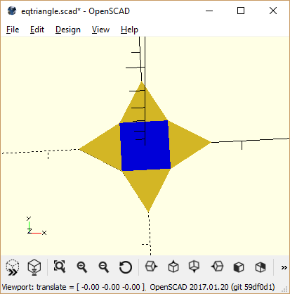

Are you looking for something like this?
Here's the OpenSCAD program that generated that:
// Create an equilateral triangle of the specified size.
// [0,0,0] is at the center of the base.
module eqtriangle(side) {
    polygon([
        [-side/2, 0],
        [0, side*sin(60)],
        [side/2, 0]
side = 10;
color("blue")
    square(side, center=true);
for (a=[0:90:270]) {
    rotate(a)
        translate([0,side/2, 0])
        eqtriangle(side);
But note:  you talked, I think, about filling the plane with those
equilateral triangles.  That can never work with a square in the mix,
because each vertex needs 360° and squares have 90° corners while
equilateral triangles have 60° corners.  To fill triangles around the
corner of the square you'd need to fill 270°, but 270 is not a multiple
of 60.  Similarly, if you were talking about putting triangles inside
the square, the corners of the square are 90° and the corners of the
triangles are 60°.
