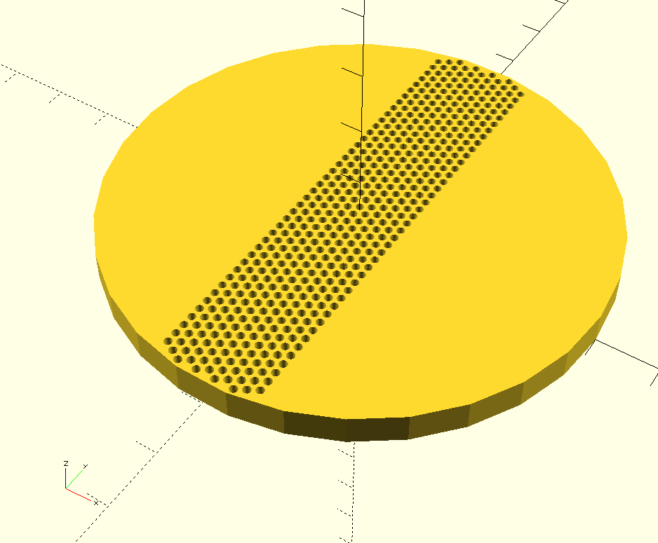

Hello !
In a software I'm developping, I'm trying to use OpenSCAD to generate a
3D model of one of the parts that the software is computing.
The thing I'm trying to make is usually a big cylinder with a lot of
holes in it (can range from around a hundred holes to a few thousand).
So naively, I did the following to generate it :
  • 1 : draw the "big" cylinder.
  • 2 : draw every hole has a tiny cylinder with the same height has the
    big one.
  • 3 : Use difference() with the big cylinder and all the tiny cylinder.
So something like this in OpenSCAD (I've attached an exemple of what my
software generate) :
cylinder(1.000000,400.000000,400.000000,true);
translate([0.000000,0.000000,0.000000]) {
cylinder(1.000000,6.500000,6.500000,true); }
translate([31.180000,0.000000,0.000000]) {
translate([-31.180000,0.000000,0.000000]) {
cylinde(1.000000,6.500000,6.500000,true); }
translate([62.350000,0.000000,0.000000]) {
My problem is that, even though the preview works great, when trying to
render the mesh, it can take around half an hour to an hour and a half
to complete, even with a fairly powerful PC and with the last version of
OpenSCAD (2016.01.27).
I tried to tweak around using $fn, $fa and $fs, but the rendering time
is still very long.
So, I was wondering if my method was completly wrong or if there was any
advice you could give me to lower the rendering time.
Faithfully yours,
Maël Naccache contact@maeln.com

It will be much faster if you do it in 2D with circles and then
linear_extrude it to make the cylinder.

In a few tests I tried, the rendering time is almost one third when the
hole cylinders have a height greater than the base one. Anyway, avoiding
coincident faces in CSG operations is a good practice.

I tried your solution. Using circle make it way faster, but when I do
the linear_extrude,
it take nearly the same amount of time has my previous method :/ .
the hole cylinders have a height greater than the base one. Anyway,
avoiding coincident faces in CSG operations is a good practice.
Thanks for the tips :) !

I've attached two exemple that takes a long time to render.
The first one (circle_extrude1.scad) use nophead idea (circles then
lines_extrude),
the second one (cylinder_higher1.scad) use Ronaldo tip (the cylinder for
the hole have a height superior to the main cylinder).
Yep, that's just it, I want to substract a lot of small cylinders (who
share the same size) from a big one.
Ok, that's easy enough to simulate directly, i will give it a go.
Regards

I found circle_extrude1.scad to be instantaneous for F6 in
OpenScad2015.05.16 (git e673fff) .
Total rendering time: 0 hours, 0 minutes, 0 seconds
Facets: 59016
The reason is it doesn't use GCAL for 2D or linear extrude.
Are you using an old version of OpenScad? It used to use GCAL for 2D.

Everything seems ok on my side, but I've pasted them just in case :
http://paste.ubuntu.com/15273519/ - circle_extrude1.scad.
http://paste.ubuntu.com/15273525/ - cylinder_higher1.scad.
Facets: 59016
Oops, sorry, forgot to mention that I do most of my test on the version
2014.03 (I only have access to this version at work, but I can probably
update it), when I get back home, I will try your solution. Thanks :) !
