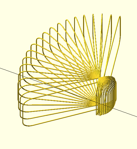

The following code previews fine but fails in rendering. When I comment out
the one_node() line, it works. I have no idea how to fix this.
Console log:
ERROR: CGAL error in CGALUtils::applyUnion3D: CGAL ERROR: assertion
violation! Expr: itl != it->second.end() File:
/mxe/usr/x86_64-w64-mingw32.static.posix/include/CGAL/Nef_3/SNC_external_structure.h
Line: 1152
Geometries in cache: 8
Geometry cache size in bytes: 6137040
CGAL Polyhedrons in cache: 0
CGAL cache size in bytes: 0
Total rendering time: 0:00:37.313

When render fails like this it means you have an invalid polyhedron.
In this case it is the one_node path sweep, because your shape has too
small of a radius to accommodate the polygon width so the profiles
cross each other, leading to a bogus polyhedron.  The simplest
solution is to change to path_sweep2d.  But it is very much slower.
You could fiddle with quality to help.  Decreasing point count on
your profile will help.  There might be a faster solution of breaking
it up into three regular path_sweep calls.  Not sure.  Oh, and for
path_sweep2d you need deduplicate(path).

Tue, Feb 15, 2022 12:54 AM
I added a feature to the latest BOSL2, a profiles=true option and a
width option that will display the wireframe of all the profiles in
your path_sweep.
I've attached what your model looks like.  For it to be valid you need
to avoid any intersection of those profiles.  I think that the
semi-circular section might be crossing at the center, so to get it to
work as a union of parts you should probably make the circular part
with a cyl() command and then you can make the other part with a sweep
(and an xflip_copy() to get the other half).  That is, I think you can
create this part efficiently somehow.

Tue, Feb 15, 2022 3:20 AM
The really big problem with your existing design is that your
rectangle is too large so it crosses in the middle for the big
circular arc.    See pic below showing the middle section.  There's no
way to fix that by subsetting your curve.  You have way more points
than you need in the flat section leading in.  Maybe by cutting the
points there you could get path_sweep2d to be not so slow.  But
otherwise, you have to replace that circular part with something else,
like perhaps you can use a smaller rectangle so it doesn't cross for
that middle section.
