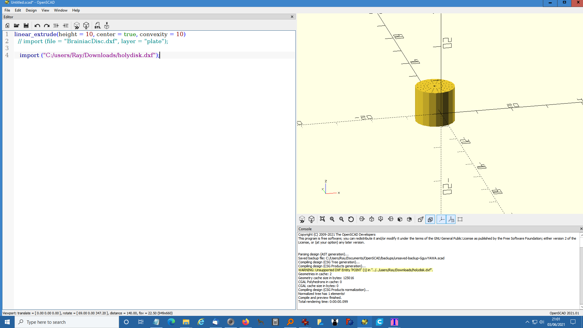

note there is a warning message, and version 2021.01-RC5
On 03/06/2021 20:31, Michele Denber wrote:
linear_extrude(height = 10, center = true, convexity = 10)
   import (file = "BrainiacDisc.dxf", layer = "plate");

Is this the file you are trying to import?
https://content.instructables.com/ORIG/FVW/KRMO/JYOOS8QT/FVWKRMOJYOOS8QT.dxf
If so there is no layer named "plate" in the DXF file.
Remove the  layer="plate" and it will work.
