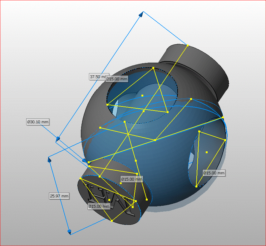

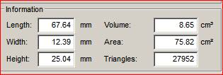

As I said, I use Netfabb Basic, as basic info it gives:
(I imagine there are other tools too)
It also has a measuring system where you can do stuff like:

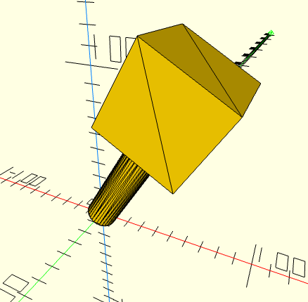

from software design choices, consider a trivial OpenSCAD example:
module main_shape()
cylinder(h=100,r=10);
translate([0,0,100])cube(50,center=true);
rotate([0,30,0])  main_shape();
To obtain the bounding box for the resulting solid object, one must
export to file as discussed.
I had similar needs to obtain bounding box information and therefore
implemented it in my own application (based on the AngelScript language)
where the a) and b) restrictions do not apply. The bounding boxes are
directly available for any solid, primitive or compound, and they can be
queried. The trivial example restated in AngelCAD:
shape@ main_shape()
solid@ cyl  = cylinder(h:100,r:10);
solid@ cub  = translate(0,0,100)cube(50,center:true);
solid@ thing = rotate_y(deg:30)
(cyl + cub);
return print_box(thing);
solid@ print_box(solid@ body)
boundingbox@ box = body.box();
pos3d@ p1 = box.p1();
pos3d@ p2 = box.p2();
cout << "boundingbox: ";
cout << "x=[" << p1.x() << "," << p2.x() << "]  ";
cout << "y=[" << p1.y() << "," << p2.y() << "]  ";
cout << "z=[" << p1.z() << "," << p2.z() << "]  " << endl();
return body;
The script output is
boundingbox: x=[-21.6506,84.1506]  y=[-25,25]  z=[-12.5,120.753]
Note the bounding boxes are computed without performing any boolean
operations on mesh level (mesh booleans are done in a separate
application later, https://github.com/arnholm/xcsg ).
In summary, your mental model is correct given the OpenSCAD design choices.
