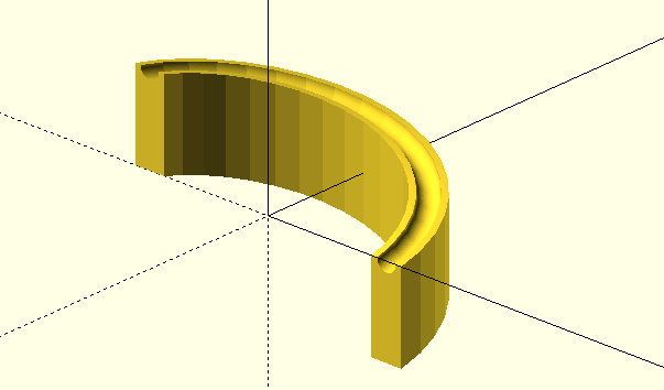

There is no OpenSCAD native operator to get the ramp you intend to model.
You may get the ramp shape using a specific kind of sweep: one that just
translates the sections along a spiral path.
BOSL2 library has the right module to do that. It is called spiral_sweep and
documented here:
https://github.com/revarbat/BOSL2/wiki/skin.scad#functionmodule-spiral_sweep
The code to make your shape might be something like:
height = 20;
poly = move([0,-height/2],difference(
square([7.2,height],center = true),
move([0,height/2,0],circle($fn = 180,  r = 4.5/2))
))[0];
spiral_sweep(poly, h=height, turn=0.5, r=57.5/2, $fn=36);
The polygon calculation above computes a region as the difference() of two
2d shapes and takes the first (the only one) path of it. This polygon might
be computed in other ways.
Certainly, the sweep shape will need to be clipped appropriately.
[image: ramp.PNG]

I'm trying to simulate this knob. I can handle everything but the circular
side with a channel on it.
I can do the flat circular side with the channel, but I cannot figure out
how to do the halt side that has an inclination.
the code I have for the side part it is:
$fn = 360;
outsideChannelFlat();
//channelProfile();
module outsideChannelFlat(){
rotate_extrude(angle = 180, convexity = 2) {
translate([57.5/2,0,0])
channelProfile();
module channelProfile(){
square([7.2,16.5],center = false);
translate([7.2/2,16.5,0])
circle($fn = 180,  r = 4.5/2);
Any help with the inclined part it is welcomed.
