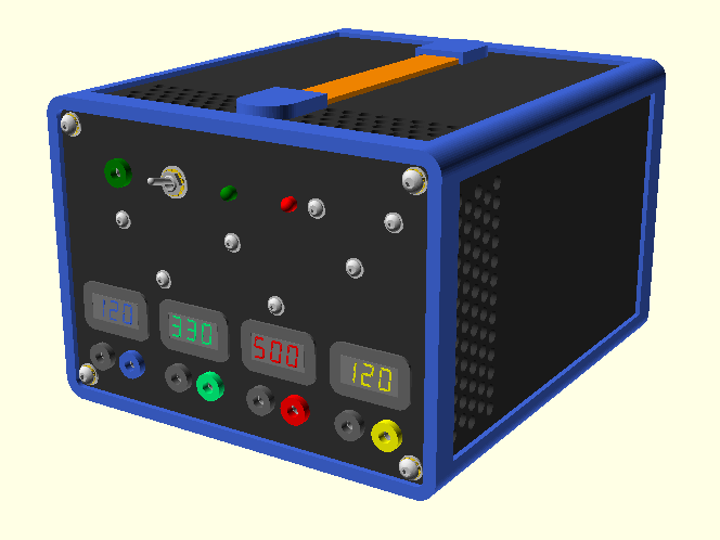

Yes that works around it but the cleanest solutions is with let. I.e.
for(i = [0 : 3])
let($colour = ["royalblue", "springgreen", "red", "yellow"][i], $value
= ["120","330","500","120"][i])
echo($colour, $value);
