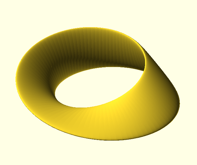

For example, this Möbius strip is made by sweeping an elongated ellipse
along a circle with 180 degrees of twist along the way.
module demo_mobius()
    sweep(path = function(t) [100 * sin(t * 360), 100 * cos(t * 360), 0],
          angle = function(t) t * 180,
          $fn = 100)
        scale([40, 6])    // elliptical cross section
            circle(1);

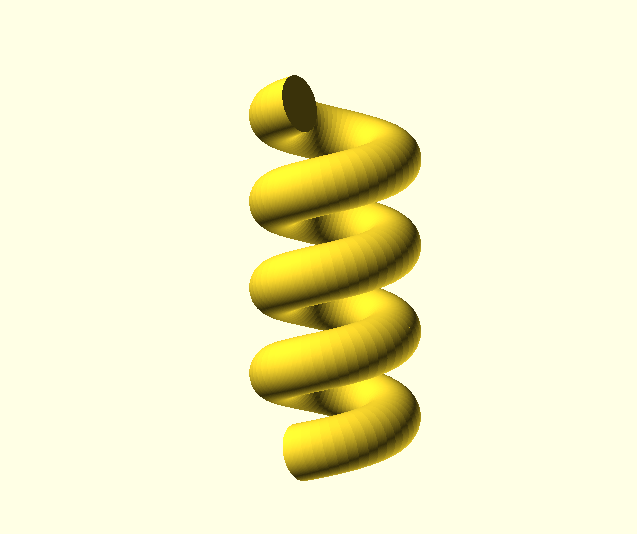

The helix:
helix_path = function(r, h, pitch)
                 function(t) [r * cos(t * 360 * h / pitch),
                              r * sin(t * 360 * h / pitch),
                              h * t];
module helix(r, h, pitch, wire_r)
    sweep(helix_path(r, h, pitch))
        circle(wire_r);
helix(r = 10, h = 60, pitch = 15, wire_r = 5, $fn = 200);

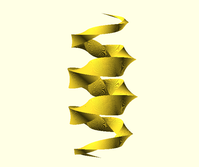

Odd shape made by adding scaling and rotation to the helix, and sweeping
a triangle. It's OK but suffering a Moire effect.
sweep(path = helix_path(r = 10, h = 60, pitch  = 15),
      scale = function(t) 1 - 4 * (t - 0.5) ^ 2,
      angle = function(t) t * 4 * 360,
      $fn = 1500)
    circle(5, $fn = 3);  // triangle

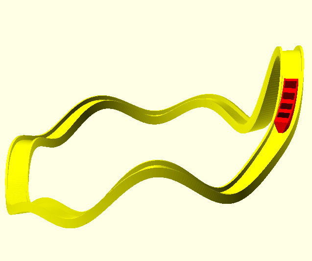

A more complicated thing: Roller coaster using 9 sweeps all along the
same parametric path.
module demo_roller_coaster() {
    module coast(t_start = 0, t_end = 1, scale = function(t) 1, $fn =
500) {
        px = function(t) 60 * cos(t * 360);
        py = function(t) 60 * sin(t * 360);
        pz = function(t) (5 * cos(t * 360 * 7) +
                          10 * cos(t ^ 2 * 360 * 3) -
                          20 * cos(t ^ 4 * 360));
        sweep(function(t) [ px(t), py(t), pz(t) ],
              angle = function(t) 90,
              scale = scale,
              t_start = t_start,
              t_end = t_end)
    color("yellow") {   // track
        coast()  // base
            polygon(points = [[-5, 0], [-5, 2], [5, 2], [5, 0]]);
        coast()  // left rail
            polygon(points = [[-5, 0], [-5, 4], [-4, 4], [-4, 0]]);
        coast()  // right rail
            polygon(points = [[5, 0], [4, 0], [4, 4], [5, 4]]);
    color("red") {   // car
            e = 0.008;
            union() {   // chassis
                ns = 0.747;
                ne = 0.756;
                coast(ns, ne,     // snub nose
                      scale = function(t) (t - ns) / (ne - ns),
                      $fn = 8)
                    polygon(points = [[-3, 3], [-3, 6], [3, 6], [3, 3]]);
                coast(ne, 0.800, $fn = 20)  // body
            w = 2.5;     // seat width
            s = 0.002;   // seat start/end relative to [0.00 : 0.01]
            coast(0.76 + s, 0.76 + e, $fn = 20) // front seat
                polygon(points = [[-w, 3.2], [-w, 6.1], [w, 6.1], [w,
3.2]]);
            coast(0.77 + s, 0.77 + e, $fn = 20)
3.2]]);
            coast(0.78 + s, 0.78 + e, $fn = 20)
3.2]]);
            coast(0.79 + s, 0.79 + e, $fn = 20) // back seat
3.2]]);

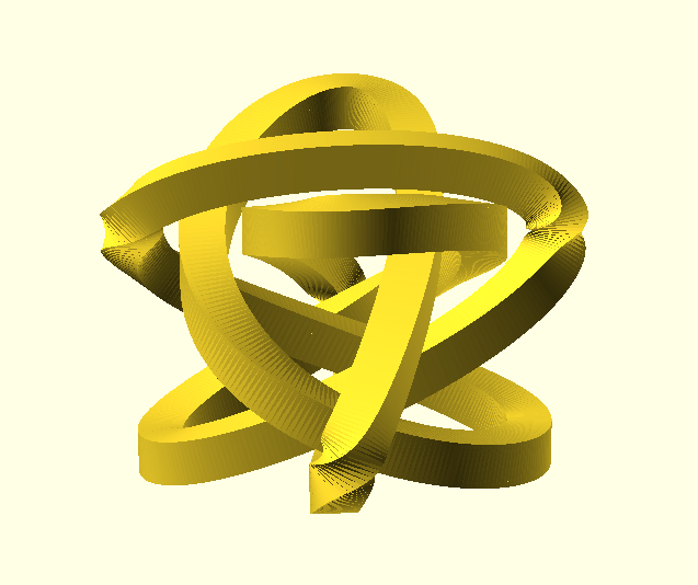

Where I began to realize a fundamental problem was implementing a
Lissajous sweep. I got four unexpected abrupt quarter-twists.
sweep(function(t) [30 * cos(90 + 360 * t * 5),
                   30 * sin(360 * t * 4),
                   30 * cos(360 * t * 3)],
      $fn = 1000)
    square(9, center = true);
So it's apparent that my code isn't properly determining the twist and
needs some tweaking, probably to break it into cases to handle some
direction sensitivities in the atan2 formulas. Either that, or I'm
chasing something impossible.

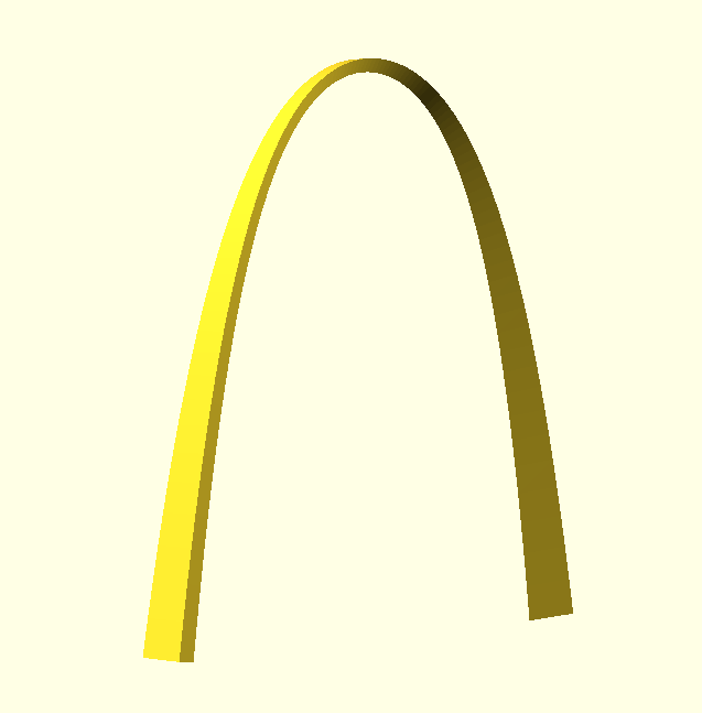

But this problem didn't hamper my accurate scale modeling of the St.
Louis Gateway Arch (1 unit = 1 foot):
module st_louis_gateway_arch()
    let (X_max = 299.2239,
         Y_max = 625.0925,
         A = 68.7672,
         B = 0.0100333,
         cosh = function(x) (exp(x) + exp(-x)) / 2,
         t2x = function(t) (t - 0.5) * 2 * X_max,
         y = function(x) Y_max - A * (cosh(B * x) - 1.0),
         Q = function(x) 1262.6651 - 1.81977 * y(x),
         d = function(q) sqrt(q * 4 / sqrt(3)))
    sweep(path = function(t) [t2x(t), 0, y(t2x(t))],
          scale = function(t) d(Q(t2x(t))),
          angle = function(t) 120,
          $fn = 100)
        circle(sqrt(3) / 3, $fn = 3);   // unit-side triangle

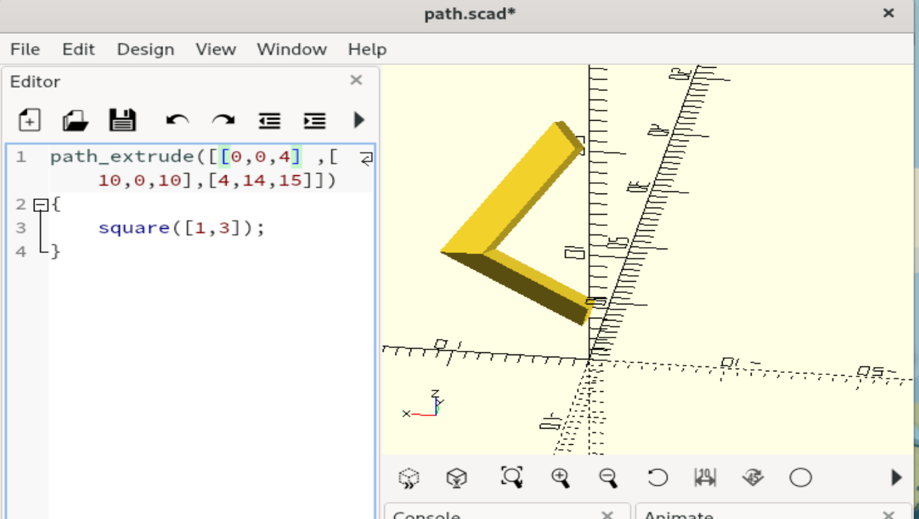

I feel the approach for common users should be such that when a separate
path and section is defined, it should draw the shape.
for example:
path can be an ellipse
section can be a circle
module should be:
sweep(section, path)
defining the shape as you have defined may be a little complicated for
$fn = 100)
circle(1);
The helix:
h * t];
circle(wire_r);
$fn = 1500)
500) {
scale = scale,
t_start = t_start,
t_end = t_end)
     coast()  // base
         e = 0.008;
             ns = 0.747;
             ne = 0.756;
                   $fn = 8)
3.2]]);
3.2]]);
3.2]]);
3.2]]);
$fn = 1000)
direction sensitivities in the atan2 formulas. Either that, or I'm chasing
Y_max = 625.0925,
A = 68.7672,
B = 0.0100333,
$fn = 100)

Guys,
The path_extrude in my fork where previews are available at pythonscad.org
is an openscad-internal solution.
It even works correctly when only using very few slices because the 2D
shape is skewed in  such a way that any perpendicular x-section of the
result
will always be the extruded polygon,  even in corners of the extruded path.
And of course you can extrude any shape...
0],
$fn = 100)
circle(1);
The helix:
h * t];
circle(wire_r);
sweeping a triangle. It's OK but suffering a Moire effect.
$fn = 1500)
500) {
scale = scale,
t_start = t_start,
t_end = t_end)
     coast()  // base
         e = 0.008;
             ns = 0.747;
             ne = 0.756;
                   $fn = 8)
3]]);
3]]);
3.2]]);
3.2]]);
3.2]]);
3.2]]);
$fn = 1000)
Y_max = 625.0925,
A = 68.7672,
B = 0.0100333,
$fn = 100)

Guys, The path_extrude in my fork where previews are available at pythonscad.org is an openscad-internal solution. It even works correctly when only using very few slices because the 2D shape is skewed in such a way that any perpendicular x-section of the result will always be the extruded polygon, even in corners of the extruded path. And of course you can extrude any shape... [image: image.png] On Sun, Mar 3, 2024 at 4:31 AM Sanjeev Prabhakar via Discuss < discuss@lists.openscad.org> wrote: > I know what you are saying here, but it will make things a little complex. > > Once you have a generic path extrude or sweep function, the other > modifications can be implemented. > > A simple path extrude function should be much easier to implement. > > > On Sun, 3 Mar, 2024, 7:39 am Leonard Martin Struttmann via Discuss, < > discuss@lists.openscad.org> wrote: > >> But, what if you wanted to scale and rotate the section along the path? >> Then, instead of just a path, would you then need to specify multiple equal >> length lists? >> >> sweep(section,path,angles,scalings) >> >> Just a thought. >> >> On Sat, Mar 2, 2024 at 7:04 PM Sanjeev Prabhakar via Discuss < >> discuss@lists.openscad.org> wrote: >> >>> I feel the approach for common users should be such that when a separate >>> path and section is defined, it should draw the shape. >>> >>> for example: >>> path can be an ellipse >>> section can be a circle >>> >>> module should be: >>> sweep(section, path) >>> >>> defining the shape as you have defined may be a little complicated for >>> different users (at least for me). >>> >>> >>> On Sun, 3 Mar 2024 at 02:20, Curt McDowell via Discuss < >>> discuss@lists.openscad.org> wrote: >>> >>>> The discussion about generating a helix with linear extrude led me to >>>> explore path sweeping. I came up with this very general module, done using >>>> native modules and functions alone (i.e. without "cheating" by using >>>> polyhedron and raw data points). >>>> >>>> // Generalized module to sweep a 2D object where the path, >>>> // scale and angle are parameterized functions of t (0 .. 1). >>>> // Since hull() is used, the 2D object must be simple and convex. >>>> >>>> module sweep(path, >>>> scale = function(t) 1, >>>> angle = function(t) 0, >>>> t_start = 0.0, >>>> t_end = 1.0, >>>> $epsilon = 1.0e-4) { >>>> dt = (t_end - t_start) / $fn; >>>> module slice(t) { >>>> p = path(t); >>>> n = path(t + dt) - p; >>>> translate(p) >>>> rotate([0, >>>> 90 - atan2(n.z, sqrt(n.x ^ 2 + n.y ^ 2)), >>>> atan2(n.y, n.x)]) >>>> scale(max(scale(t), $epsilon)) >>>> linear_extrude($epsilon) >>>> rotate(angle(t)) >>>> children(); >>>> } >>>> for (s = [0 : $fn - 1]) >>>> hull() { >>>> slice(t_start + s * dt) >>>> children(); >>>> // Extra bit of thickness helps layers overlap >>>> slice(t_start + (s + 1 + $epsilon) * dt) >>>> children(); >>>> } >>>> } >>>> >>>> For example, this Möbius strip is made by sweeping an elongated ellipse >>>> along a circle with 180 degrees of twist along the way. >>>> >>>> module demo_mobius() >>>> sweep(path = function(t) [100 * sin(t * 360), 100 * cos(t * 360), >>>> 0], >>>> angle = function(t) t * 180, >>>> $fn = 100) >>>> scale([40, 6]) // elliptical cross section >>>> circle(1); >>>> >>>> The helix: >>>> >>>> helix_path = function(r, h, pitch) >>>> function(t) [r * cos(t * 360 * h / pitch), >>>> r * sin(t * 360 * h / pitch), >>>> h * t]; >>>> >>>> module helix(r, h, pitch, wire_r) >>>> sweep(helix_path(r, h, pitch)) >>>> circle(wire_r); >>>> >>>> helix(r = 10, h = 60, pitch = 15, wire_r = 5, $fn = 200); >>>> >>>> Odd shape made by adding scaling and rotation to the helix, and >>>> sweeping a triangle. It's OK but suffering a Moire effect. >>>> >>>> sweep(path = helix_path(r = 10, h = 60, pitch = 15), >>>> scale = function(t) 1 - 4 * (t - 0.5) ^ 2, >>>> angle = function(t) t * 4 * 360, >>>> $fn = 1500) >>>> circle(5, $fn = 3); // triangle >>>> >>>> A more complicated thing: Roller coaster using 9 sweeps all along the >>>> same parametric path. >>>> >>>> module demo_roller_coaster() { >>>> module coast(t_start = 0, t_end = 1, scale = function(t) 1, $fn = >>>> 500) { >>>> px = function(t) 60 * cos(t * 360); >>>> py = function(t) 60 * sin(t * 360); >>>> pz = function(t) (5 * cos(t * 360 * 7) + >>>> 10 * cos(t ^ 2 * 360 * 3) - >>>> 20 * cos(t ^ 4 * 360)); >>>> sweep(function(t) [ px(t), py(t), pz(t) ], >>>> angle = function(t) 90, >>>> scale = scale, >>>> t_start = t_start, >>>> t_end = t_end) >>>> children(); >>>> } >>>> >>>> color("yellow") { // track >>>> coast() // base >>>> polygon(points = [[-5, 0], [-5, 2], [5, 2], [5, 0]]); >>>> coast() // left rail >>>> polygon(points = [[-5, 0], [-5, 4], [-4, 4], [-4, 0]]); >>>> coast() // right rail >>>> polygon(points = [[5, 0], [4, 0], [4, 4], [5, 4]]); >>>> } >>>> >>>> color("red") { // car >>>> difference() { >>>> e = 0.008; >>>> union() { // chassis >>>> ns = 0.747; >>>> ne = 0.756; >>>> coast(ns, ne, // snub nose >>>> scale = function(t) (t - ns) / (ne - ns), >>>> $fn = 8) >>>> polygon(points = [[-3, 3], [-3, 6], [3, 6], [3, >>>> 3]]); >>>> coast(ne, 0.800, $fn = 20) // body >>>> polygon(points = [[-3, 3], [-3, 6], [3, 6], [3, >>>> 3]]); >>>> } >>>> w = 2.5; // seat width >>>> s = 0.002; // seat start/end relative to [0.00 : 0.01] >>>> coast(0.76 + s, 0.76 + e, $fn = 20) // front seat >>>> polygon(points = [[-w, 3.2], [-w, 6.1], [w, 6.1], [w, >>>> 3.2]]); >>>> coast(0.77 + s, 0.77 + e, $fn = 20) >>>> polygon(points = [[-w, 3.2], [-w, 6.1], [w, 6.1], [w, >>>> 3.2]]); >>>> coast(0.78 + s, 0.78 + e, $fn = 20) >>>> polygon(points = [[-w, 3.2], [-w, 6.1], [w, 6.1], [w, >>>> 3.2]]); >>>> coast(0.79 + s, 0.79 + e, $fn = 20) // back seat >>>> polygon(points = [[-w, 3.2], [-w, 6.1], [w, 6.1], [w, >>>> 3.2]]); >>>> } >>>> } >>>> } >>>> >>>> Where I began to realize a fundamental problem was implementing a >>>> Lissajous sweep. I got four unexpected abrupt quarter-twists. >>>> >>>> sweep(function(t) [30 * cos(90 + 360 * t * 5), >>>> 30 * sin(360 * t * 4), >>>> 30 * cos(360 * t * 3)], >>>> $fn = 1000) >>>> square(9, center = true); >>>> >>>> So it's apparent that my code isn't properly determining the twist and >>>> needs some tweaking, probably to break it into cases to handle some >>>> direction sensitivities in the atan2 formulas. Either that, or I'm chasing >>>> something impossible. >>>> >>>> But this problem didn't hamper my accurate scale modeling of the St. >>>> Louis Gateway Arch (1 unit = 1 foot): >>>> >>>> module st_louis_gateway_arch() >>>> let (X_max = 299.2239, >>>> Y_max = 625.0925, >>>> A = 68.7672, >>>> B = 0.0100333, >>>> cosh = function(x) (exp(x) + exp(-x)) / 2, >>>> t2x = function(t) (t - 0.5) * 2 * X_max, >>>> y = function(x) Y_max - A * (cosh(B * x) - 1.0), >>>> Q = function(x) 1262.6651 - 1.81977 * y(x), >>>> d = function(q) sqrt(q * 4 / sqrt(3))) >>>> sweep(path = function(t) [t2x(t), 0, y(t2x(t))], >>>> scale = function(t) d(Q(t2x(t))), >>>> angle = function(t) 120, >>>> $fn = 100) >>>> circle(sqrt(3) / 3, $fn = 3); // unit-side triangle >>>> >>>> The way Fusion 360 does it might be better. Instead of specifying >>>> functions for path, scale and angle, the user specifies a path and a >>>> "rail". The rail is essentially another path vaguely parallel to the >>>> original, that the edge of the object stays attached to, dictating both the >>>> scaling and rotation unambiguously. >>>> >>>> Regards, >>>> Curt >>>> _______________________________________________ >>>> OpenSCAD mailing list >>>> To unsubscribe send an email to discuss-leave@lists.openscad.org >>>> >>> _______________________________________________ >>> OpenSCAD mailing list >>> To unsubscribe send an email to discuss-leave@lists.openscad.org >>> >> _______________________________________________ >> OpenSCAD mailing list >> To unsubscribe send an email to discuss-leave@lists.openscad.org >> > _______________________________________________ > OpenSCAD mailing list > To unsubscribe send an email to discuss-leave@lists.openscad.org >
0],
$fn = 100)
circle(1);
The helix:
h * t];
circle(wire_r);
$fn = 1500)
500) {
scale = scale,
t_start = t_start,
t_end = t_end)
     coast()  // base
         e = 0.008;
             ns = 0.747;
             ne = 0.756;
                   $fn = 8)
3]]);
3]]);
$fn = 1000)
Y_max = 625.0925,
A = 68.7672,
B = 0.0100333,
$fn = 100)

Not everyone uses the libraries and many prefer only native openSCAD.
This is my personal view to incorporate some useful functions like
path_extrude etc to openSCAD without any support from any library.
On Sun, 3 Mar 2024 at 19:11, jon jon@jonbondy.com wrote:
But these have been implemented many, many times before, and are
available in libraries.  Why are you reinventing the wheel?  For fun?
complex.
ellipse along a circle with 180 degrees of twist along the way.
0],
$fn = 100)
circle(1);
The helix:
h * t];
circle(wire_r);
$fn = 1500)
500) {
scale = scale,
t_start = t_start,
t_end = t_end)
     coast()  // base
         e = 0.008;
             ns = 0.747;
             ne = 0.756;
                   $fn = 8)
3]]);
3]]);
3.2]]);
3.2]]);
3.2]]);
3.2]]);
$fn = 1000)
Y_max = 625.0925,
A = 68.7672,
B = 0.0100333,
$fn = 100)
