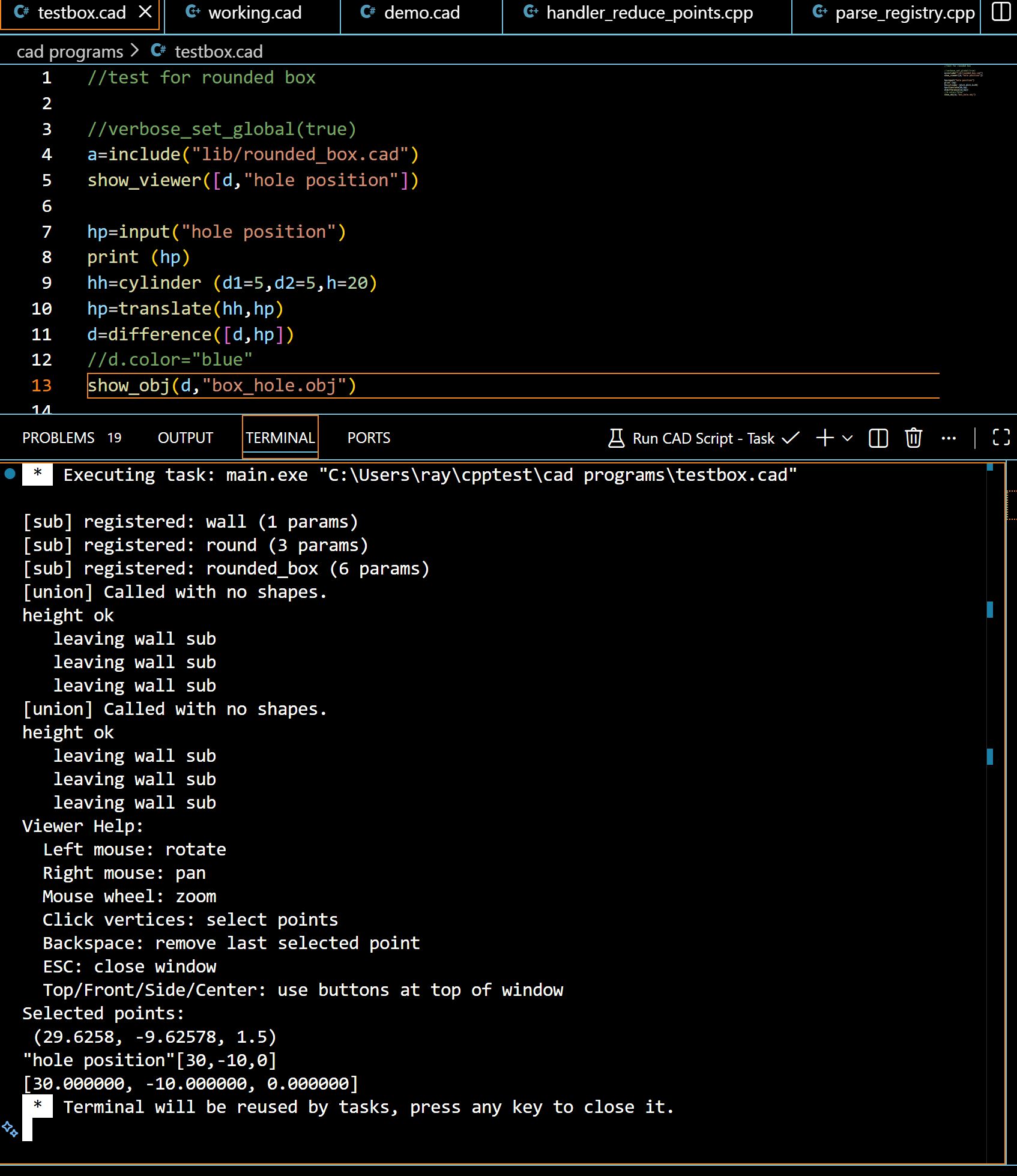

Anyway, the show_viewertest jpg, shows my code (the coloured text at the
top), the bottom white text is the terminal window. The show_viewer can
post text (questions) like "select three points on a line", and I click
on the points I want. I have it so it returns the points to the
terminal, under "selected points". The cad program then asks for input,
so I  copy the values I want, or adjust them, (one point in the example)
then in this example the code puts a hole in that position.

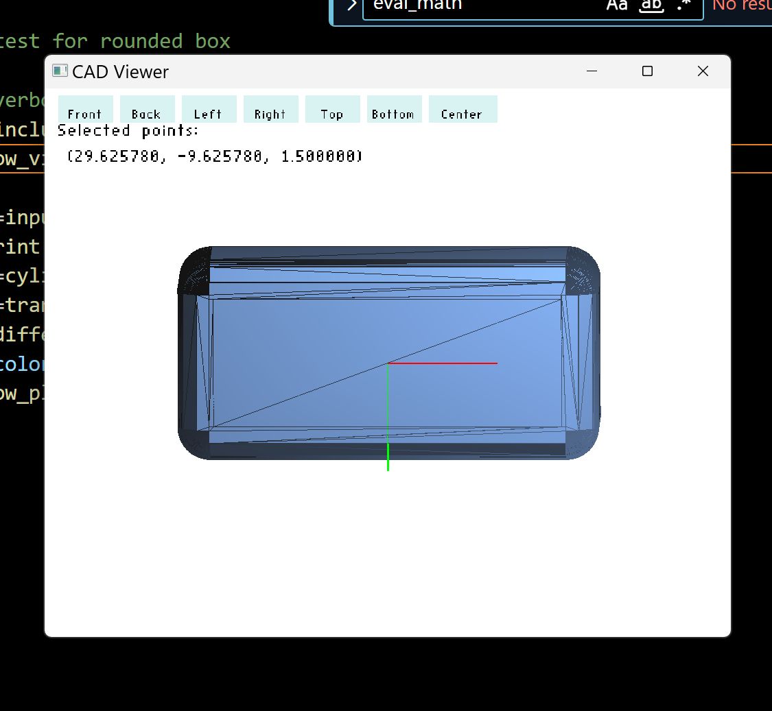

The rounded box.jpg, is a screen shot of the viewer. The terminal gives
some help, but more detailed help will be available. The text is a small
bit-mapped library, not very clear, but good enough.
This graphics type stuff is tricky to deal with in this AI, since it
cannot 'see' the results. But it gets there in the end, if you poke it
hard enough.
At the moment, the mouse only selects existing points, so for example,
it will not select the centre of the base of the box.
