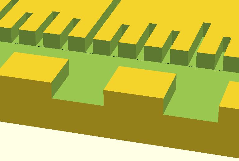

In your model, before my changes, this manifests along the front
(smallest Y) edge, where the negative larger tick marks exactly line up
with the front of the ruler.
This exact behavior is well-known.  The workaround is to ensure that the
negative object extends at least a little outside the thing it is being
subtracted from.  Tiny values work, but I usually use 1 because it's
easy to type and it's very rare that I would be adding a constant 1 or
translating by a constant 1.  Some people prefer to use a variable named
"epsilon" or "eps".
Thus my first change was to move that square one unit in the -Y
direction and make it one unit longer so that the other end is in the
same place.
        xcopies(mk4,l=len-4, sp=[0,-6,0]) fwd(1) square([3,1+3]) ;
That got rid of the Z-fighting at the front:

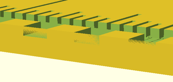

From certain angles, you'll see another well-known preview artifact.
Ref
https://en.wikibooks.org/wiki/OpenSCAD_User_Manual/FAQ#Why_are_some_parts_(e.g._holes)_of_the_model_not_rendered_correctly?
This one is a "convexity" artifact.  For some reason that I have never
bothered to understand, the previewer wants to know how many times a
line can cross into and out of the model.  For many operations it can
figure this out on its own, but when you linear-extrude a concave shape,
or when you build your own polyhedron, or a few other cases, it has no
idea and you need to tell it.  The theoretical number for this model is
somewhere around 64, I think, drawing a line parallel to the X axis
through the small tick marks.  However, I can't find an angle where I
can see it there.  Even along the thick tick marks, the theoretical
number is around 16, but it's hard to get an angle where it's more than
about 5.  This is purely a preview artifact; the workaround is to
recognize the symptom, recognize constructs that cause it, and set
"convexity=" some number, in the linear_extrude in this case.  I usually
use 10, because that's almost always enough.  Making it larger has a
very slight performance cost when viewing the model, but it's hard to
get cases where the cost is visible.

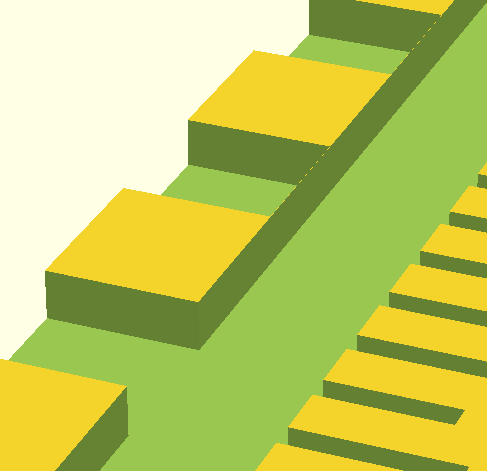

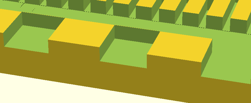

Now we're out of the known stuff, and into something weird.  There is a
very odd artifact; some of the large tick marks still have something odd
going on at their back ends...
This looks Escher-esque; the two cutouts at the left appear to have
solid behind them with the top at the same level as the yellow parts,
but then when you follow that to the right it's back down at the cutout
level.
TL;DR:  looks like a bug in the 2D subsystem.  Work around it by
extending the square further into +Y.

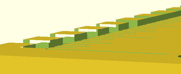

Turning around to a different angle makes it a little clearer:

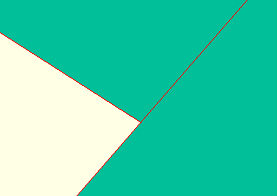

There seems to be a microscopically thin wall between the tick-mark
cutouts and the large cutout.
Extending the square a bit more +Y makes the problem go away.

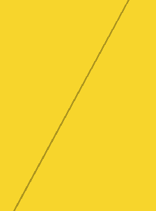

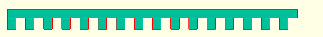

Putting a ! in front of the union() to get just the 2D object, and
zooming way, way in, shows a very small dividing line.  I can only see
it at some angles, and only in perspective mode.

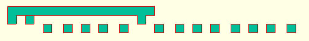

But it shows up clearly in a render of the 2D object:
The render shows that it is there on most, but not all, of the tick marks:
The previewer shows it on fewer, but that could just be because it was
hard to see even on the ones it did show.
This sure seems like a bug in the 2D subsystem.  I would have guessed
that it was a floating point accuracy problem, but I'm able to reproduce
it using only integers so that's unlikely.  I dumped the CSG tree for
this figure, chopped out all of the noise, turned the multmatrix calls
back into translate() calls, and simplified as much as I could.
This is the simplest variant I have come up with that demonstrates the
problem.  It demonstrates it only on one square.
square([50, 3]);
translate([0, -3])
square(3);
translate([6, -3])
square(3);
translate([12, -6])
square(3);
translate([19, -6])
square(3);
translate([25, -6])
square(3);
translate([31,-6])
square(3);
translate([38,-6])
square(3);
translate([44, -3])  // Note this one is -3
square(3);
translate([50, -6])
square(3);
translate([57,-6])
square(3);
translate([63,-6])
square(3);
translate([69,-6])
square(3);
translate([76, -6])
square(3);
translate([82,-6])
square(3);
translate([88,-6])
square(3);
translate([95,-6])
square(3);
Removing any of the squares makes the problem go away.  Moving any of
the three "attached" squares away from the top makes it go away.  Moving
the "loose" squares around does not seem to affect the problem.
I've filed issue #5478 https://github.com/openscad/openscad/issues/5478.
Net:  two well-known artifacts, one really weird and
difficult-to-trigger bug.
Putting a ! in front of the union() to get just the 2D object, and zooming
way, way in, shows a very small dividing line.  I can only see it at some
This sure seems like a bug in the 2D subsystem.  I would have guessed that
it was a floating point accuracy problem, but I'm able to reproduce it
using only integers so that's unlikely.  I dumped the CSG tree for this
figure, chopped out all of the noise, turned the multmatrix calls back into

Removing any of the squares makes the problem go away.  Moving any of the
three "attached" squares away from the top makes it go away.  Moving the
Net:  two well-known artifacts, one really weird and difficult-to-trigger
bug.
