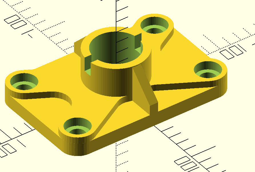

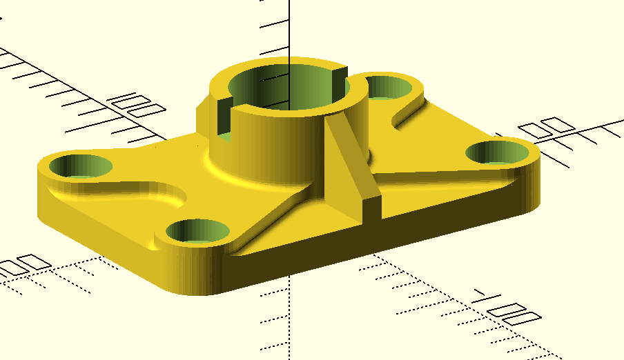

Recently a design challenge was posted:
https://old.reddit.com/r/openscad/comments/1fk0kpc/design_challenge_24wc02_foot_pad/
and it was of course quick/easy to do up to a point:
https://www.blockscad3d.com/community/projects/1815717
(click on "Create my own")
or see:
https://github.com/WillAdams/Design_Into_3D/blob/master/24WC-02-FOOT%20PAD.scad
but the fillets required more trigonometry than was easily done.
Is there some module/library which has an elegant approach to filling in such? Ideally an approach which can use either a triangular positioning, or position it relative to the intersection of a triangle and a circle/cylinder?

here is my version:
[image: Screenshot 2024-09-24 at 8.37.28 PM.png]
code in python:

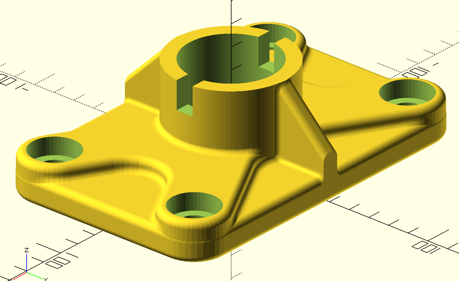

here is my version: [image: Screenshot 2024-09-24 at 8.37.28 PM.png] code in python: from openscad2 import * sec=pts([[-155/2,-101/2],[155,0],[0,101],[-155,0]]) rl=[15,15,15,15] sec=corner_n_radius_list(sec,rl,10) l1=norm(cp_arc(sec[:10])) a=cp_arc(sec[:10]) theta=r2d(arctan(a[1]/a[0])) l2=[q_rot2d(i,[[0,0],[l1,0]]) for i in [theta,180-theta,180+theta,-theta]] l3=[surround(p,15) for p in l2] c1=circle(55/2,s=100) la,lb,lc=seg(l3[0])[-1],seg(l3[-1])[20],seg(l3[-2])[-1] a1=fillet_intersection_lines(flip(la),lb,15) a2=c32(mirror(c23(a1),[1,0,0],[0,0,0])) a3=fillet_line_circle(lc,c1,15,1) a4=c32(mirror(c23(a3),[1,0,0],[0,0,0])) a5=c32(mirror(c23(a3),[0,1,0],[0,0,0])) a6=c32(mirror(c23(a4),[0,1,0],[0,0,0])) sec1=flip(a1)+l3[0][:21]+a6+arc_2p(a6[-1],a5[-1],55/2,-1)+flip(a5)+l3[1][21:]+a2 \ +l3[2][21:]+a3+arc_2p(a3[-1],a4[-1],55/2,-1)+flip(a4)+l3[-1][:21] sol1=linear_extrude(sec1,18) sol2=linear_extrude(sec,12) sol3=linear_extrude(circle(55/2,s=100),45) sol3_1=translate([0,0,-1],linear_extrude(circle(42/2,s=100),47)) csnk=translate([0,0,10],linear_extrude(circle(22/2,a),11)) csnk1=mirror_surface(csnk,[0,1,0],[0,0,0]) csnk2=mirror_surface(csnk,[1,0,0],[0,0,0]) csnk3=mirror_surface(csnk1,[1,0,0],[0,0,0]) td=translate([0,0,-1],linear_extrude(circle(14/2,a),20)) td1=mirror_surface(td,[0,1,0],[0,0,0]) td2=mirror_surface(td,[1,0,0],[0,0,0]) td3=mirror_surface(td1,[1,0,0],[0,0,0]) slot=o_solid([0,1,0],pts([[-30,0],[60,0],[0,20],[-60,0]]),8,-4,0,32) l4=axis_rot_1([[0,-101/2,21],[0,101/2,21]],[1,0,0],[0,-101/2,21],45) l4=lineFromStartTillPoint(l4,.33) l5=[[-4,-101/2,21],[4,-101/2,21]] s1=surface_line_vector(l5,a_(l4)[1]-a_(l4)[0]) sol4=surf_base(s1,0) sol5=mirror_surface(sol4,[0,1,0],[0,0,0]) with open('trial.scad','w+') as f: f.write(f''' include<dependencies2.scad> // color("blue")p_line3dc({sec},.5,1); // color("magenta")for(p={l3})p_line3dc(p,.3,1); // color("green")p_line3dc({c1},.3,1); // color("cyan")p_line3d({l4},1,1); // color("violet")for(p={[a1,a2,a3,a4,a5,a6]})p_line3d(p,.5,1); difference(){{ union(){{ {swp(sol1)} {swp(sol2)} {swp(sol3)} {swp(sol4)} {swp(sol5)} }} for(p={[csnk,flip(csnk1),flip(csnk2),csnk3]})swp(p); for(p={[td,flip(td1),flip(td2),td3]})swp(p); {swp(slot)} {swp(sol3_1)} }} ''') On Tue, 24 Sept 2024 at 07:36, Sanjeev Prabhakar <sprabhakar2006@gmail.com> wrote: > In python it won't be too tough. > Will try once I get some time. > > On Mon, 23 Sept, 2024, 7:07 pm William F. Adams via Discuss, < > discuss@lists.openscad.org> wrote: > >> Recently a design challenge was posted: >> >> >> https://old.reddit.com/r/openscad/comments/1fk0kpc/design_challenge_24wc02_foot_pad/ >> >> and it was of course quick/easy to do up to a point: >> >> https://www.blockscad3d.com/community/projects/1815717 >> >> (click on "Create my own") >> >> or see: >> >> >> https://github.com/WillAdams/Design_Into_3D/blob/master/24WC-02-FOOT%20PAD.scad >> >> but the fillets required more trigonometry than was easily done. >> >> Is there some module/library which has an elegant approach to filling in >> such? Ideally an approach which can use either a triangular positioning, or >> position it relative to the intersection of a triangle and a >> circle/cylinder? >> >> William >> _______________________________________________ >> OpenSCAD mailing list >> To unsubscribe send an email to discuss-leave@lists.openscad.org >> >
Tue, Sep 24, 2024 4:31 PM
fillets can be added as below
[image: Screenshot 2024-09-24 at 9.59.35 PM.png]

fillets can be added as below [image: Screenshot 2024-09-24 at 9.59.35 PM.png] On Tue, 24 Sept 2024 at 20:42, Sanjeev Prabhakar <sprabhakar2006@gmail.com> wrote: > here is my version: > > [image: Screenshot 2024-09-24 at 8.37.28 PM.png] > > code in python: > > from openscad2 import * > sec=pts([[-155/2,-101/2],[155,0],[0,101],[-155,0]]) > rl=[15,15,15,15] > sec=corner_n_radius_list(sec,rl,10) > l1=norm(cp_arc(sec[:10])) > a=cp_arc(sec[:10]) > theta=r2d(arctan(a[1]/a[0])) > l2=[q_rot2d(i,[[0,0],[l1,0]]) for i in [theta,180-theta,180+theta,-theta]] > l3=[surround(p,15) for p in l2] > c1=circle(55/2,s=100) > la,lb,lc=seg(l3[0])[-1],seg(l3[-1])[20],seg(l3[-2])[-1] > a1=fillet_intersection_lines(flip(la),lb,15) > a2=c32(mirror(c23(a1),[1,0,0],[0,0,0])) > a3=fillet_line_circle(lc,c1,15,1) > a4=c32(mirror(c23(a3),[1,0,0],[0,0,0])) > a5=c32(mirror(c23(a3),[0,1,0],[0,0,0])) > a6=c32(mirror(c23(a4),[0,1,0],[0,0,0])) > sec1=flip(a1)+l3[0][:21]+a6+arc_2p(a6[-1],a5[-1],55/2,-1)+flip(a5)+l3[1][21:]+a2 > \ > +l3[2][21:]+a3+arc_2p(a3[-1],a4[-1],55/2,-1)+flip(a4)+l3[-1][:21] > > sol1=linear_extrude(sec1,18) > sol2=linear_extrude(sec,12) > sol3=linear_extrude(circle(55/2,s=100),45) > sol3_1=translate([0,0,-1],linear_extrude(circle(42/2,s=100),47)) > > csnk=translate([0,0,10],linear_extrude(circle(22/2,a),11)) > csnk1=mirror_surface(csnk,[0,1,0],[0,0,0]) > csnk2=mirror_surface(csnk,[1,0,0],[0,0,0]) > csnk3=mirror_surface(csnk1,[1,0,0],[0,0,0]) > > td=translate([0,0,-1],linear_extrude(circle(14/2,a),20)) > td1=mirror_surface(td,[0,1,0],[0,0,0]) > td2=mirror_surface(td,[1,0,0],[0,0,0]) > td3=mirror_surface(td1,[1,0,0],[0,0,0]) > > slot=o_solid([0,1,0],pts([[-30,0],[60,0],[0,20],[-60,0]]),8,-4,0,32) > > l4=axis_rot_1([[0,-101/2,21],[0,101/2,21]],[1,0,0],[0,-101/2,21],45) > l4=lineFromStartTillPoint(l4,.33) > l5=[[-4,-101/2,21],[4,-101/2,21]] > s1=surface_line_vector(l5,a_(l4)[1]-a_(l4)[0]) > sol4=surf_base(s1,0) > sol5=mirror_surface(sol4,[0,1,0],[0,0,0]) > with open('trial.scad','w+') as f: > f.write(f''' > include<dependencies2.scad> > // color("blue")p_line3dc({sec},.5,1); > // color("magenta")for(p={l3})p_line3dc(p,.3,1); > // color("green")p_line3dc({c1},.3,1); > // color("cyan")p_line3d({l4},1,1); > // color("violet")for(p={[a1,a2,a3,a4,a5,a6]})p_line3d(p,.5,1); > difference(){{ > union(){{ > {swp(sol1)} > {swp(sol2)} > {swp(sol3)} > {swp(sol4)} > {swp(sol5)} > }} > for(p={[csnk,flip(csnk1),flip(csnk2),csnk3]})swp(p); > for(p={[td,flip(td1),flip(td2),td3]})swp(p); > {swp(slot)} > {swp(sol3_1)} > }} > ''') > > On Tue, 24 Sept 2024 at 07:36, Sanjeev Prabhakar <sprabhakar2006@gmail.com> > wrote: > >> In python it won't be too tough. >> Will try once I get some time. >> >> On Mon, 23 Sept, 2024, 7:07 pm William F. Adams via Discuss, < >> discuss@lists.openscad.org> wrote: >> >>> Recently a design challenge was posted: >>> >>> >>> https://old.reddit.com/r/openscad/comments/1fk0kpc/design_challenge_24wc02_foot_pad/ >>> >>> and it was of course quick/easy to do up to a point: >>> >>> https://www.blockscad3d.com/community/projects/1815717 >>> >>> (click on "Create my own") >>> >>> or see: >>> >>> >>> https://github.com/WillAdams/Design_Into_3D/blob/master/24WC-02-FOOT%20PAD.scad >>> >>> but the fillets required more trigonometry than was easily done. >>> >>> Is there some module/library which has an elegant approach to filling in >>> such? Ideally an approach which can use either a triangular positioning, or >>> position it relative to the intersection of a triangle and a >>> circle/cylinder? >>> >>> William >>> _______________________________________________ >>> OpenSCAD mailing list >>> To unsubscribe send an email to discuss-leave@lists.openscad.org >>> >>

I have spent some more time on this today and this looks quite a perfect
rounding.
[image: Screenshot 2024-09-26 at 8.57.15 PM.png]
I have spent some more time on this today and this looks quite a perfect rounding. [image: Screenshot 2024-09-26 at 8.57.15 PM.png] > >>>> _______________________________________________ >>>> OpenSCAD mailing list >>>> To unsubscribe send an email to discuss-leave@lists.openscad.org >>>> >>>
GS
Guenther Sohler
Thu, Sep 26, 2024 8:23 PM
Hi Sanjeev,
It actually looks like a real life item, which  could serve a real-life
problem!
I am just wondering: aren't the top level and the bottom level of the front
right hole supposed to be coplanar? neither of them have a rounding
From Experience I know, that you create the the concave edge roundings by
ADDING  a special shaped solid(like rail of soldering iron)  which is
butting to both walls and floors.
just generally questioning the concept, because modern CSG engines have
problems to button faces and would rather prefer overlapping solids.
Plan to add tangents to pythonSCAD soon. its a feature which is needed on
daily basis.

Draft angle of 1 ~ 1.5 degrees need to be provided for easy ejection of the
part from the mould which is missing in this case and also still there are
2 sharp edges which needs rounding. You can not cast sharp corners.
