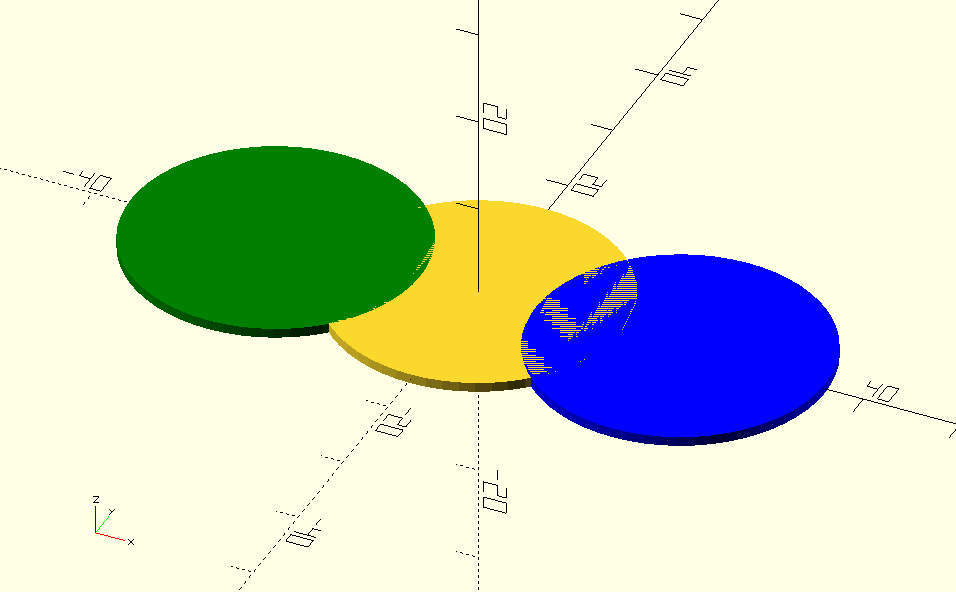

The points on the yellow tile should be on the corners of a square, so I
think you need ot replace 1.4 with sqrt(2), which is ~1.41.

$fn = 60;
dia = 15;
t_factor = 1.4;
circle(dia);
translate([t_factor * dia, 0, 0])
color("blue")
circle(dia);
translate([-t_factor * dia, 0, 0])
color("green")
circle(dia);
[image: Inline image]
I've not performed any tests on the current t_factor (translate factor) as
it's more-or-less a rough eyeball guess. I've forgotten most of my high
school trigonometry/geometry (last century) and am not certain that what I
knew would help me here.
I'd like to know what formula to use to calculate the x-translation that
results in the green and blue circles to split the yellow circle's
circumference into quarters. The final objective is to create a shape which
when duplicated and rotated will be tiled without gaps.

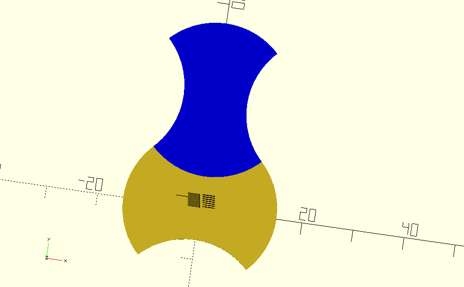

This is the shape which results from using sqrt(2) as the translation
factor. I expect that this is the correct answer, but I only stumbled on
it. It's been my experience that sometimes a calculation falls into one of
the "standard" references in the world.
Can someone explain the development that would confirm this as the correct
calculation?
