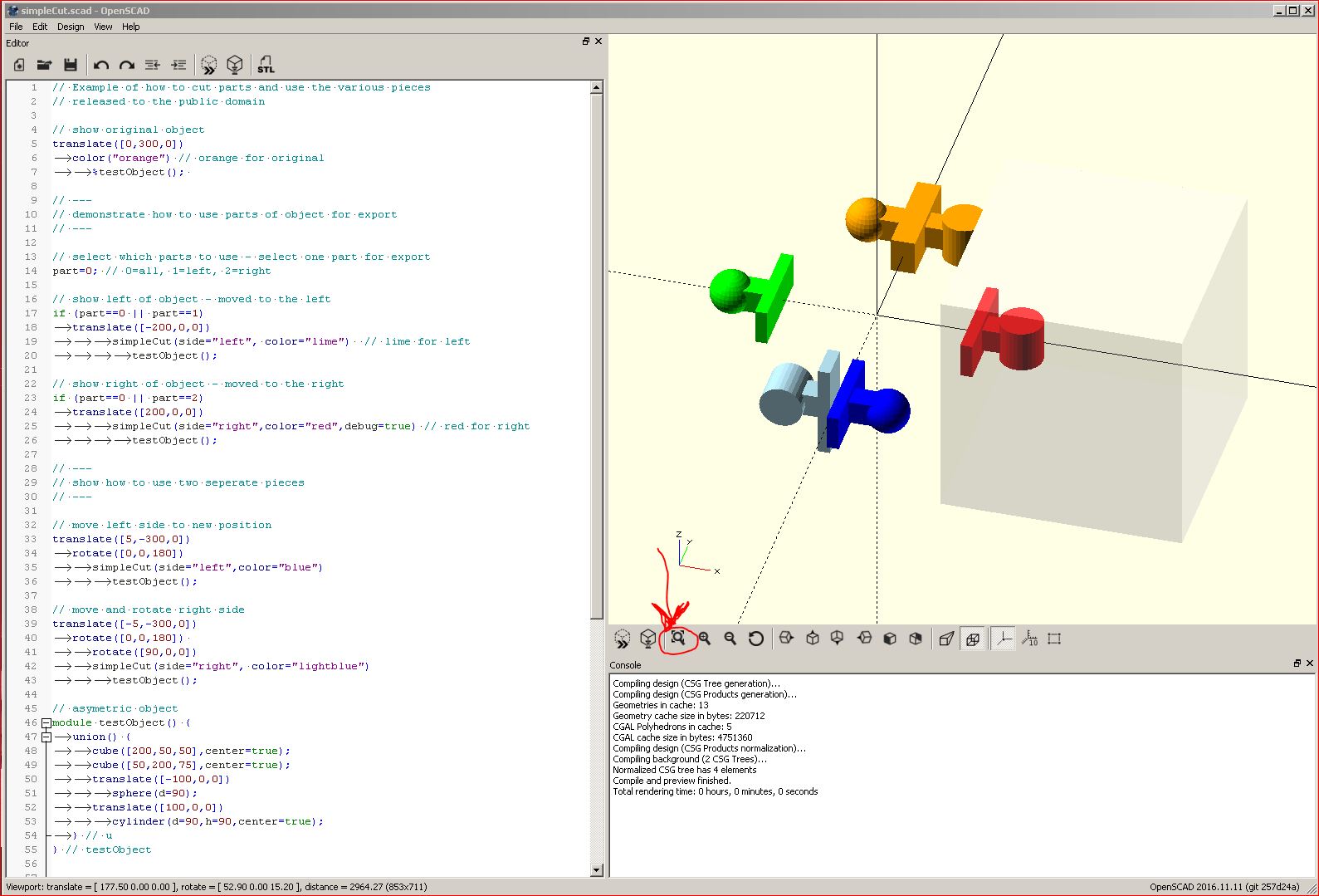

I Copy Pasted Your Example and got nothing rendered, shuld not there be
something more?
On Tue, Jan 3, 2017 at 3:42 AM, MichaelAtOz [via OpenSCAD] <
ml-node+s1091067n19878h24@n5.nabble.com> wrote:
Marijan Pollak wrote
I just do not know how to separate cut pieces and export just one that is
ready for 3D printing.
However it would be usefull sometimes to be able to pick some cut pieces
and
rejoin them.
This example shows how:
// Example of how to cut parts and use the various pieces
// released to the public domain
// show original object
translate([0,300,0])
color("orange") // orange for original
%testObject();
// demonstrate how to use parts of object for export
// select which parts to use - select one part for export
part=0; // 0=all, 1=left, 2=right
// show left of object - moved to the left
if (part==0 || part==1)
translate([-200,0,0])
simpleCut(side="left", color="lime")  // lime for
left
testObject();
// show right of object - moved to the right
if (part==0 || part==2)
translate([200,0,0])
simpleCut(side="right",color="red",debug=true) //
red for right
testObject();
// show how to use two seperate pieces
// move left side to new position
translate([5,-300,0])
rotate([0,0,180])
simpleCut(side="left",color="blue")
testObject();
// move and rotate right side
translate([-5,-300,0])
rotate([0,0,180])
rotate([90,0,0])
simpleCut(side="right", color="lightblue")
testObject();

Michael Marx
Sat, Jan 7, 2017 5:24 AM
You will need to zoom out, sorry about that.
Click this button:
From: Discuss [mailto:discuss-bounces@lists.openscad.org] On Behalf Of Marijan Pollak
Sent: Saturday, 7 January 2017 5:54 AM
Subject: Re: [OpenSCAD] Export Stl. File module
I Copy Pasted Your Example and got nothing rendered, shuld not there be something more?
On Tue, Jan 3, 2017 at 3:42 AM, MichaelAtOz [via OpenSCAD] <[hidden email]> wrote:
%testObject();
simpleCut(side="left", color="lime")  // lime for left
testObject();
simpleCut(side="right",color="red",debug=true) // red for right
testObject();
rotate([0,0,180])
testObject();
rotate([0,0,180])
rotate([90,0,0])
testObject();
// asymetric object
module testObject() {
cube([200,50,50],center=true);
cube([50,200,75],center=true);
translate([-100,0,0])
sphere(d=90);
translate([100,0,0])
cylinder(d=90,h=90,center=true);
} // u
} // testObject
module simpleCut(side="left",color="yellow", maxSize=500,debug=false) {
// cuts the children objects in half along the y-axis
// side = "left" | "right" - side to keep
// maxSize is cube bigger than object to be cut (too big and it doesn't display properly)
color(color) // color to identify parts for education
render() // render so color is not affected
if (side=="left")
translate([-maxSize/2,0,0])
cube(maxSize,center=true);
else
translate([maxSize/2,0,0])
} // i
// debug code to show cut cube
if (debug)
translate([(side=="left"? -1 : +1)*maxSize/2,0,0]) // shorter method
color("snow",0.3)
%cube(maxSize,center=true);
} // simpleCut
Ronaldo, I HAVE written that example  and other people answered me,
saying
basically same thing as You.
I am sorry if I did not answer You directly, I did not expect that dozen
peoples would start abswiring, and that
resulted in hundreds of emails in few days.
I am nearly blind so I must rest my eyes. What I was saying was that I am
used that computer execute code exactly as I have writen it.
Someone wrote that statements are "Evaluated" from last backward
something
alike formula operands, but it is not same as in formula
there is different priority of evaluations for different operations, i.e.
multiplication is executed before additions, if I remember that corectly.
I an reading cheat sheet, but someone wrote that thee is different order
of
X,Y,Z in different instructions, while Cheat sheet say it is  same.
I think I noticed that in rotate () as I was unable to get 120 degrees
turn
with cut on Y line. Last of all, I decided to construct knife with many
edges joined together and then subtract() it once from original object.
Problem is here how to extract part by part if it is still treated as one
object. Someone say that I do not need to think about regenerating
original
object while cutting it as it is preserved and reused.
For me is not way computers are working. If I create plate and make
yMaleCut() then male side of cut remains and other side is removed.
then according to examples, I had to draw same object at same place and
do
yFemaleCut() when male side of that clone of plate is removed.
If I do not regenerate plate, I find myself with male side missing.
As much I was able to see (which is not much, sorry) it is not possible
to
assign Object to name. Maybe someone was answering but I was not able  to
read till now. I am also getting duplicates of answers some time, once
from
You for instance and other from Forum, so it also steal
my time. I was just looking for such duplicates to send to :
oz.at.michael@
when I opened this email. As You can see it has
[via Open SCAD] after Your name so I tought it was one of duplicates.
If You read all my answers, You will find that example, however since You
are used that Open SCAD works this way maybe You cannot
notice what I wrote about
I tought Open SCAD is live and growing Language, where Community can make
it better.
However opinions are like noses, each is different and each person has at
least one.
My opinion is that programs should work in order of instruction written
and
be as clear and understandable as possible.
I see that some instruction like join() assume two operands, and that are
two objects created before, or rather after it.
Those Objects are after Join() in sense that programmer write it first,
and
then firstObject, then secondObject.
To me it would be more natural to write
firstObject, then
secondObject THEN
join()...
Actually in join()  operands place are irelevant, not so in subtract(),
where I suppose secondObject is subtracted from firstObject,
or is it opposite order?
Now, look fella, I am old and have not much time to finish my work, so I
cannot afford to read everything about everything, I must
limit my self on things I need to do what needs to be done, Ok? I do not
intend to try to do same thing several ways to see which is better.
I need only One way to do things, and that I can be reasonably sure
computer would do what I ask it to do. I started with Puzzlecut
as at moment I need to cut existing Objects three way or 12 way. However
some parameters are not explained even in its Library, so I sometimes get
results and cannot find why, and when i try to repeat same operation I
get
mess. I am not used to this, so I started to clear out confusion.
You can help, or not, that is Your choice, just do not get mad at me. I
allways tell how I perceive things  not what someone like to hear.
I am from time when computer programmer can make bad program only once
and
never again. Fortunately some people have noticed same things as me, like
Export() function that should be there but it is not. If we are community
then we should agree to change what is wrong and
add missing or usefull things, no? If it is possible, of course. If not,
I
would find workaround, but I would like that all others using SCAD
benefit.
I am adaptable, when I have no other choice, But dear coleague, TIME is
most valuable resource, priceless, when You do not have enough.
Sincerely, Marijan Pollak
