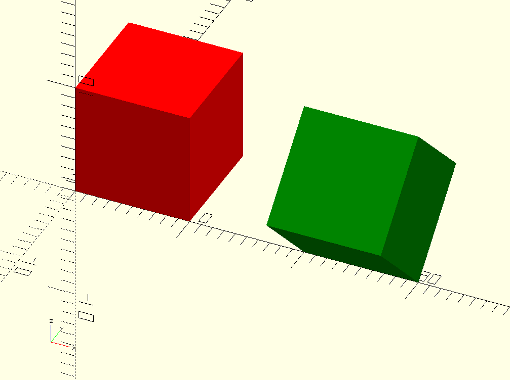

Global variables are definitely accessible in modules and functions.
cube_size = 10;
function the_cube_size() = cube_size;
module my_cube() {
echo(the_cube_size());
cube(cube_size);
color("red")
my_cube();
color("green")
translate([20, 0, 0])
rotate([45, 0, 0])
my_cube();
ECHO: 10
ECHO: 10
Are Functions different?
No.
Unfortunately what someone  made as three way Puzlecut do not work.
I guess I have to export File after first cut and Import it before next.
Undfortunately Export is not there for some obscure reason.
It is never necessary to export and object and re-import it into the same
script. That is the main reason export does not exist. The example above
shows the geometry created by my_cube() can be reused and it is cached, so
only computed once,

It marks the end of a statement, so it is critical where it should be. If
you look at
color("green")
rotate([45, 0, 0])
my_cube();
That is all one statement, so it needs one semicolon at the end. If you put
one say after color() you would get two statements.  The first would colour
nothing and the translate would start a new statement so you would get an
uncoloured cube that was just rotated and translated.
cube_size = 10;
module my_cube() {
cube(cube_size);
color("red")
my_cube();
color("green")
rotate([45, 0, 0])
my_cube();
ECHO: 10
ECHO: 10
you look at
color("green")
rotate([45, 0, 0])
my_cube();
put one say after color() you would get two statements.  The first would
colour nothing and the translate would start a new statement so you would
get an uncoloured cube that was just rotated and translated.
