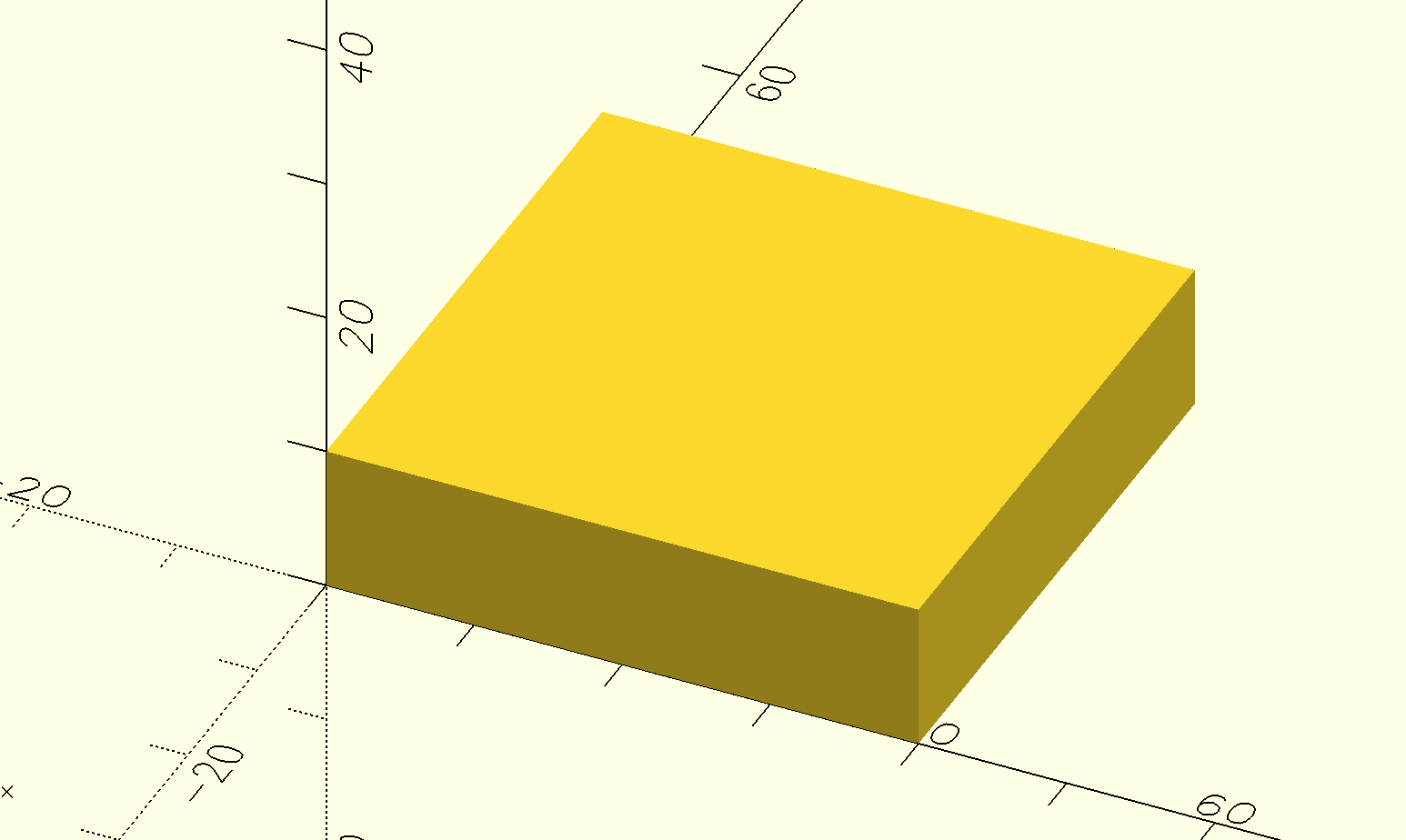

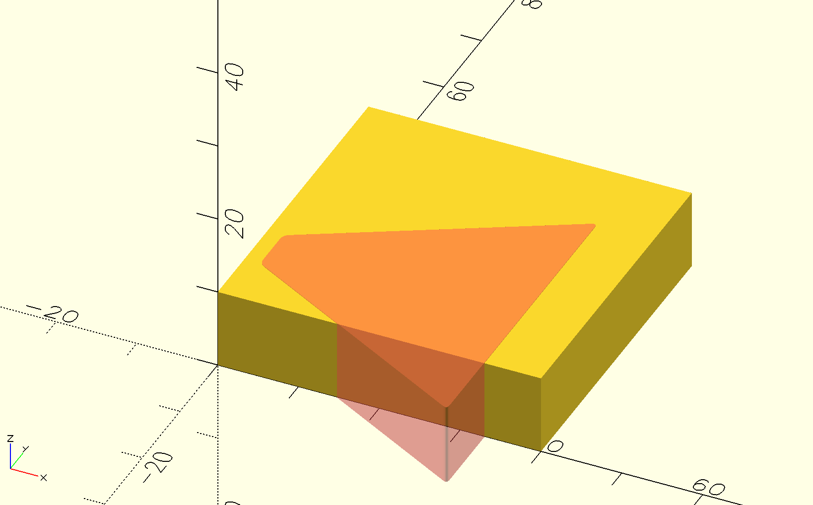

Hi all,
please consider the following simplified(!!!) example:
eps = 0.1;
eps2 = 2 * eps;
path = [
    [-1, -3],
    [30, -20],
    [30, 20],
    [-1, 3],
render() difference() {
    cube([40, 40, 10]);
    down(eps)
    right(2)
    back(10)
    #rounded_prism(
        bottom = path,
        height = 10 + eps2,
        joint_sides = 3,
        anchor = BOTTOM+LEFT
Why is the rounded_prism nit subtracted from the cube when rendering the model? I had to # the rounded_prism to see it at all.
After Preview (F5):
After Render (F6):

Mon, Jul 13, 2026 4:31 PM
Replacing the rounded_prism() call with
linear_extrude(height = 10 + eps2)
polygon( path );
...works correctly.
Interesting.
Replacing the rounded_prism() call with linear_extrude(height = 10 + eps2) polygon( path ); ...works correctly. Interesting.

I found it by myself. The path was in the wrong order. Seems I have a hard time to get my mind to clockwise paths for the bottom surface if seen from above. I did it the other way around for years and it's not easy to get rid of that mental model.
Works with this path:
path = [
    [-1, -3],
    [-1, 3],
    [30, 20],
    [30, -20],
