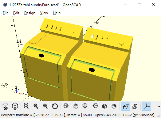

On these models of a washing machine and a drier, the control panel
(with the buttons and knobs) and the detergent door (on top of the
washer) are done this way.  Partly it makes it easier to think about the
layout, but also the basic box for the two is the same module; it's only
those two add-ons that are specific.
I don't remember why one of the controls on the drier is white.
I've used similar strategies for positioning handles on cabinets,
separating the design of the handle from the positioning (and
duplication!) on the cabinet.
