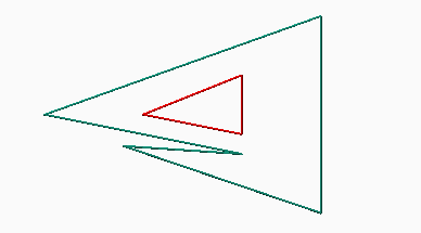

Step 3. my code follows David Eberly's algorithm very closely; when I saw
your code I asked myself why Eberly's algorithm is so much complex? I have
found the answer: the nearest point strategy fails because it cannot assure
that the bridges will not cross other edges like in:
[image: case1.PNG]
Even if a check is made to avoid possible crosses like this, there is a
subtle case hidden bellow the bridges.
[image: case2.PNG]

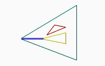

Suppose that the yellow hole has been processed and the blue bridge is in
place. Looking for the nearest point to the left extreme of the red hole,
we will find two polygon vertices with the same coordinates: the right
extremes of the (two-way) blue bridge. The choice between those two
incarnations of the same point is not arbitrary because one of them will
generate a polygonal which crosses itself at that point.
I shall revise my code of polyHoles and polyHolePartition considering that
last case because of some shortcuts I had introduced in the Eberly's
method. They may cause troubles.

Here is a test case for what I called "subtle case hidden bellow the
bridges".
out = [ [0,0], [-70,25],  [-70,-25] ];
hol0 = [ [-25,-5], [-50,0], [-50,10] ];
hol1 = [ [-28,0], [-40,5], [-35,8] ];
hol2 = [ [-30,-5], [-45,-10], [-45,-5]];
FSP  = [ [0,0], [-25,-5], [-30,-5], [-45,-10], [-45,-5], [-25,-5],
     [-50,0], [-50,10], [-25,-5] ,
     [0,0], [-28,0], [-40,5], [-35,8], [-28,0],
     [0,0], [-70,25],  [-70,-25],
FSP is one possible correct output for comparison. polyHoles fails with
this case and generates a polygon crossing itself.
If you use min x-values, rotate all polygons by 180 degrees.
