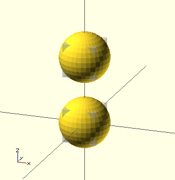

Why is the upper sphere not smaller?
$fn=32;
r=2;
o=1;
module sphereo(r=1){
sphere(r+o);
%cube(2*(r),true);
{sphereo(r);echo(o);}
translate([0,0,8])
assign(o=-o){sphereo(r);echo(o);}
The output is:
ECHO: 1
ECHO: -1
So the assign works for echo but not for the module call???

Variables use lexical scoping. If you don’t pass the o variable, or accept it in the sphereo module, it will lookup o from the scope in which the module is defined (global scope).

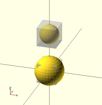

Now this works:
Still, this is confusing to me!
$fn=32;
r=2;
o=1;
module sphereo(r=1,o=0){
sphere(r+o);
%cube(2*(r),true);
{sphereo(r,o);echo(o);}
translate([0,0,8])
assign(o=-o){sphereo(r,0);echo(o);}

It’s probably confusing because you pass the value 0 (zero) instead of the variable o.

Unfortunately one can not assign values through to children.
Or, do you see a way to do that?

The only way to do it is with a $ variable as they have dynamic scope so
can be set in a parent and accessed in a child in same way as $fn works.

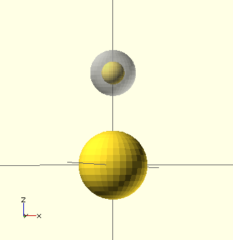

Thanks, nop. Now it works:
$fn=32;
r=2;
$o=1;
sphere(r+o);
// %cube(2*(r),true);
%sphere(r);
{sphereo(r,$o);echo($o);}
translate([0,0,8])
Kind(){sphereo(r,$o);echo($o);}
module Kind(){
assign($o=-$o)children();
Output:
ECHO: 1
ECHO: -1
