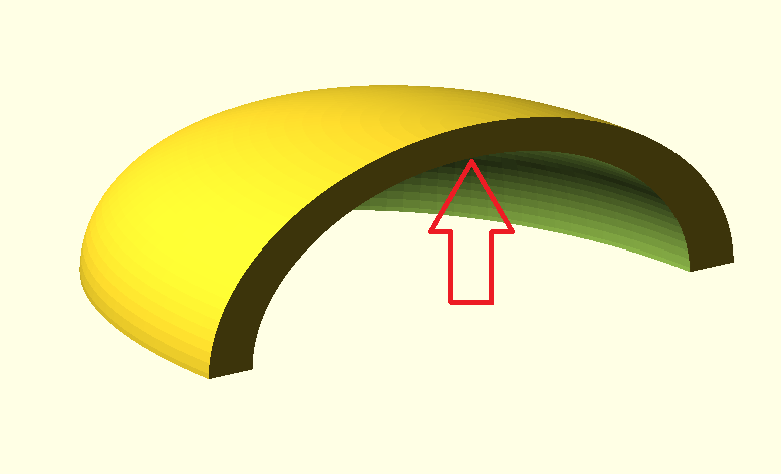

I designed a simple hand hold that I can screw onto a surface and then
slip my hand into to lift something up, a kind of a handle.
The indicated edge would do much better were it rounded.
Suggestions?

Re-learning some of the little I once knew, as will be obvious from my
question:
I see a 'flat egg' on running that code. What should I see?

There are two warnings that we aren’t seeing .
First: set “stop on first warning”.
Second: display the console or error log.
Third: fix the warning.
My guess is that the first warning is that BOSL2 is not found, and the second is that the “left” module is not found. If so, the solution is to install BOSL2.

Thanks Jordan. Here's the console from F5 I should have studied, which I
think confirms your diagnosis.
Think I'll take a few steps back on the re-learning curve ;-)
Saved backup file:
C:/Users/terry/Documents/OpenSCAD/backups/unsaved-backup-DVVpGVbD.scad
WARNING: Can't find include file 'BOSL2/std.scad'. in file ., line 1
WARNING: Ignoring unknown module 'left' in file ., line 18
Geometries in cache: 4
Geometry cache size in bytes: 2531296
CGAL Polyhedrons in cache: 1
CGAL cache size in bytes: 3600000
Normalized tree has 2 elements!
Compile and preview finished.
Total rendering time: 0:00:00.099

Yep, exactly what I theorized.  I strongly recommend "stop on first
warning".  All too often the first warning is the key to all of the
problems that follow, and having those later warnings displayed just
obscures the important one.  Also, in some cases, there can be a large
number of warnings and the result is that everything slows down a lot
handling the warnings.
