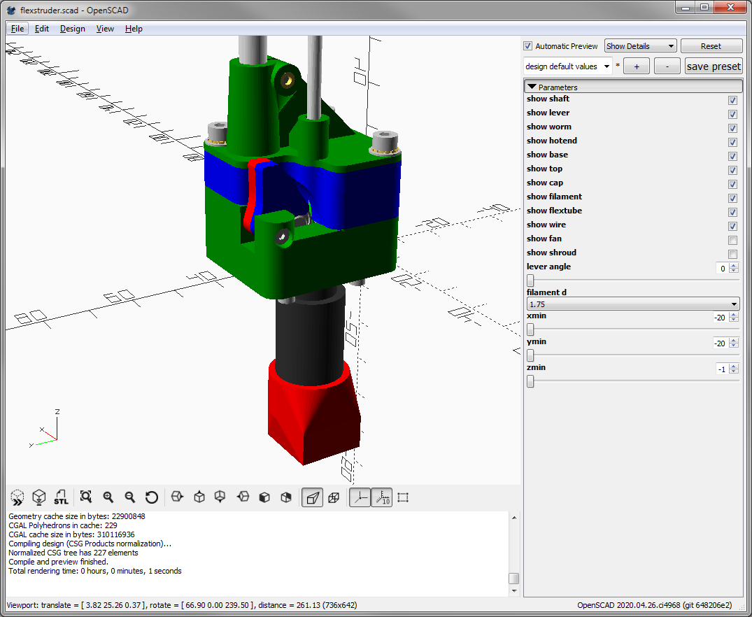

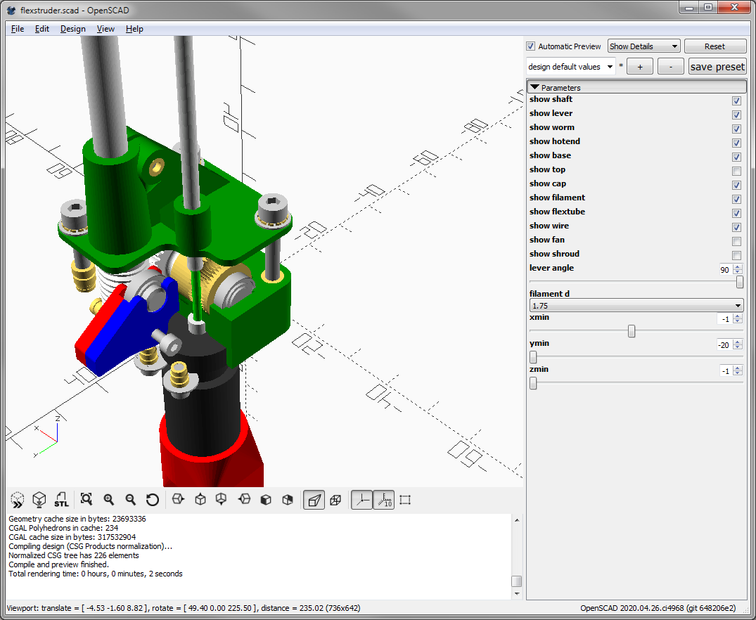

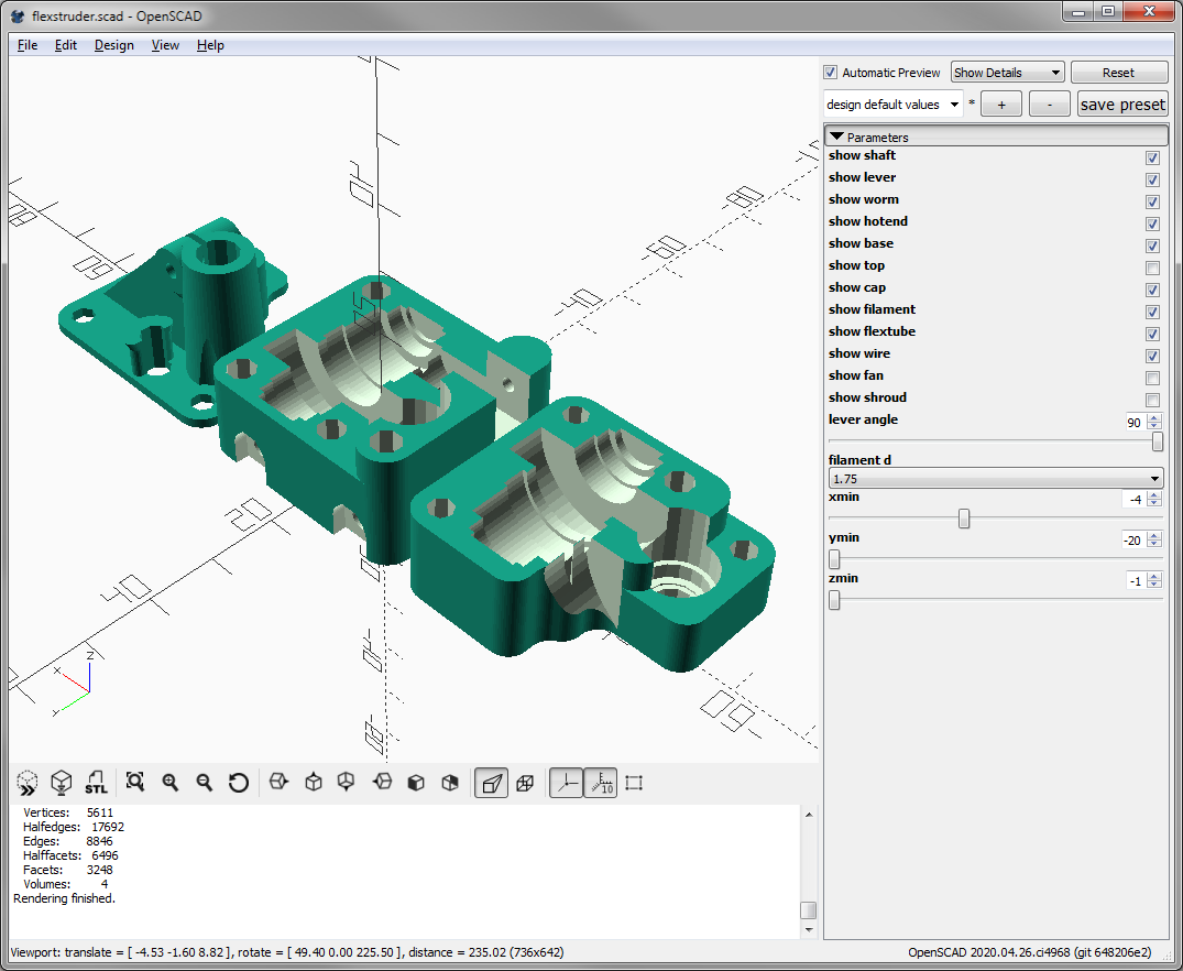

For the problem of selecting individual components out of a model, I
have had two approaches:
One was where I had an object that was built out of multiple individual
printed components.  I wanted to be able to display it either assembled
(for design) or pluck out an individual component (for printing).
I used these modules:
module ifpart(p) {
    if (is_undef($part) || $part == p) {
module ifpartonly(p) {
    if (!is_undef($part) && $part == p) {
module ifpartall() {
    if (is_undef($part)) {
Setting $part would let you select a particular component, and then
inside the model
ifpart("a") { ... part A ... }
Executes if part A is selected, or if everything is selected.
ifpartonly("a") { ... }
Executes if part A is explicitly selected.  (For instance, for
printing a component that occurs multiple times in the full model.)
ifpartall() { ... }
Executes if everything is selected.  (Complementary to ifpartonly(),
for the repetitions of a component that need to be displayed in the
full assembly.)
A related set was intended for managing multiple models in a single file:
module contents(d=100) {
    nx = ceil(sqrt($children));

I use the customiser to control which parts of my model to display, i.e. to
customise its pose, rather than its intended use: to vary model parameters.
I just test the variables it sets with if or use them to translate and
rotate.
In this case I also can cross section the parts with sliders to see inside.
And I use $preview to switch between the assembly view with F5 and the laid
out for printing view with F6
