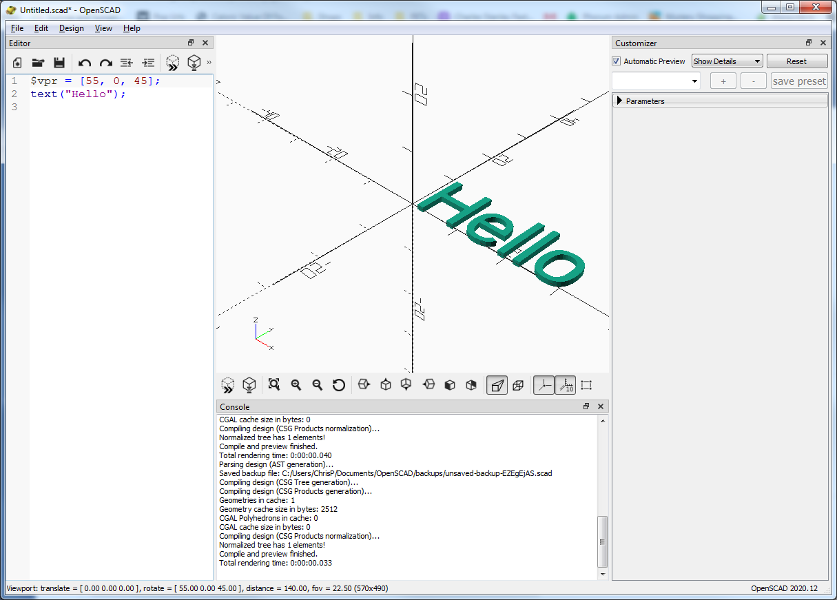

The "viewport rotation" special variable doesn't behave like I expect. I
expect the view to rotate around whichever axis is changed, therefore it
should stay still on my computer screen.
Take this code for example:
$vpr = [55, 0, 25];
text("Hello");
When I change the z-axis by 20 degrees, it does not move on my computer
screen.
But when I change the x- or y-axes by 20 degrees, they move substantially.
Is this a bug or am I not understanding something?

Not sure what you mean. If I change the z rotation to 45 and do F5 the text
does rotate substantially.

I have trouble visualizing it myself, but I think what you're seeing is
one of three things:
  • When you rotate in two axes, there's a related rotation in the third.
  • Like other OpenSCAD rotations, the Z rotation is done last.
  • View rotation is around the center of the window.  If the origin
    isn't at the center of the window, rotating around Z causes the Z
    axis to move too.
Try playing with one axis at a time, keeping the other two set to zero.
Set this animation going, then pan with your mouse and manually change
the numbers for the rotation of the two non-animated axes:
$vpr = [0,0, $t*360];
text("Hello");
(If you're not familiar with animation:  View/Animate to get the
controls to appear, then put (say) 10 in the FPS box and 90 in the Steps
box.)
Of course, you can move the $t*360 to whichever axis you like.
You might also set
$vpt=[0,0,0];
to force the origin to the center.
Caution:  animated rotation of more than one axis a can make you dizzy!

Tue, Dec 8, 2020 9:20 PM
Another note:
Again, I have some trouble visualizing what's really going on and why,
but note that OpenSCAD's viewer normally constrains rotation.  I'm not
quite sure what the constraint is or what it deeply means, but as long
as you're centered on the origin ($vpt=[0,0,0]; look at the bottom of
the window) you can't get the Z axis to appear off vertical.  (It can
tilt towards you or away from you, but never left or right.)
Another way to look at it is that if you're looking at a model of a
globe (ignoring axial tilt), you can't get the north pole to be on the
left or right side.
Probably strongly related is that the ordinary mouse controls never
change the Y axis rotation - it's always zero.  (Watch the rotation
numbers at the bottom of the screen.)
I suspect that the X and Z axis rotations map to altitude and azimuth,
or in spherical coordinates theta θ and phi φ.
When you set $vpr, you can set the Y rotation and so you can move the Z
axis off vertical.  For instance, [0,90,0] has the north pole pointed left.
(And forcing the Y rotation non-zero using $vpr then yields strange
effects in the mouse-based rotation.)
