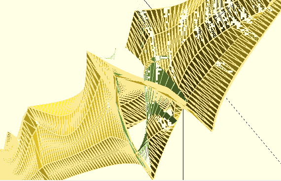

So I'm wondering if my general approach to a problem is bad.
To simplify I'm trying to make an arched structure where the arches change
form.
The first shape I'm trying to make is to have the archway itself form an
ogee arch (you can roughly think of it as wishbone shaped thing).
So what I did was to do this:
hollowHalf()
mirror([1,0,0]) {
solidHalf()
mirror([1,0,0]) {
hollowHalf()
Either that approach is invalid, or there is some other problem going on.
The thing that puzzles me is I'd think it would work from a geometric point
of view (I know the interior walls would be wrong but the exterior I would
think should be fine)
If in OpenScad I just render the hollowHalf() and then click
It looks like the last archway is centered versus the y and z axies to me
(+z is coming straight at the viewer, +y is going up, +x is to the right).
That suggests to me that after they were joined they should overlap with no
gap
alternately I was thinking two differences might give both a correct
interior and exterior view
hollowHalf();
mirror([1,0,0]) {
solidHalf();
mirror([1,0,0]) {
hollowHalf();
solidHalf()
is the logic wrong?

What is hollowHalf & solidHalf?
As a general rule your should try to check what each component looks like
before doing bigger pictures, so use the '!' modifier* in the above, first
on 'hollowHalf()', then on 'mirror()[1,0,0]) solidHalf()' the on
'mirror([1,0,0]) hollowHalf()'. Then remove '!' and use '#' on
'mirror()[1,0,0]) solidHalf()'.
I can't see how mirror() can work here? Mirror will put the object in an
opposite plane which will not overlap so there is nothing to difference().
Try:
// ball - sphere in the positive quadrant
module ball(s=10, c="black") color(c) translate([s,s,s]) sphere(s, $fn=s*3);
ball(10,"blue");
mirror([1,0,0]) ball(10,"red");
Isn't the solid=false, 'wishbone' already hollow?
I'm not seeing what type of structure you want.
My end goal is to make six passageways that interconnect with arches2().
Is that 6 passages each of which is an arches2()? [perhaps with different
inputs?]
How are they arranged?
Perhaps there is a picture on google resembling what you want?
form.
So the best approach is to form a sequence of (morphing) polygons that
neither self intersect nor mutually intersect, skin this sequence and test
it by unioning a cube. This is what you seem to do, but only half way down.
As long as you do not skin a cross section with holes, it is straight
forward to generate polygons describing the full crossection. To exploit
symmetries, better reuse/modify a precalculated point sequence respectively
by means of list comprehension in order to compose full shaped polygons. I
think in your case this is feasible and preferable.
While the use of Boolean ops after skinning is allowed - despite being quite
slow-, you must take care to
  1. produce proper manifolds as operands - which you don't seem to check
    properly (see other thread).
  2. avoid operands using the same (or very close) points or partial identity.
    OpenSCAD can have representation problems with very close vertices.
Another hint: Try to break down complexity. Do proper testing of each
component - especially when you use polyhedron (which is called during
skin), because OpenSCADs F5 and F6 don't give semantically equivalent
output. F5 displays anything even non-valid manifolds. F12 can indicate
orientation problems, but not each and everything.
