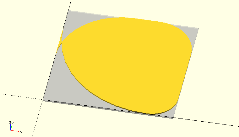

I think my issue occur when radius for p2 dont fit between p1 -p3.
Maybe that should be left to be expected
or limited so the arc never can go outside the three points?
The issue is not restricted to that extreme cases. It is enough to have
tangent points in an edge in reversed order.
module test2(size,r) {
p = [ [0,0], [size,0],[size,size],[0,size] ];
polygon( polyRound(p,r,10));
translate([0,0,-1])%polygon(p);
test2(100,[80,20,30,50]);
If polyRound is recoded to identify those cases, either ​it should do
nothing or reduce some radiuses. Unhapilly, the radius reduction problem
has usually many solutions.

TLC123
Thu, Jul 27, 2017 4:15 AM
I made some experiments in a fork on github. Don't know if I posted it
correctly, very unused to github.
First version dealt with the collinear case and radius zero case.
Next i clamped tangD value to be inside either leg of the triangle.
Now I'm working on reducing radius
if tangD +tangD of previous point is larger than the length of the leg or
tangD +tangD of following points is larger than the length of the following
leg.
Then
Mutiply radius by the proportional amount of that  oversize.
And repeat for all points.
If no changes occured done else retry recursive with new set of radii.
Currently working but a bit to eagerly with reducing radius. I think I know
what part of logic that needs change and I will deal with it as soon as
possible

irevdev
Tue, Aug 1, 2017 12:41 PM
I've got a pretty big update to the polyRound() code, some general tidying,
improvements and new features, mostly notably radii conflict handling.  link
here again, if you don't want to scroll up
https://github.com/Irev-Dev/Round-Anything
First a big thank you to TLC123 who's made a substantial contribution.
So the interface of the function has changed, instead of taking two separate
lists for points and radii, it takes one list where each point takes the
format [x,y,r]. TLC suggested it and it seems more intuitive to me.
http://forum.openscad.org/file/n21983/example1.png
The radii conflict handling works by reducing two conflicting radii by a
factor, this means that the two will keep there ratios, for example if two
conflicting radii of 30 and 30 would be reduced to 10 and 10, but
conflicting radii of 10 and 40 might be reduced to 4 and 16, ie 30/30=10/10
and 10/40=4/16. There is no way to explain how it does this with out drawing
something, so here are some pictures.
http://forum.openscad.org/file/n21983/formulas.png
Not sure how well that image will turn out, here is a link for it
https://github.com/Irev-Dev/Round-Anything/blob/master/images/formulas.png
It's not the perfect solution but I'm happy with it for now as it seems
pretty robust and isn't too complicated.
For those who don't want radii conflict handling polycarious() has no
protection built in. So as it stands the radii conflict handling is not an
option within the same function? should I make it enable/disable-able within
one function?
One problem with the radii conflict handling is if you were to have 3
consecutive radii, where the 1st and 2nd radii conflict a lot and the 2nd
and 3rd conflict but less so, what will happen is that the 2nd radii will
reduce enough for the worst case which is the 1st and 2nd radii conflict.
The problem here is that with the second radius reducing, once it has been
reduced it may no longer conflict with the 3rd radius, and therefore the 3rd
radius it may not need to be reduced, but the code doesn't check for this
and so the 3rd radius will be reduced as if the original conflicting 2nd
radius were still there.
Trying to fix this would be difficult because how would it be handled? would
you go through the array in order giving the first point priority? or do you
write logic so that it reduces the radii at the worst conflict and then the
2nd worst, 3rd etc?
I think it's fine as it is because I think the radii reduction should not be
relied on in the first place, I did included a debugging option that will
tell you if any of the radii have been reduced because of a conflict. see
some of the examples.
