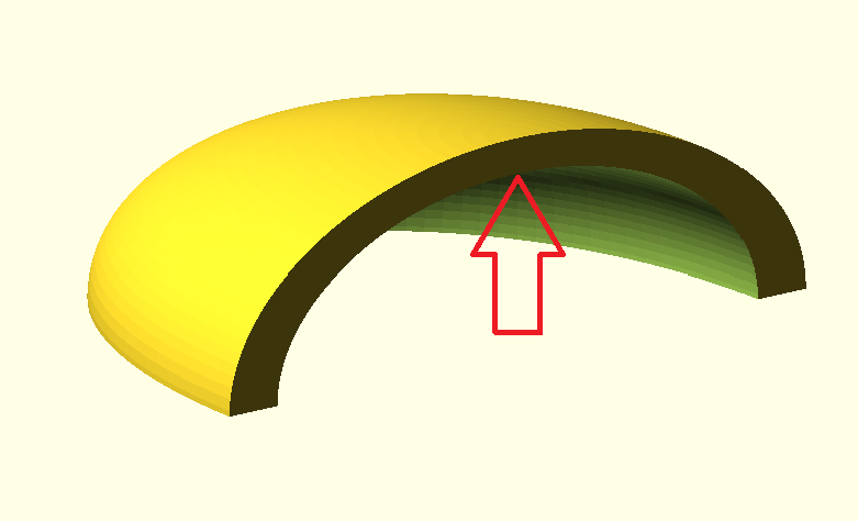

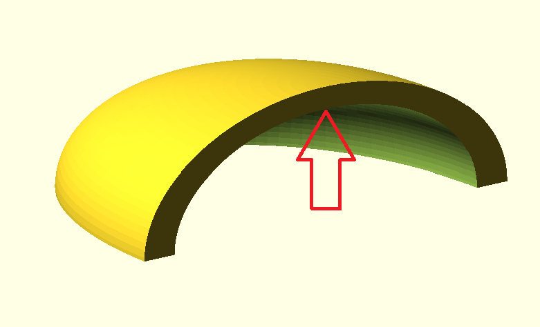

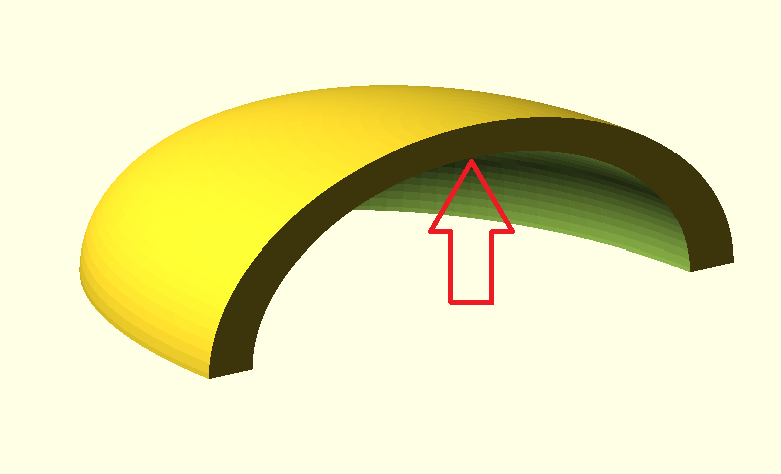

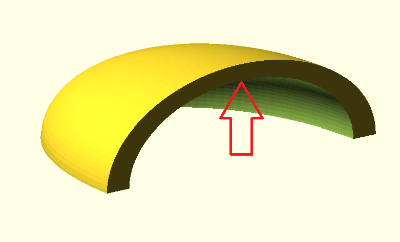

I designed a simple hand hold that I can screw onto a surface and then
slip my hand into to lift something up, a kind of a handle.
The indicated edge would do much better were it rounded.
Suggestions?

https://github.com/BelfrySCAD/BOSL2/wiki/masks.scad#module-rounding_cylinder_mask
Use rounding_cylinder_mask() on the outer edge, use rounding_hole_mask()
for the inner edge.

Wed, Apr 22, 2026 12:56 PM
Perfect!  Thank you!

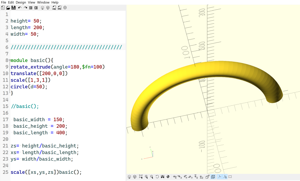

if the concept was to fix something using bosl2, then I cannot help, but if the idea was to create a simple, comfortable, resizeable handle, using openscad, then the following is useable. Obviously play with the paramaters, d, translate, scale, etc, to get to what suits you, or not...
