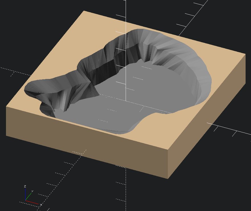

The goal is to make a single object from two strange shapes.
Imagine the bottom object being a strange abnormal shape like an odd shaped
pond from a bird's eye point of view.
Now imagine the top object in the same manner but having a completely
different shape.
Keep each of them centered on the X and Y axis and separated on the Z axis.
A single object can be created by wrapping these two top and bottom objects
within hull().
Works fine ... except the shape of the top and bottom of the final object
is not the same as the original objects because hull() uses straight line
perimeters on the original shapes.
What am I missing?
When the final object is "hulled" I would like the top and bottom to match
closely the shapes of the original top and bottom objects.
Should I somehow place the same number of points around each object's
perimeter and use them to hull() both objects?  If so ... how?
Or is there a simpler method?

Hull is short for "convex hull".  If you start with concave objects they
will be wrapped to become convex.  Maybe not what you want?  If you're
trying to connect two arbitrary objects into a 3d shape that's a difficult
problem that may not have an easy solution, depending on your shapes.
There may be several solutions, all perhaps equally valid.
You might take a look at skin() from BOSL2.
https://github.com/revarbat/BOSL2/wiki/skin.scad#functionmodule-skin

thank you, Adrian Mariano, skin() in BOSL2 was just what I needed: I was
making a funnel to pour into a non-convex opening, and skin() gave me a
much nicer blend than hull()

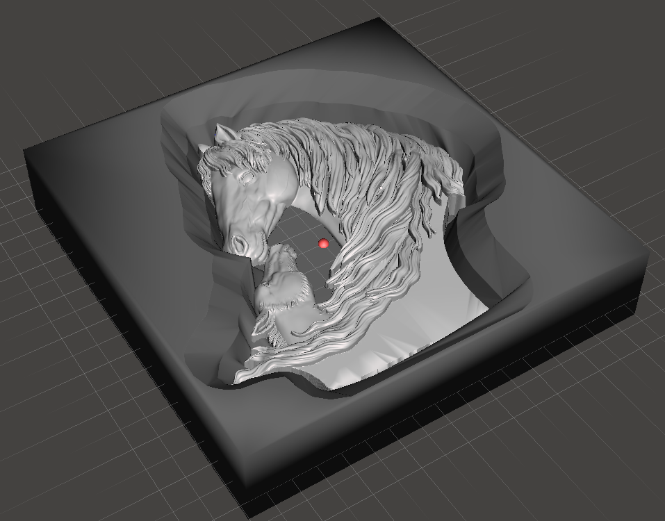

I worked with all the suggestions and decided that skin() was the best
choice.
Attached is an example scad, a pic of its rendering, and another pic via
meshMixer of how the rendered material will be used in a final product.
I can use this for many upcoming carving projects.
Thank you all!
