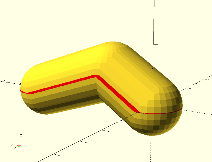

Is this what you want to do?
http://forum.openscad.org/file/n13723/PartingLine.png
And you want to do this automatically?
Note: there is not always a solution to your problem.

Is this what you want to do? <http://forum.openscad.org/file/n13723/PartingLine.png> And you want to do this automatically? Note: there is not always a solution to your problem. ---- Code ____ r1=30; r2=20; x1=90; z1=30; rc=10; rp=2; module sphere1(r1=r1){ sphere(r1); color("red") rotate_extrude()translate([r1,0,0])circle(rp); } sphere1(); translate([x1,0,z1])sphere1(); hull(){ sphere(rc); translate([x1,0,z1])sphere(rc); } color("red"){ hull(){ translate([0,-rc,0])sphere(rp); translate([x1,0,z1])translate([0,-rc,0])sphere(rp); } hull(){ translate([0,+rc,0])sphere(rp); translate([x1,0,z1])translate([0,+rc,0])sphere(rp); } } -- View this message in context: http://forum.openscad.org/Parting-Line-tp13715p13723.html Sent from the OpenSCAD mailing list archive at Nabble.com.

That is similar to what I want but that is not it.  How would you generate a
parting line for this?

When you set
r1=10;
r2=10;
in my code your getting pretty close.
But do you want to do this automatically for arbitrary .stl's, or do you
want to do it with simple shapes, as in the example.
And one more thing to consider: what do you want to do with this "parting
line".
In my example it is a 3d shape.
My geues you want it to cut your molde in two (or more) parts.

Here is a quick and dirty way to do it with arbitrarry shapes.
(This cound be impruved by using the 2d commands for growing and shrinking
2d-shapes)
eps=0.999;
module shape(){
hull() {
sphere(10);
translate([15,0,10]) sphere(10);
hull() {
translate([45,0,0]) sphere(10);
module proj(){projection()shape();}
scale([2-eps,2-eps,1])color("red")
intersection(){
translate([0,0,-50])linear_extrude(convexity=6)
proj();
scale([eps,eps])proj();
shape();
shape();

That is getting closer.  I just need the red part to be a line (no dimension
in the z axis) and then extrude that into a surface along the xy directions,
then extrude a solid in the z direction and subtract the object from the
solid.  The other half of the mold is created from extruding in the -z
direction.  It needs to be a line because there can't be any gaps between
the z and -z parts.

Yes, I was afraid that that is what you needed.

You can change the radius of the middle sphere to a different number from
the start and end spheres to be more representative.  (see below)
The object I ultimately want to mold is from an .stl file not simple
geometric shapes.  If you created a cube around the .stl, subtract the .stl
from the cube, and then split the cube in two along the parting line that
would be my solution.
