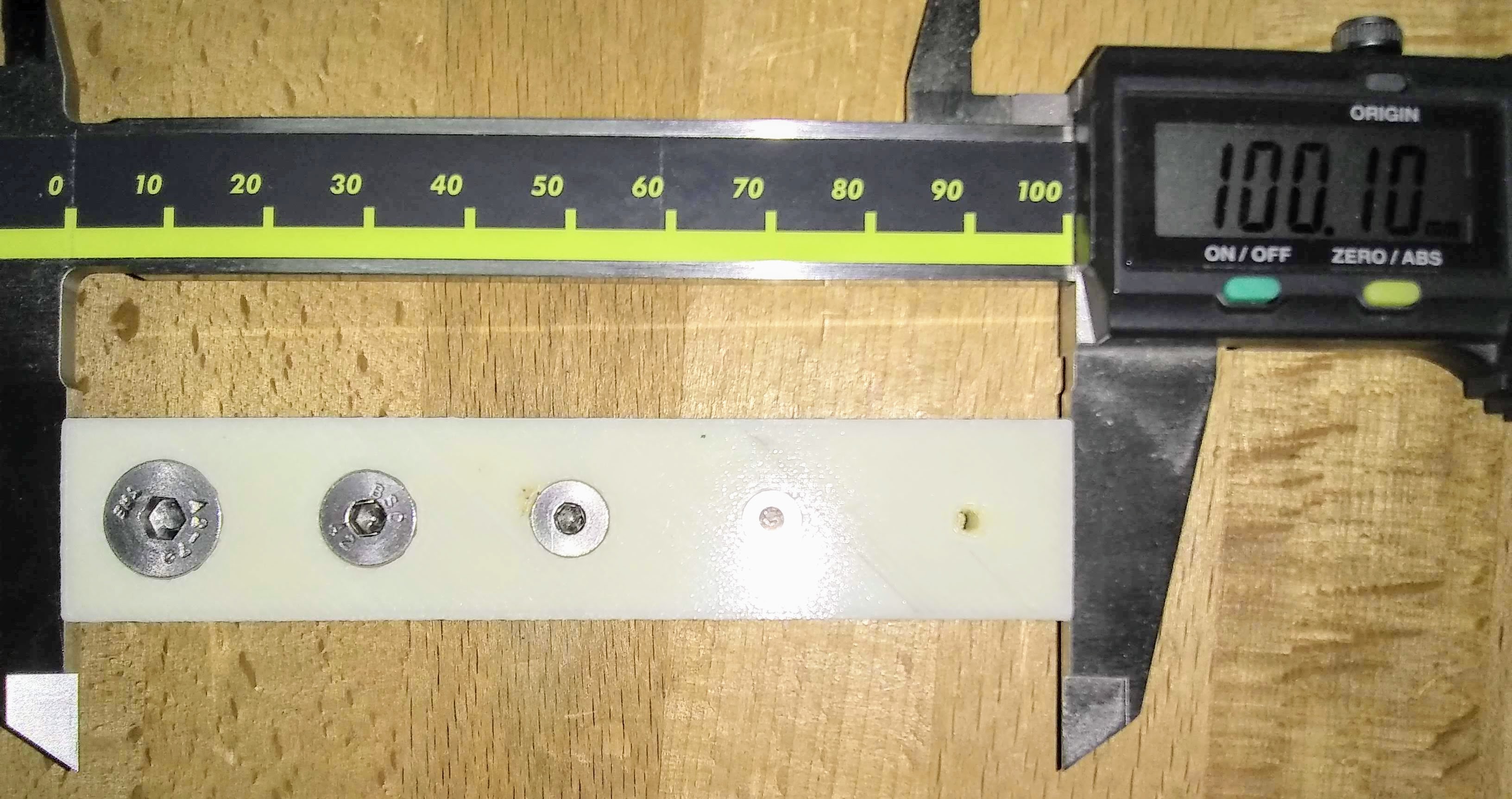

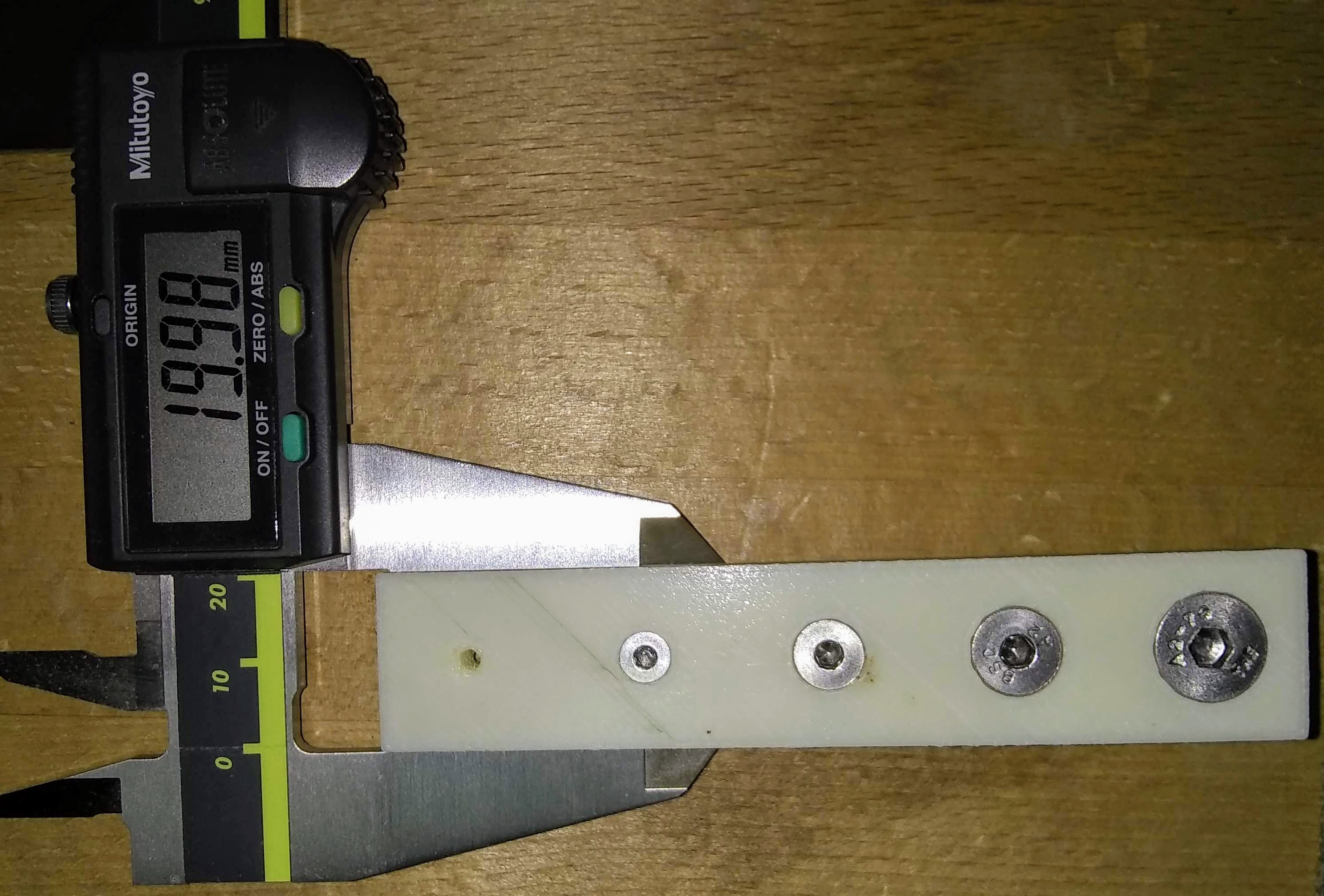

Tue, May 9, 2023 3:45 PM
I calibrate for XY scale by printing a large L shape and measuring the
inside dimension. That is independent of flow rate and backlash, so is
purely contraction and XY motion.
Then if flowrate is calibrated and backlash is negligible then dimensions
are close to spot on.
[image: IMG_20210323_212659826.jpg]
[image: IMG_20210323_212544674.jpg]

Wed, May 10, 2023 2:44 AM
Those took pretty good, and closer than what I got on the last nut make,
looking thru a strong glass, with the load face of the thread meeting on
an end tooth, the same place 15 teeth down the stick looks like at least
.15mm clearance, so I'm about 35 minutes from done of a remake at
100.135 comp instead of the 100.145 quoted earlier. If the printer is
repeatable, and it has been so far since switching to klipper, it s/b a
better fit.
At some point I'll have to declare its good enough for the girls I've
gone with and place the for sale adv.
